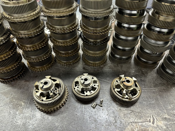

We have seen many internal failures of these VANOS adjusters, usually in the form of broken internal rotors or binding caused by scoring. For DIY’ers and most workshops, it is not possible to know the internal status of each VANOS adjuster, so BMW’s prognosis during processing the ISTA-D ABL is to simply “Replace the adjustment unit”, at significant cost. Historically, the only reduced cost solution has been blindly purchasing replacement used units from parts engines which is full of risk and far from ideal given the significant labor costs to remove and replace an adjuster. Sometimes, bad luck strikes and the replacement unit is also discovered to be defective after testing the reassembled system!
Failures:

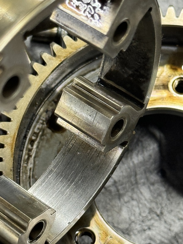

A common failure resulting in rattles and malfunction faults are broken internal rotors pictured below. Often times, especially after a bearing failure, metal swarf if captured between rotating parts and scores, stiffens, or locks-up the adjuster. These failures are completely undetectable externally.

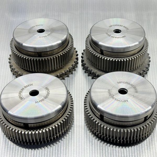

We offer these individually or as a whole set including our VANOS CUP set for a top-of-the-line solution.
https://mporiumbmw.com/product/bmw-s...emanufactured/

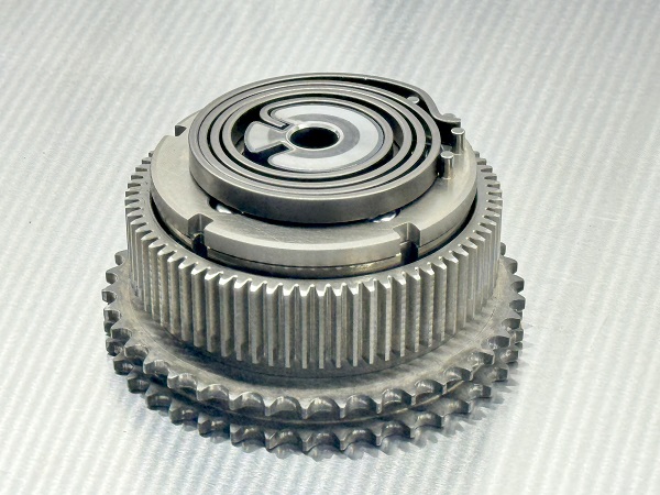

An exhaust adjuster, opened to show internals:

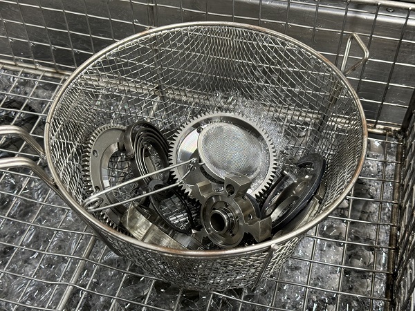

Cleaning is performed in a heated ultrasonic machine:

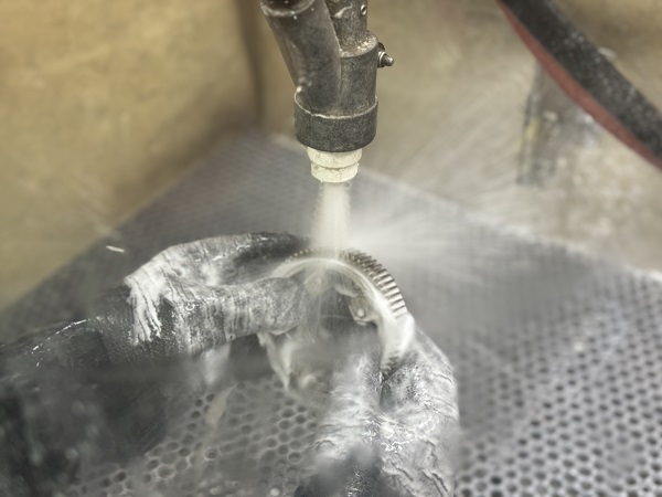

Surface finishes are restored as needed in our Vapor Honing machine:
A restored adjuster is ready for shipment:
