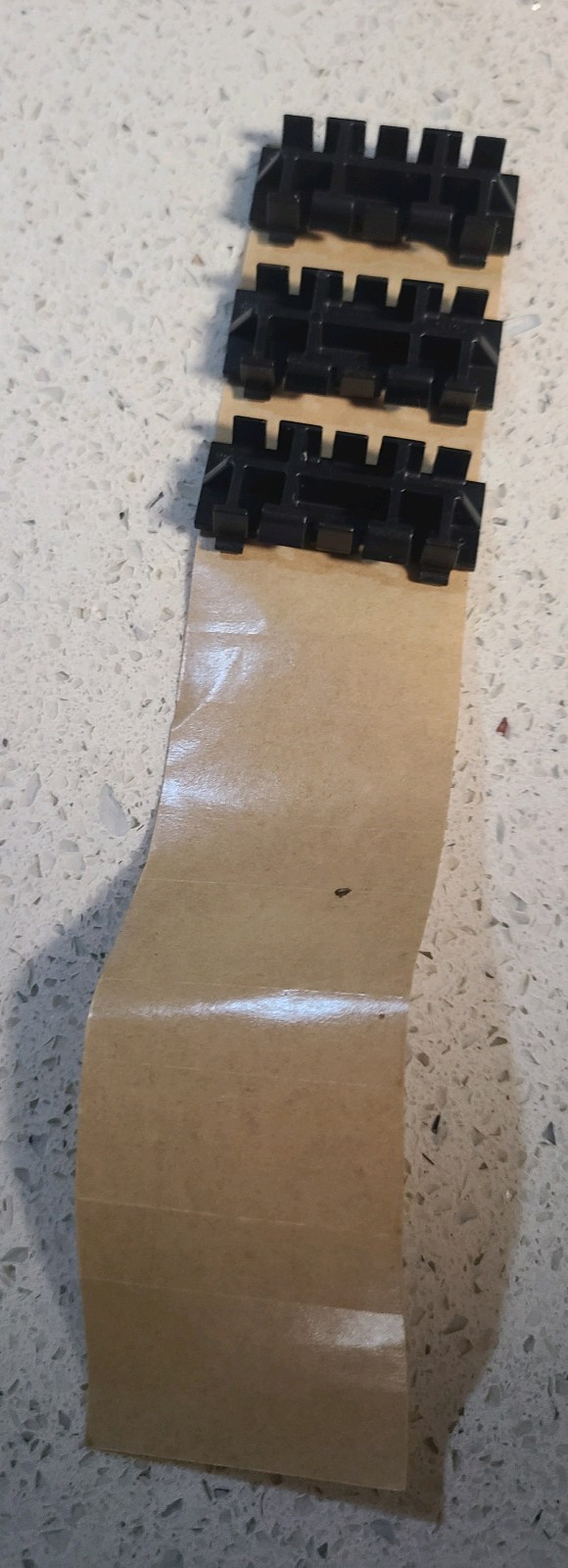

q. Roof rail replacement clips. You know BMW plastics are brittle and (just like I did), you may end up breaking a few of them. Note: BMW has a ton of different plastic clips. The correct part number is:51138045321. They come in a strip of seven pieces and have adhesive backing. About $25 for the strip of 7.

Before starting the process, remove the roof side rails using the plastic trim tool. Be careful. You will more than likely break a few clips. Start at the rear end of the rails and work your way towards the front with the tool. Make note of missing or broken clips to be replaced later.

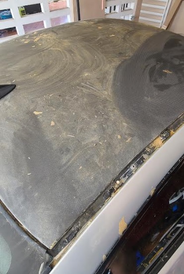

Your roof may look something like mine in the 1st pic below after all the scraping.
It is now time for sanding and cleaning off the old resin residue. In my case, I did a thorough wipedown of the surface with acetone on a microfiber towel. This got rid of some of the stained spots and made it look pretty uniform. After this I took 220 grit sandpaper to the roof and started scuffing (without too much pressure that it would damage the fibers). I also followed the advice of another thread and after dry sanding a bit did wetsanding . This allowed me to see the color of the residue. If your residue is black you’re scraping away carbon so be aware of that. Try to level it as best as possible without going too deep in the fibers -you do NOT want that. But rather so that the surface appears mostly level. Once done, repeat the wipedown with acetone. You can also use water with just a drop of dish soap for added lubrication during wetsanding.After cleanup the roof looks like the 2nd pic.
Note: At one point during this step, I had several “runs” of milky liquid (which I’m assuming is old clear mixed with resin) that dripped across the roof and made it look stained. This was easily removed with the later acetone wipe. It concerned me a bit but yeah it was gone after the wipe.

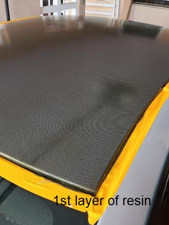

Ok, on to the main point of this. Full disclosure: Initially my plan was to just slather top with clear coat and layer it up. But after reading up some more and seeing the condition of the CF, I decided against doing just clearcoat, but rather do resin and clearcoat. For lack of a better term, the CF was “dry” and spraying it with clear over clear over clear would just allow the CF to suck up the clearcoat and never really settle nicely. I had read other posts where people had indicated that a couple of months after blasting it with clear they had to redo it. So instead, on with the resin to build up that top layer and then later we can clear it.

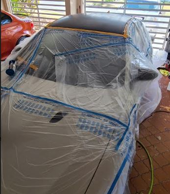

Use 1.5 inch masking tape to mask around the roof, making sure you allow yourself room to coat the side of the roof as they go into the roof rail channel. Try your best to cover the channels on top of the windshield and back glass. You may even choose to completely mask the rest of the car using plastic sheeting. It is up to you. However, in my case, I did the full car masking just before clearcoat. Also make sure you mask off the antenna piece as well.
As mentioned before, FOLLOW THE INSTRUCTIONS for mixing your particular brand of resin with the appropriate ratios. Make sure you have your gloves, glasses and all other PPE on for safety. Based on the resin testing done before, mix it up thoroughly for a good 2 or 3 minutes. Add your tint and mix some more until the color becomes uniform. Now, you’ll see bubbles in the mix. You do not want those bubbles in there when applying. There are several methods to get rid of the bubbles and most of them involve heat. The method I went with was having a bowl full of hot (but not boiling!) water larger than my mixing vessel. After mixing, place the mixing up inside the larger bowl (again, carefully due to the hot water) and wait a minute or two. You will see all the bubbles from the different parts of the cup move towards the center of the mixing cup and just congregate there, leaving the rest of the cup with no bubbles. You’re good now!
Start a timer so that you are aware how much working time you have available before the resin starts to gel up. Keeping in mind the working time you have for your resin, grab a brush and your mixing cup and pour a bit of the mix on top of the center of the roof. Do not pour a lot because it will run all over the roof and make it more difficult to manage. Just work in small sections (maybe 1/8 of the roof at a time). Once poured, start brushing a nice thin layer of resin. Continue doing this throughout the whole roof until done. Be as smooth as possible with the brush, as this will minimize your sanding efforts later on.
That’s it. Your first resin layer is done. You should have something that looks like the pic below. Now go on and do something else for the next 4 hours or so. Once the four hours are done, come back and do a second layer on top following the exact same process.

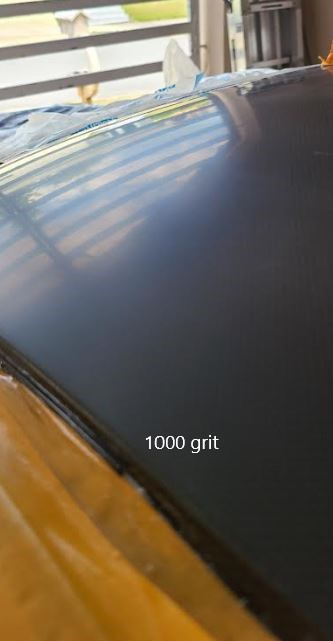

This is where you will sand off the excess from your resin layers in an attempt to make it as smooth and flat as possible. In my case, I made a mistake where I let a bit of epoxy that had just started to gel get on the roof. And this made a bit of a gooey mess. I was able to somewhat level that section (about 2 inches by 8 inches right in the middle of the roof). Once the resin dried, though, you could see the wavy lump of excess resin in the middle. Hopefully this doesn’t happen to you, but if it does, you just have to take your time, sand it and level it out.
For this stage I started dry sanding with 220 grits with light pressure to take off the easy stuff. After that I went progressively lighter in grit (320, 400, 600, 800) using tons of water for wet sanding. The importance of doing mostly wet sanding here, is so that you can tell by the color of the liquid being sanded off that you are not back to the level of the CF itself. The resin while being removed should look grayish (because of the tint) or milky. Easy and steady does it.
After each grit, use a damp microfiber towel to wipe off the residue and the compressor to dry out the area and check your work. You should be seeing the CF pattern with no obvious high spots (too much resin and it will look like a lump) or low spots (not enough resin and it will look like exposed CF weave). In my case I had to do a ton of sanding on that center section to get rid of the excess but I was hesitant towards the end and didn’t flatten it 100%. Once you’re up to 800, clean everything, dry everything up.
At this point you want to use your panel prep or alcohol mix and give the roof a good cleaning, ensuring there are no major marks, streaks and such. This is to get ready to apply clearcoat. In the end, your roof should look as in the pic below.
If you haven’t done so already, go ahead and fully mask the rest of the car using plastic sheeting. If you’re doing this in your garage, make sure you park your other cars outside and don’t leave anything around which can get overspray on it.

In my case, I had quite a bit of texture so I had to start with 800 grit as my first sanding step. Hopefully, yours won’t be that bad and you can get away with using 1000. Regardless, use your pump sprayer or spray bottle and spray a good amount of water on a section of the roof (I recommend one of the corners…maybe a 2 ft x 2 ft spot) which you will use as your test spot for your process. Go ahead and wetland with 1000 grit (DA polisher works great here; this is what I used) doing even passes. You should be able to see the light white milky froth of clearcoat being sanded away. Stop periodically, wipe the area with a microfiber towel and dry with the compressor to gauge your progress. You should start seeing a smooth, although dull and not shiny surface. If you see some fisheyes/pockets in the finish, my recommendation is to sand that spot carefully and specifically with a small piece of sandpaper and not the whole block or disc. At least to minimize its appearance.
Continue the process, this time with 2000 grit. Take the same considerations as before regarding inspecting often. Then continue the process with 3000 grit.

• Buy the clips. It’s not a matter of “IF” you’ll break some roof clips but rather “how many” will you break. As with many other BMW plastics, these things become brittle and almost impossible to remove without breaking.

Adding some answers to questions as I get them:
1. "Did you have to access the antenna sharkfin cover from inside the headliner to remove?"
No. The cover is just sticky taped to the roof. Use a trim tool to carefully pry it off by going underneath and around the bottom side of the cover and it pops right out.
You're then left with the "exposed" antenna which I just covered in masking tape before proceeding. No need to go into the headliner to do anything.
2. What's the part number for the roof clips?
Reading through other posts I saw people were having issues getting the correct roof clips for the roof rail/trim. I think it has to do with the facr that there are different clips for the regular steel roof vs the carbon roof. In any case the correct part number is 51138045321. They come in a strip of 7 clips for around $25-30. I've added a pic of what they look like (what remained of the 7 after I used a few, anyway) . Also, these have double sided tape on the bottom to stick to the roof. When I applied mine they didn't stick well so perhaps using a bit of heat or additional pressure will help. In my case I just put a small dab of black silicone on the bottom and pressed in place. Seems to have done the job. 👍
(to be continued)

Originally Posted by GiorgioE82 View Post
Questions?
After peeling off the old resin and cleaning with acetone I was left with yellow stains (in between the weaves). Do I have to keep sanding until those are gone? Since they are in between the weaves these stains are lower and sanding down until I get to them would have to remove and potentially damage the weave itself?
How would you go about approaching this?

Excellent DIY!
You don't need to wear a respirator when mixing epoxy unlike polyester resin which contains styrene. You don't want to mix epoxy in large batches because it will exotherm - the bigger the batch the quicker it will exotherm. When epoxy exotherms it does give off toxic gasses.
The pic with the yellowish epoxy looks like it exothermed.
Epoxy comes in different viscosities. I'd think you want something thicker. Infusion epoxy will have the lowest viscosity, then laminiating epoxy and then pouring epoxy. Pouring epoxy is used for river tables and stuff like that.
You're much better off using a vacuum chamber to degas the epoxy. They are $100 on ebay plus $40 for a cheap vacuum pump from Harbor Freight. A torch also works but it reduces your working time and viscosity as will applying heat.
I'm not an expert on this part but I think you only need to sand down to 400 or 320 grit when prepping for clear. Clear coats do not chemically bond with epoxy (which is why you are needing this DIY in the first place) so you want the surface a little rougher to achieve a better mechanical bond.
