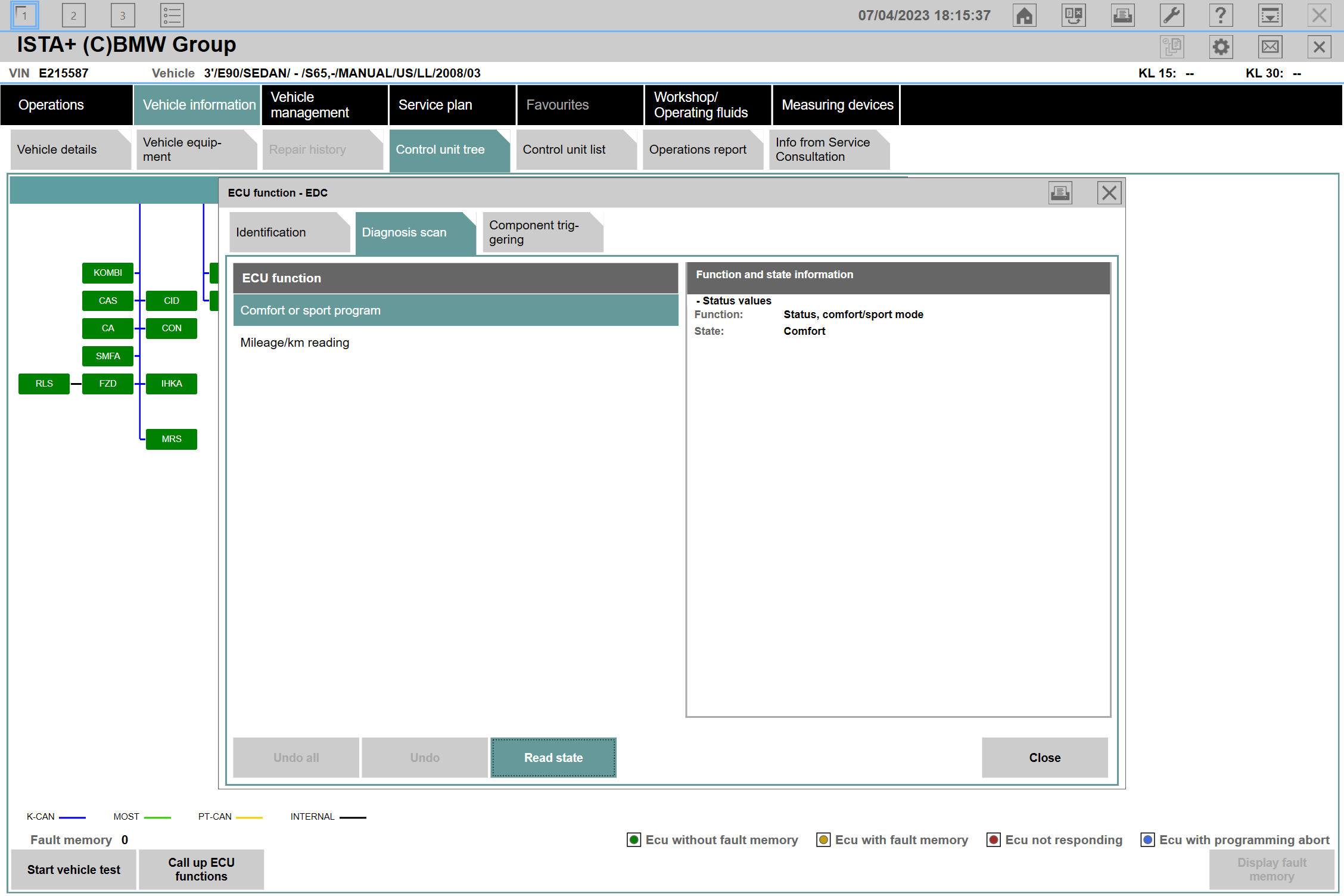

EDC test in ISTA Comfort/Sport?
Hi. Wanted to see if anyone else is seeing the same results with testing the EDC in ISTA. There is a EDC module test where you can confirm the status setting of the EDC when you push between Comfort-Normal-Sport.
What I wanted to confirm is:
1) When I have the EDC on Comfort (no lights on the EDC button), --> ISTA says Comfort
2) When I push it to one light on the EDC Button, which should be Normal --> ISTA says Sport
3) Then when I set the EDC Button to Sport, which is 2 lights --> the ISTA test says Comfort
??? I also ran a similar test in the Foxwell scanner and same phenomena happens. I'm a '08 non-ZCP M3.
Attachment 3155608
Btw quick feedback on this since I got Bimmergeeks Protool: shows the same thing, e.g. "Normal" doesnt show. So clearly not Protool thing then but the way the signal is being picked up by the tool.
