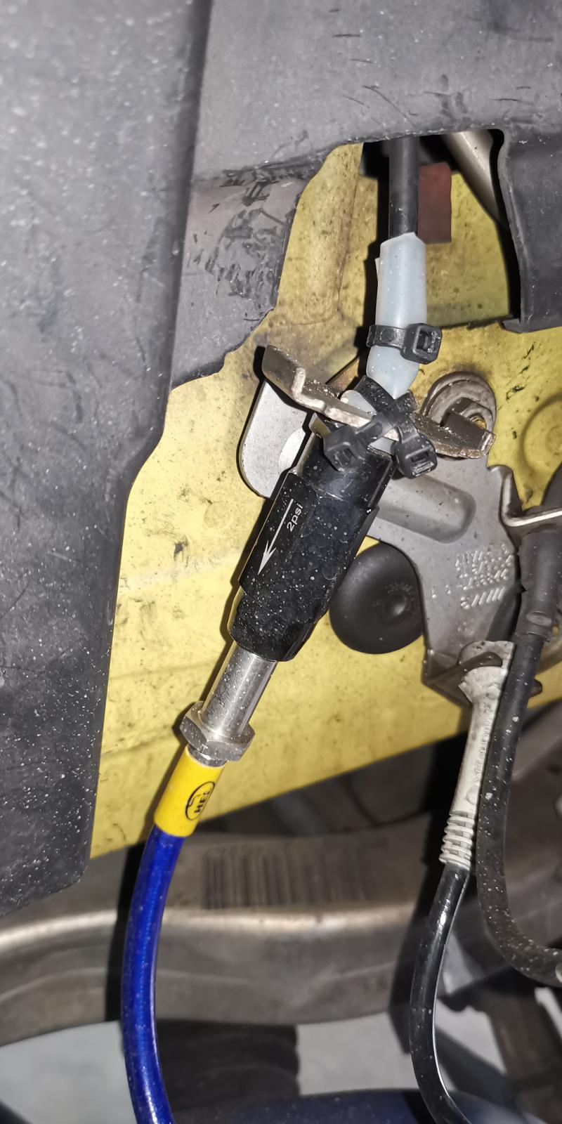

Here's a way out there reply - Try brake residual pressure valves.
Here's my story. I have Brembo GT kit front rear and have been experiencing knockback as well as spongy pedal since Day 1. On every brake press, there is some initial dead travel before I feel the pads contact the discs. And then when I apply more pressure, there is a lot of travel before I get full braking. It's even worse at track. I had to get used to double-pumping the brake pedal each and every time just to get somewhat predictable brake performance. And even then I could not lock up the brakes.
I tried all solutions - Endless RF650 fluid, bled so many times my brake lines are shiny inside. Steel brake hoses, new master cylinder, replaced the DSC pump (it was leaking), Project Mu HC+ pads (which I know give good pedal feel). I tried to look for anti-knockback springs but Brembo did not make them for the GT calipers which were also not designed to accept springs. I had given up and just learned to drive around it, but I never fully trusted the brakes.
Then I found this thing called the brake residual pressure valve (RPV). It's a small valve which allows pressure to bleed out of the calipers when you release the brake pedal, but maintains a small amount of residual pressure so that the pistons can't retract all the way. It's used mainly in custom hotrods to prevent all the fluid from back flowing to the fluid reservoir when the reservoir is mounted lower than the calipers. A lesser known function is to prevent knockback. By keeping a small amount of pressure (2psi) within the calipers, it stops the pistons from retracting too much and prevents caliper/pad movement from pushing the pistons further in (knockback). Best of all it's cheap! The ones I used are from McGill Motorsport but you can get them from all kinds of motorsport shops and even on Amazon (I don't trust the cheap China ones though). I went with McGill for the metric fitting.
https://www.mcgillmotorsport.com/bra...psi-c-70-p-364
I mounted them at the end of the hard line before each brake caliper and had to get custom brake hoses made from the RPV to the caliper. So if you have only front bbk then you need 2 RPV only.
The difference was amazing. With the RPVs installed, there was near zero dead pedal travel, the moment you step on the brakes you can feel it contact the disc immediately. There is no more spongy feeling either. The brake pedal is nice and firm and consistent every brake press. Best of all, it somehow feels as if the pressure in the entire brake system is increased. I can now lockup the tires at 60-70% pedal travel, the braking is now tire limited and not pad/caliper limited. Modulation is still easy and it is not as on/off as the AP Racing Pro5000R kits I've tried.
As for downsides, I did not find any. There is no pad drag, the pistons still retract far enough to let the pads clear the discs. Shortly after I installed the RPVs I got new pads and discs and even at their thickest there was no problem. However, I have only tested this on Brembo GT. Ymmv. I think the RPV only works for fixed calipers, it may not work properly with sliding calipers like our stock brakes. I have also not tested it at track but I have done dozens of balls to the wall hill runs with tons of hard braking and zero issues.
Anyway thought I'd share this as it's taken me 7 years to find a solution to finally allow me to trust my brakes fully.
P/s: Had the work done by a local race shop and that's how they cable tie their brake lines. If you want you can custom fab a bracket but they said it was not necessary.
Your zip tie game is insane!
Innit lol. Race shop didn't even bat an eye lid. They just said don't worry about it.
