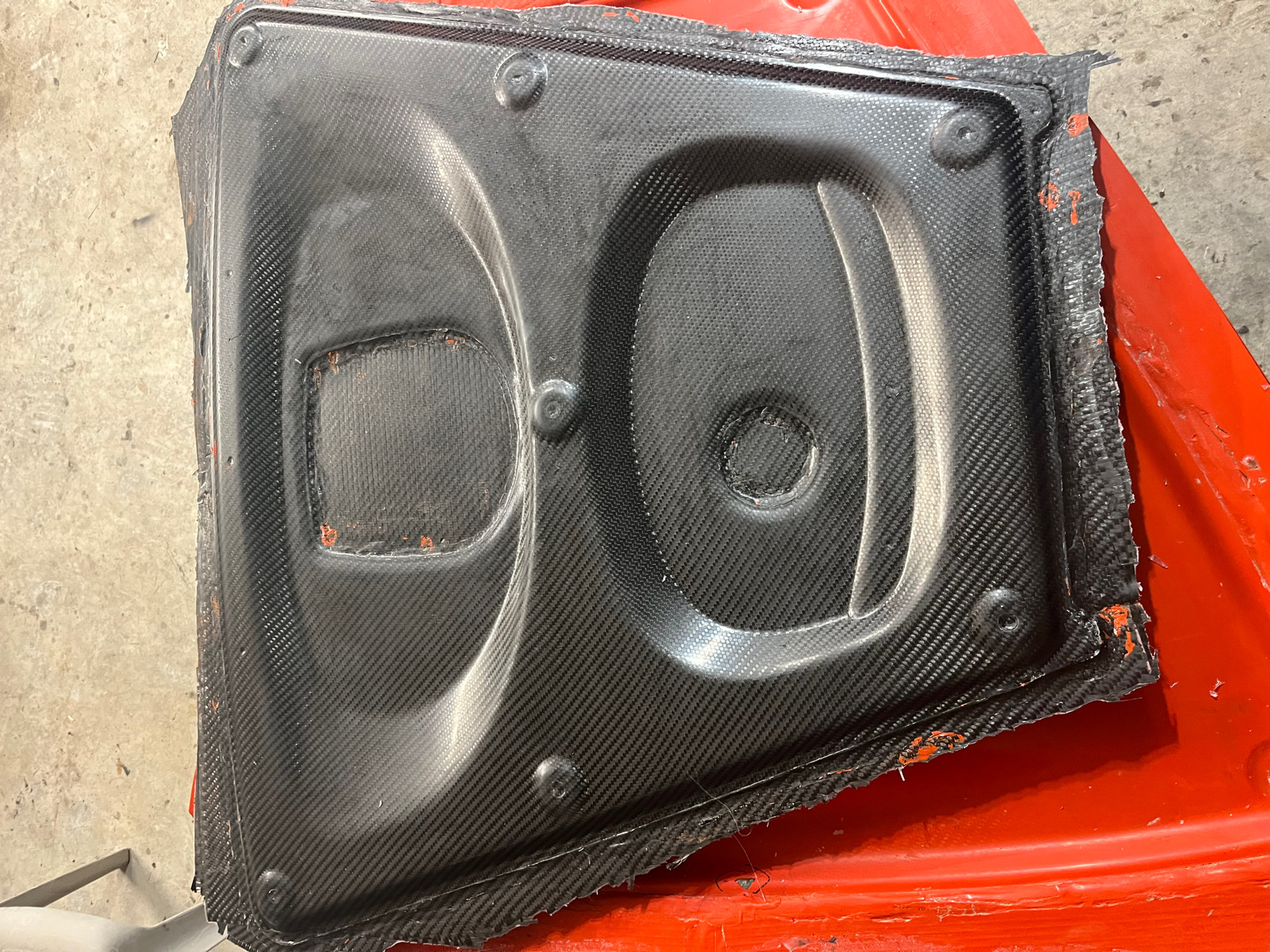

I was able to get an extra front plate in really good shape. Figured why not?
I made a front plate for my E46 track car. Tested for the last 8 months, it’s still working!
So I decided to make an E90 plate using an infusible core. So here it is…

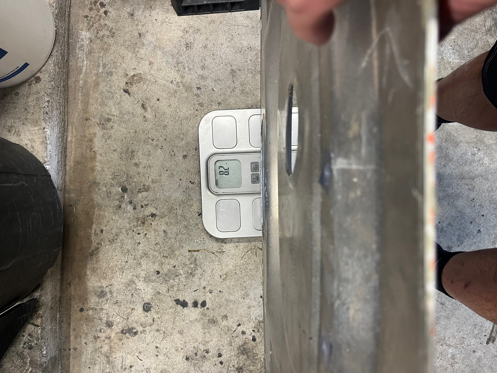

8.2lbs vs 4.6lbs! It is about the same stiffness as the aluminum plate by my very unscientific test of standing on it.

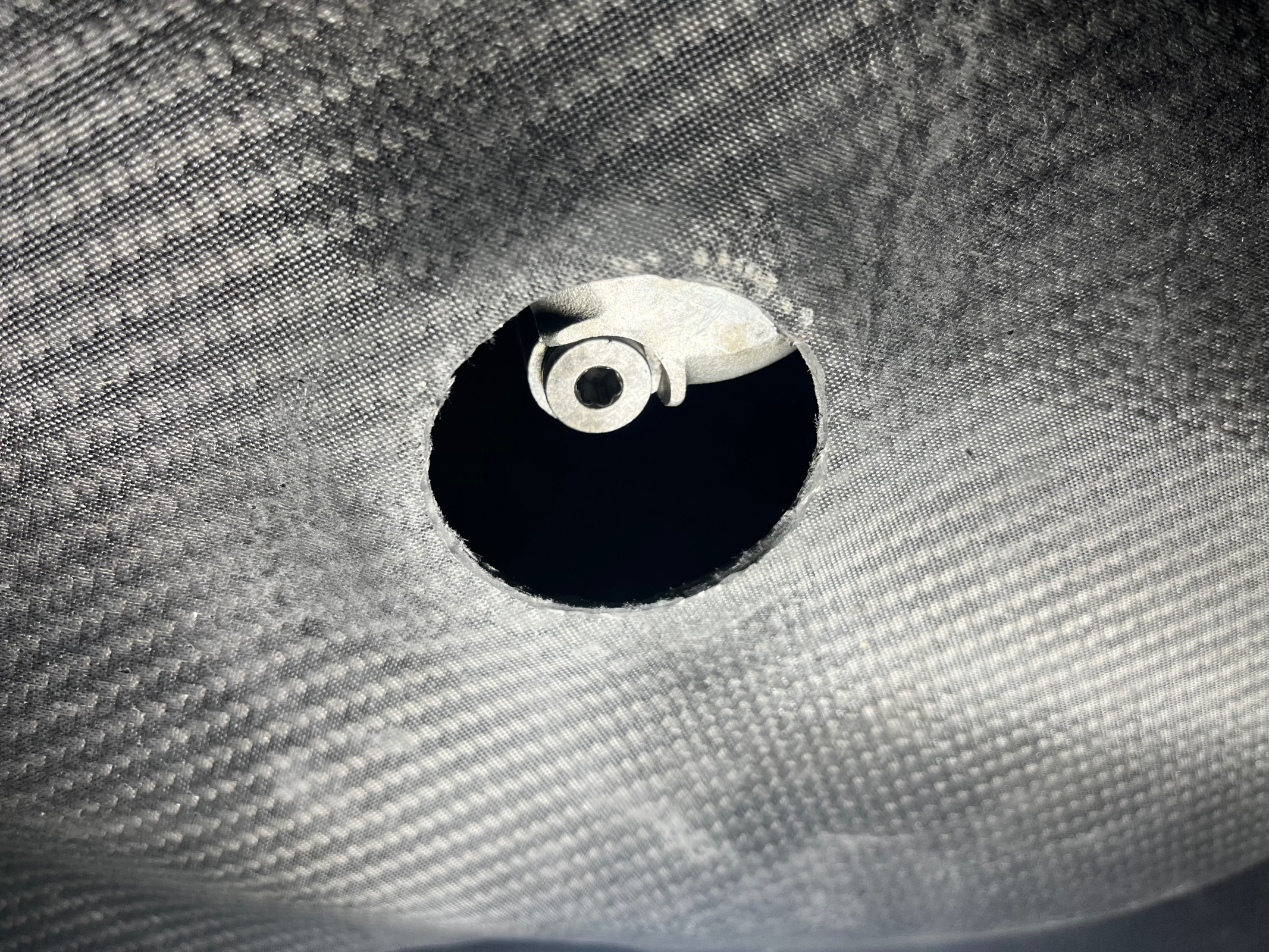

I’m still working out the fasteners for the underbody panels and jack point. And then it will be time for a test fit tomorrow.
I need a 3” hole saw to cut out the front opening. I will test fit and see if it works as is. I think it should.

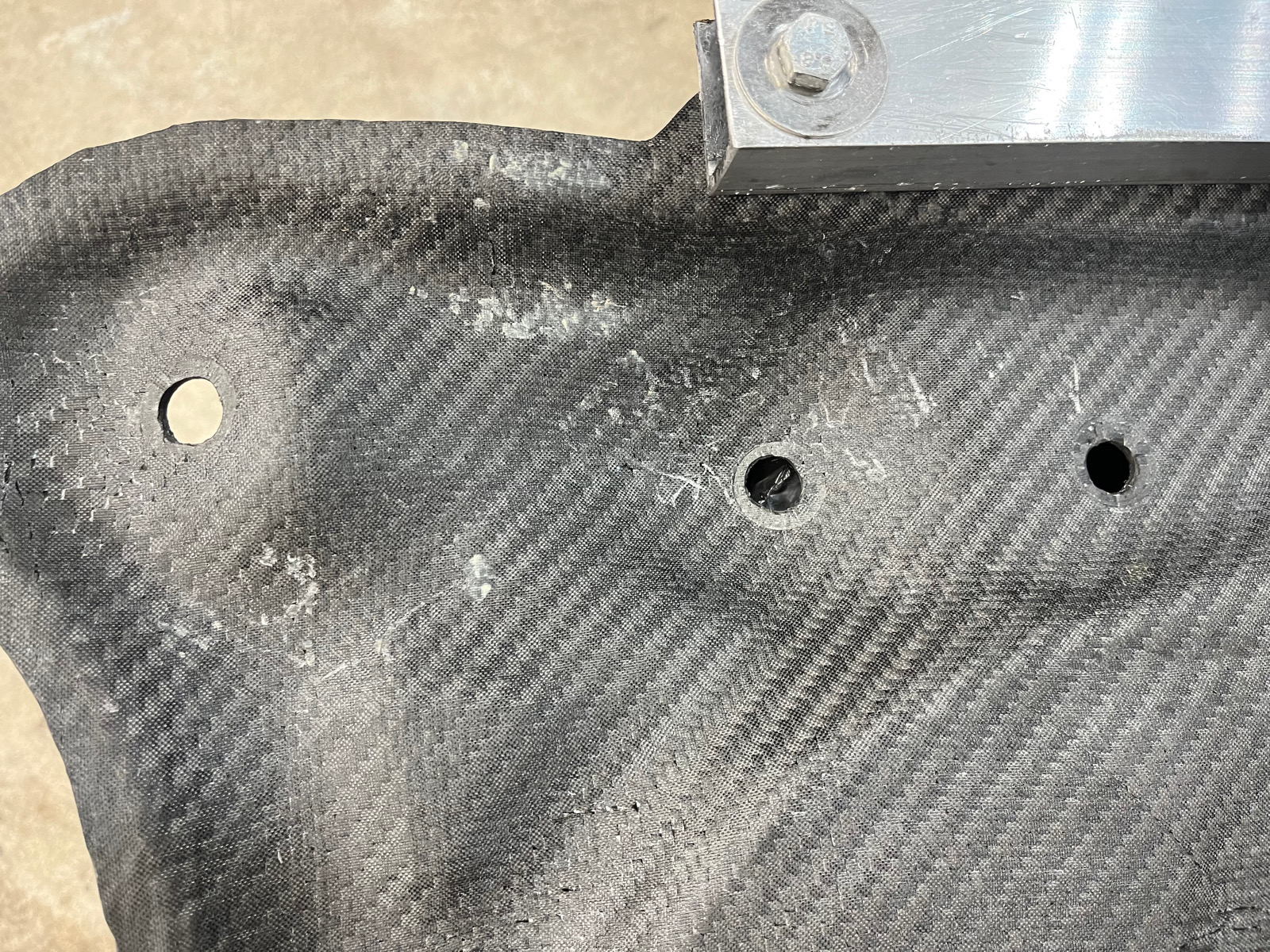

Very nice! How do you reinforce the bolts holes so it survives being regularly removed and reinstalled without cracking/chipping?
As long as there is no core material then no reinforcement is needed. It will actually last longer than aluminum since the aluminum galls.
The attached pic is from my E46 plate which is 8 months old and has already been removed a couple of times.

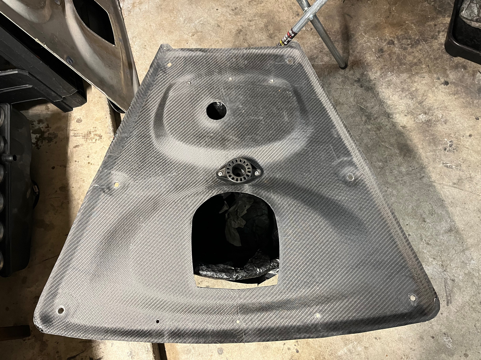

Plate is done! Test fit complete and hardware installed.
I installed the jack pad with some steel rivets I had laying around and then realized there is an OE part # for the rivets.
I used stainless rivet nuts to hold on the front engine screening.
