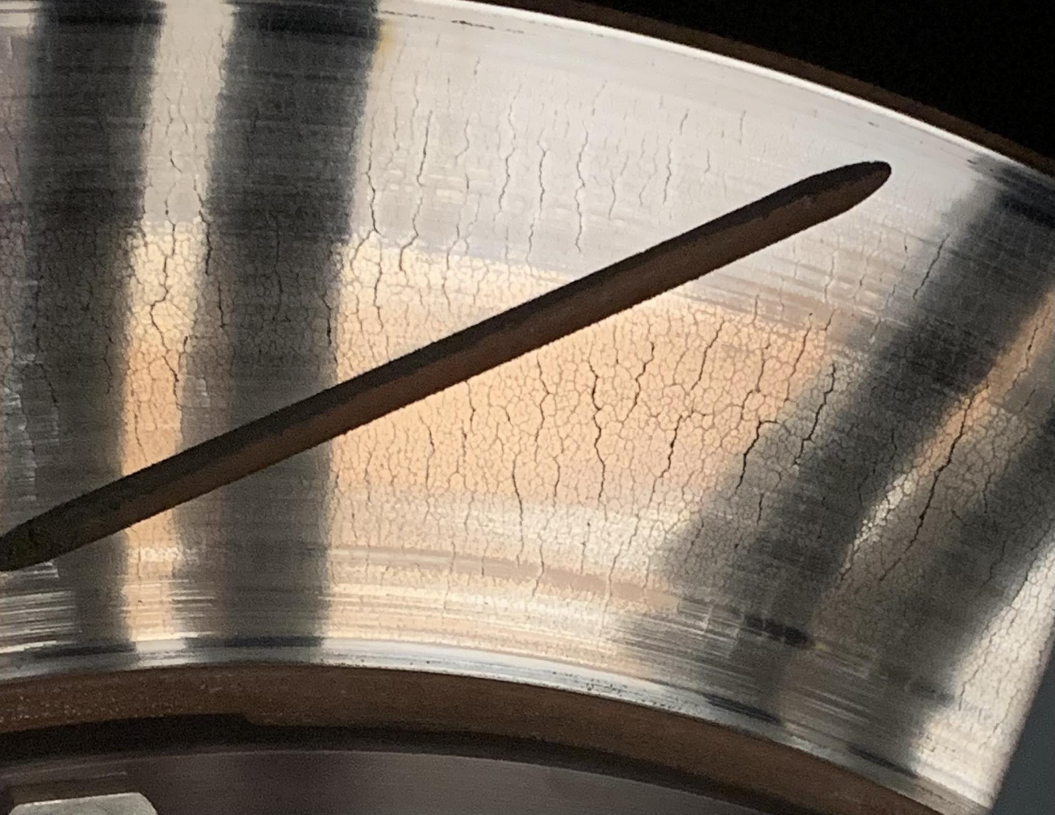

I think I have 11 track days on the ST60 rings.
They're getting a little cracky, not horrible but was advised to order up some spares.

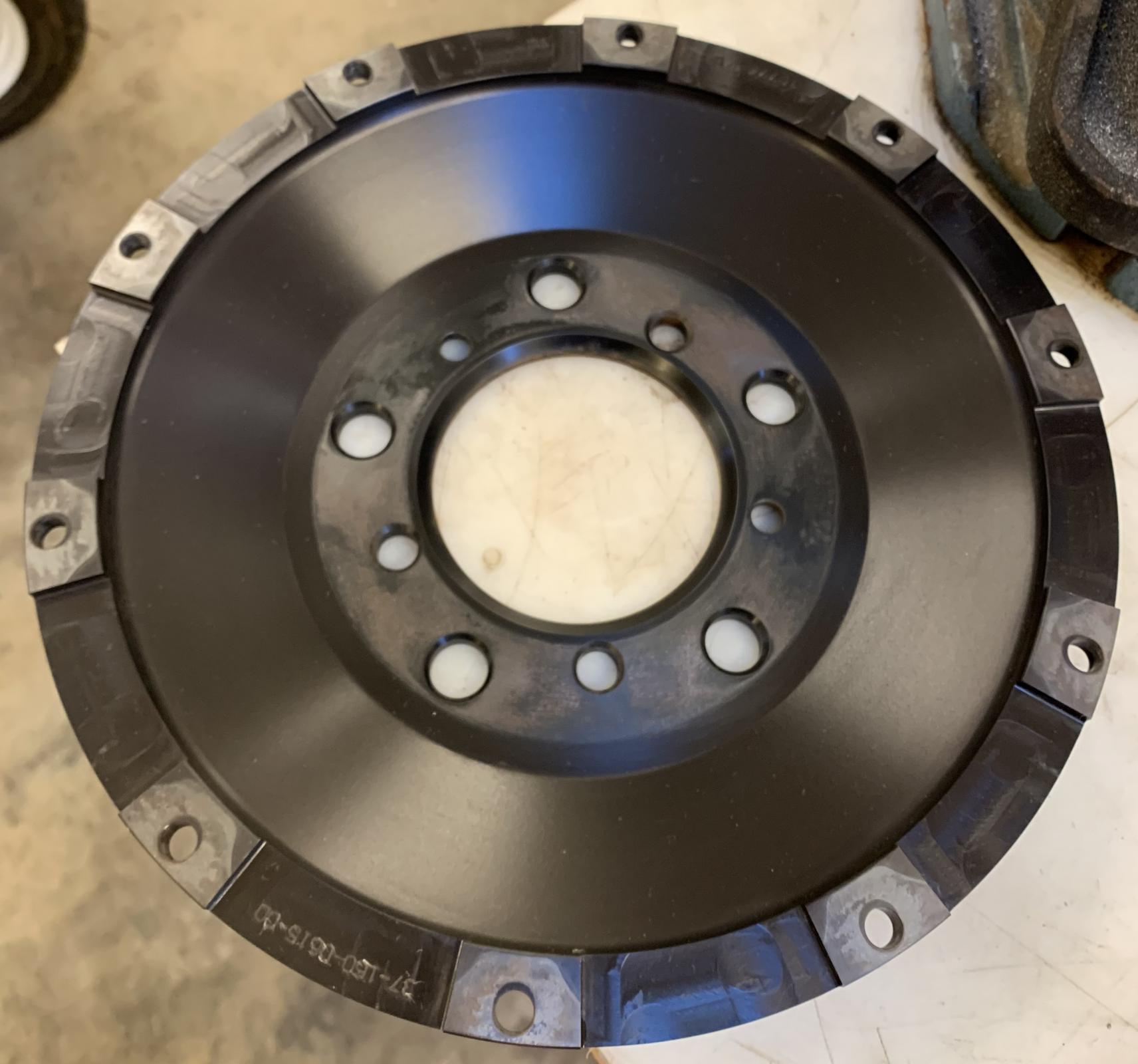

I have an event scheduled for Sears Point next weekend, so went into the garage today to install the track pads, and decided to install the GiroDisc rings as well, and make the ST rings the spares.
Clean those hub faces folks:
...and the hats
Before:
After:

so what exactly was wrong with the ST60 rings? that looks normal.
      11-13-2022, 09:50 AM   #4
Davisca455
Davisca455's Avatar
2242
867
Drives: 2008 M3
Join Date: Oct 2012
Location: Davis, California
Nothing is actually "wrong" with them.
https://www.essexparts.com/news-blog...-my-iron-discs
^^^^^Very helpful document!
I had emailed David Zeckhausen to ask his opinion on the condition of the ST rings.
He said they were still ok, but that it would be an appropriate time to get some spares on order, so that's what I did.
Right after I placed the order, I read on the forum where someone broke a ring at the track, which ended their day early, so now their policy is to bring spare rings.
Their logic was something like "Better to install a spare ring on the lunch break, rather than having your day end early and on a flatbed."
So yesterday, when I went into the garage to install my track pads, I looked at the box of new rings just sitting there on the workbench, and I thought "Might as well make the ST rings the "spares", and just install the new ones."
It's one thing to push the rotors at Thunderhill East, there isn't much penalty for an off, but it's entirely different at Sears Point, where an off there will likely have very painful consequences.

I love the runout tag!

I love the runoff tag!
YES!
Max Runout of 6/10ths of one thousandths of an inch!
Love that GiroDisc makes their inspection process visible.
They make some NICE equipment.

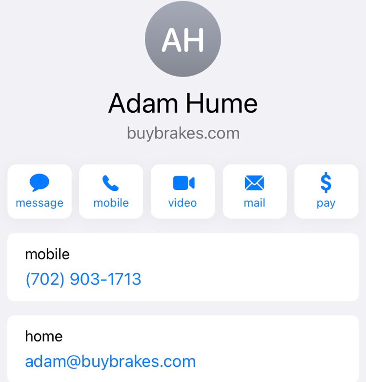

I've since heard from Adam Hume at buybrakes.com.
He checked with GiroDisc and they told him their lead time is 2 weeks, but again that was for the ST60 rings.
But Adam's price is the lowest I've seen as well, so I'd highly recommend contacting him to place the order.

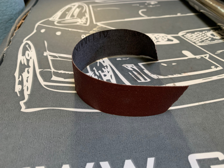

Location: Lost
I'm jealous. Still buttoning everything up. Finally getting to the brakes. Your bearing hubs look great! I often say I'm going to do that, but always seem to get tired from the project before beautifying things...
Davisca4552241.50
      11-13-2022, 04:25 PM   #14
Davisca455
Davisca455's Avatar
2242
867
Drives: 2008 M3
Join Date: Oct 2012
I take the extra time to knock off the high spots.
In my mind, it makes me feel like the rotor assembly has the best chance to run true.
It actually doesn't take that long though.
I use Crocus Cloth (abrasive with a cloth backing instead of paper), and it makes quick work of at least the high spots of the corrosion.
