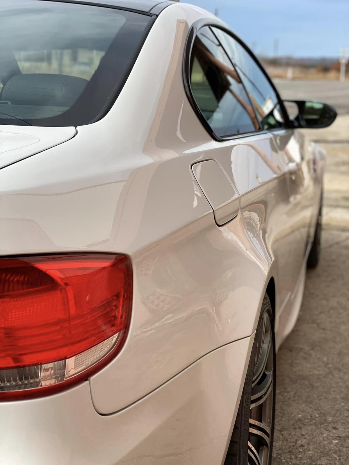

Sorry for the late reply. Here are the pics of the work Dirty wizard paintworx did on my E92 M3. The overall paint and carbon turned out awesome, couldn't be more satisfied. These guys do it right and work their magic.
