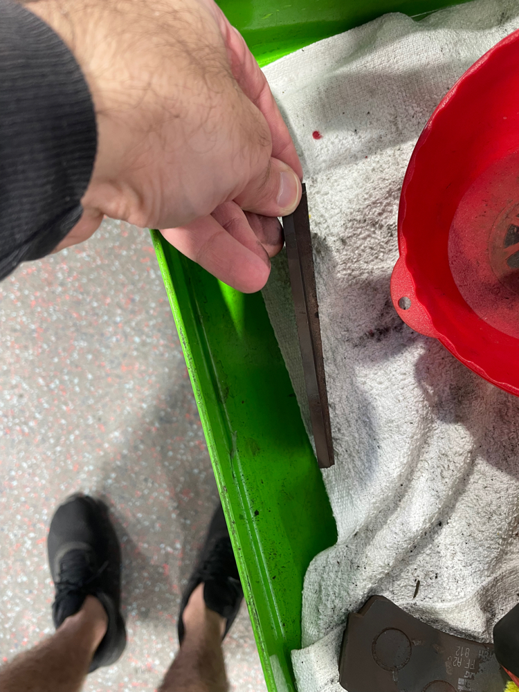

Been an AP user for 10 years. Have had two deferent kits—the older CP5555 kit and the 9668/9449 kit. (I still have the old kit on my steeet E92 M3.) Never had an overheat. Never had brake fade. Super strong stopping power with high torque pads. The calipers don't need any attention between rebuilds. With SRF, you bleed them once every 8-12 months.
Essex service is nice when you need rebuilds. I rebuild every couple years.
The biggest annoyance is that sometimes one pad will wear quicker than the others. Just need to keep an eye on them and maybe rotate. I believe this can be track dependent.
Also, on the 9668, don't use the spring clips for pad retention. Use the bolts and blocks. The pads wear REALLLLY uneven with the spring clips in my experience.
Some (SYT_Shadow) get pad tapering. I haven't seen that on my kits.
I don't know what constitutes aggressive taper, but these were my ds2500 rears with AP 9449. Gabe, what pads are you on? I'm now on ds1.11 all around
Cobalt Friction pads:
Front: XR1
Rear: XR2
I don’t recommend XR1 if you don’t have slicks. If you don’t run slicks, then go Front-XR2, Rear-XR3.

We've had PFC, the BimmerWorld-Alcon and the AP Radical rear
PFC is top shelf. The fattest pads which also happen to be cheapest. We still have one full BBK and a second front-only PFC. It's good enough that we spent a long time in Solidworks and 3D printing to get front brackets built for our F8X as PFC does not officially support the F.
The Z54/45 kit properly sends bias to the rear of the car. 28mm front, 20mm rear pad.
We continue to get this serviced without issues, at least so far. We've been hearing about gloom and doom for years regarding PFC service, so far everything is in stock at BimmerWorld and we're yet to have any kind of issue, whether it's rotors, hats, pads or rebuild kits for the pistons/seals.
The PFC rotors are cast in the US and are cut without using lubricating oil. Massive cost difference but that avoids the rotor from absorbing oil which will bleed out during use.
Front and rear pads come out completely flat with no taper despite being the fattest pads of all.
The Bimmerworld-Alcon kit is the new hotness. We've run it for two seasons. It has a 36mm front rotor (vs 32-34mm PFC/AP) and that makes a huge difference in durability and heat dissipation/thermal stability.
25mm front, 23mm rear. It sends bias to the rear of the car.

We still have the two sets of rear pads we ran that are tapered enough to build a triangle when you stack them. When you have a 17mm pad to begin with and then you get 5mm of taper, you're screwed.
