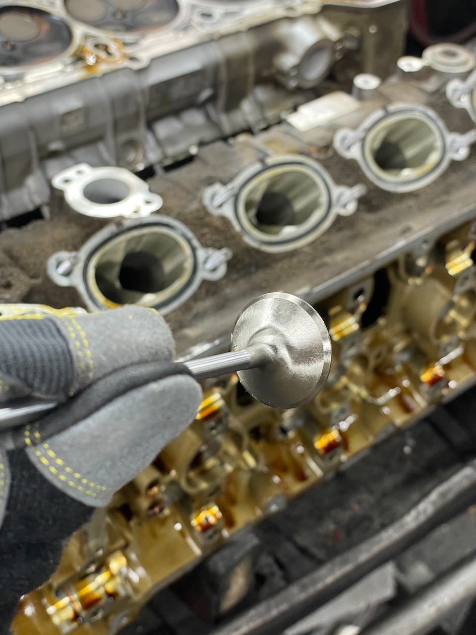

New motor/s heads are getting valves seated, sodium filled valves, valve springs, and light porting. Every seal will be replace and BE rod bearings / bolts. I'm praying the old block can be saved so I can send it out to be sleeved / bomb proof for stage 2. Debating between stroker 4.4 or just run ESS G1 with larger pulleys for track use.

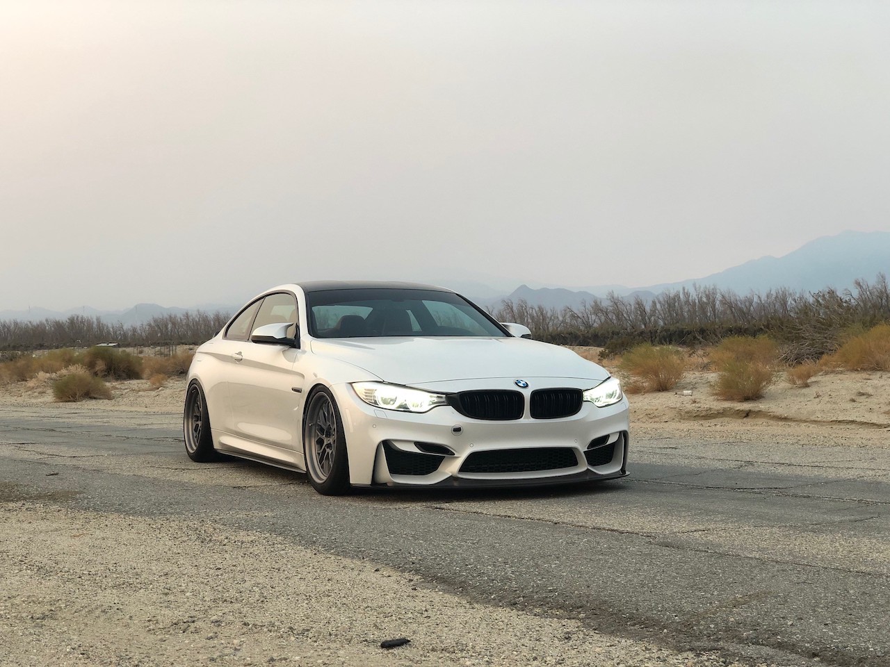

Track wheels don't always need to be dull looking or require spacers to clear brakes. Ours allow the PFC massive BBK swims in the barrel, no clearance issues.
53.1mm lip, concave, motorsport drop cup lug area, and Signature Friction Lock (anti slip knurling bead tread) to reduce tire slippage which can throw the balanced set out of balance.
18x10 ET15 square with track camber setting is perfect per our measurement. No rubbing and clears suspension without needed shorter springs.
Wheels in production. 4 weeks wait time.

See below. First set will be an era proper concave mesh and lip, Signature Attack Series SV602. We're incorporating our new S.R.A (Signature Reinforced Architecture) feature into this set. Our wheels are strong, light, and durable, but S.R.A is a bit beefier to handle anything you can throw at it. It also includes our Friction Lock feature to prevent tire slippage with these sticky tires, especially cold PSI for many track rated tires are low enough to allow tires to slip around the wheel making the balanced set unbalanced after a few laps.
More details coming soon.
Tom Wrigley Performance took our wheels to 207mph with his M240i, smooth as butter.
Originally Posted by berns View Post
Sounds like a proper car, but why limit the contact patch on this heavy thing? 18x10.5 +20 fits perfectly, clears huge brakes, clears MCS, and you can run 295 square.
We have a couple sets of 275/35/18 3R, will use the 18x10 for this then the set will be up for sale used. Phase 2 is 295/35/18, then widebody for some real meat.
Kohlmann | BMW Addict | Signature Performance Wheels | OBSESSED WITH PERFECTION | IG: Signature_KC | Email: kmann.signature@gmail.com
Unfortunately, if you want something that lasts a while you have to leave the internals alone and supercharge.
Signed: 3 stroker person

Supertech Valves Springs and Valves
Our S65 only has 68k miles and is getting Supertech Inconel Exhaust valves, black nitrided intake valves, and springs. Valves will get 5-angle jobs and light ported.
The S65 reaching higher mileage will have 2 weak links: Rod bearings and valve springs. Older valve springs tend to float at high RPM, will end up breaking or snapping the valves which is called "dropped valve". This is catastrophic on the track. If you plan to boost, good idea to get main bearings done and might as well get the crank polished and balanced at that point.
My big surprise is the S65 comes ported out of the factory. BMW puts in a lot of thoughts for this motor, makes it unique.
