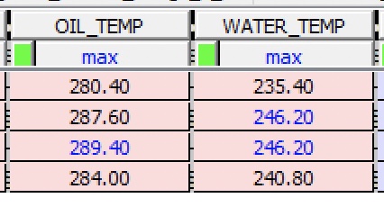

      10-11-2021, 11:19 PM   #13
dogbone
dogbone's Avatar
5576
2,866
Drives: '09 E90 M3 - IB
2009 BMW E92 M3  [0.00]
2009 BMW E90 M3  [0.00]
255....sigh.....that would be nice....
Here's my temps at VIR.....
