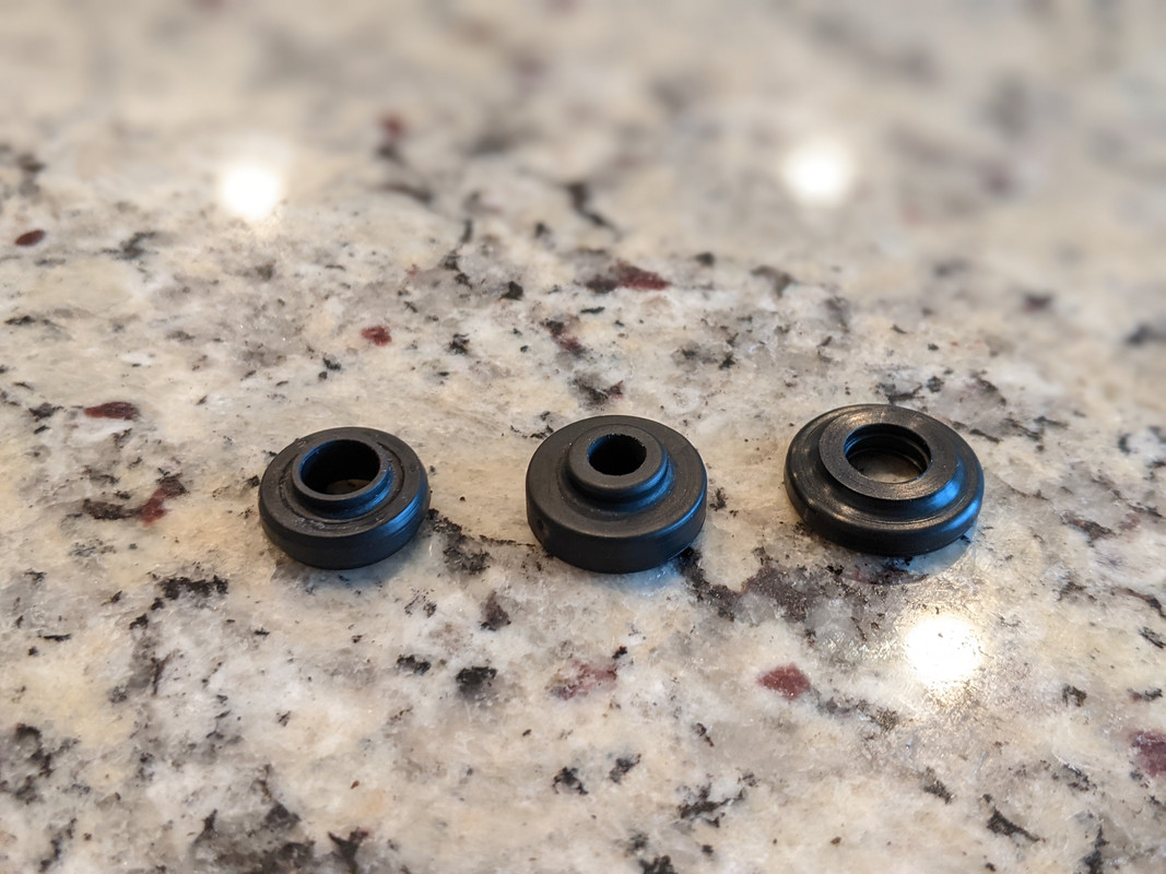

Saw some talk about using m62tu grommets so that the bolts can be re-used when doing valve covers.
I bought a few sets to examine and these are my findings:
Left: Original S65
Middle: 11121721879 - M62tu
Right: 11121437395 - M62tu
My thoughts: None of them fit like the original. The ID of the middle one is too small and not able to fit over the S65 bolt easily. The OD of both are too large.
Outcome: I won't be using these, I ordered $243 worth of S65 valve cover bolts.

Why won't it.work? It's just a rubber washer right?
Have you looked at 11127501588

It also seals the area around the bolts from oil coming out. While it might work, I'm not interested in having something smashed in there and not sealing properly.
11127501588 is #12 below for the plastic ignition cover. Completely different part.

I may have found a possible option, looks very close but need to have an actual bolt to compare. Not going to take one off my car so plan to buy 1 and see. If it works will let you guys know. Might be a good deal cheaper.
EDIT: Well, not so much. Very similar to the one on the right in tdott's first pic, maybe a little closer but still will not fit correctly. Sorry, another swing and a miss....

FYI there are no alternatives within the entire BMW parts bin to replace just the rubber grommets on these valve covers. It has been researched exhaustively and has been a point of contention for years.
You just gotta pay up.

tdott Just found these on one of the FB groups tonight -
https://autotuninghouse.com/products...hSbXrnV58fkwIs

Thanks, yes looks like we now finally have a solution (long over due imo) same ones darkbmw mentioned above.
But right now I am good, I have a set from FCP.
