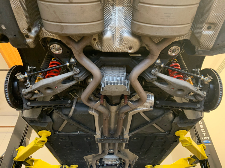

Curious if these came with 2 cats vs. 4 cats on OEM x pipe on our cars.
Any idea?

I think akrapovic made the exhausts for the gt4 cars and they had no cats or resonators at all. Completely straight x pipe

GT4 X pipe. No cats, no resonators.

An x-pipe is an x-pipe. Any straight thru x-pipe from any exhaust manufacturer would probably work the same.
That said, did anyone else notice the H-merge up front right behind the gearbox? And ahead of the main x-merge in the stock location?

difference really comes to weight savings and the H-pipe design equalizes exhaust pulsses

X-pipe is not any other X-pipe. For difference in delivery in power can be done through bends and diameter. In regards to Akra, GT4 pipes don't sound the same and are manufactured specific to the V8. Titanium also doesn't sound the same as stainless.

@kyrix1st are you running a tune? Might need a custom tune since this GT4 X-pipe has a forward merge.

The GT4 merge is in the same location as stock, I think. I never put the two next to each other but the merge is right at the support bracket.

If you look closely, there is a H-merge very far forward, right behind the gearbox.

I realize there is an H merge farther up but I'm not sure that is going to have the same scavenging affect an x merge has. If you look closely the x merge is in the same location as stock.
I've been running my GT4 X for 2 years and almost 20k miles with a catless tune. I think the tunes you're thinking of are for mid sections with the actual x as far up as they can go.
The GT4 does not require anything special from a regular catless tune apart from disabling the rear O2 sensor because there is only one O2 port per side rather than two.

You can still buy the the H merge link pipes (section 1) directly from akrapovic for about $1k, you could then have a muffler shop/ti fab shop build you an x pipe to match whatever rear section you wanted if you desire a gt4 setup.

Hmm... I already have a full decat exhaust with the x-merge in the stock location (under the center bridge bracket). I thought of getting a local exhaust shop to add a H-merge in the forward GT4 location. I'm running a BPM Stage 2 tune, so I reached out to BPM who told me that a forward merge might affect low rpm driveability. But I think they were referring to a forward x-merge like in the BW X-pipe. Now you got me thinking if I should go ahead and try out this GT4 H-merge.
I wonder what gains adding the H-merge would have, if any?
