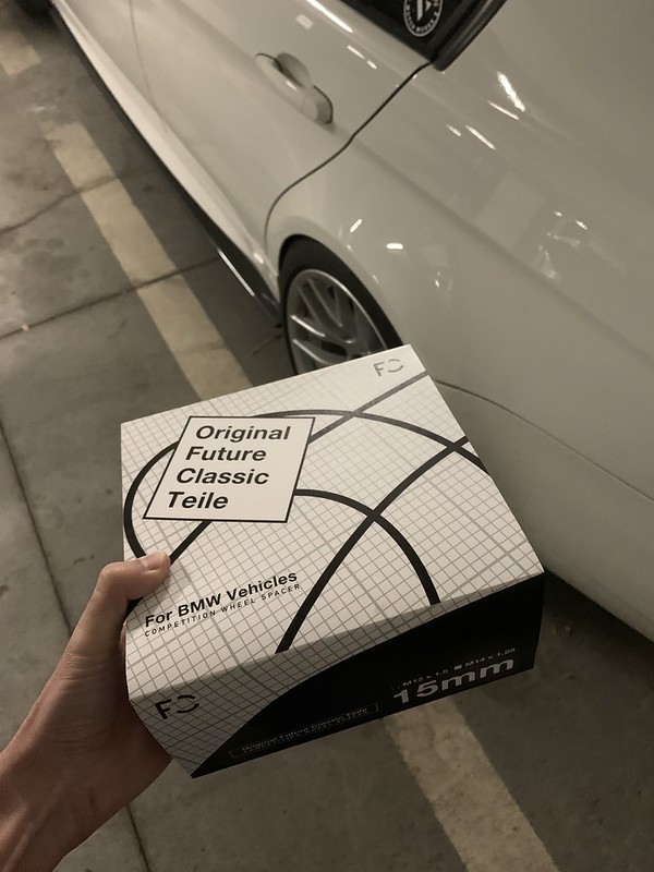

Picked up a fox red split armrest, with some wear that I will later fix! Yes, in Canada we didn't get the split armrest for some reason. I guess comforting our elbows isn't worth the extra cost to the Germans
I also swapped on some OEM 359M wheels that I had previously and was using on my 335i. Made a huge difference to the look of the car! I liked the HRE C20, but the black faces just isn't my style. We'll do something about that later...
255/35 front with a 15mm spacer and a 275/35 on the rear with a 12mm spacer. Perfect

I had been using some basic 15mm spacers on my fronts, and was getting some strong vibrations through the steering wheel on the highway. I thought it might've been my old set of 359M but when I swapped the new set onto the car, it still vibrated. So I decided to pull the trigger on some Future Classic 15mm spacers to replace them with. I figured that, if it's the spacers causing vibrations, the Future Classic one's will be the best at reducing them as they are the only ones that I could find that actually screw to the hub. Do it once, rather than wonder if that little extra feature would've made the difference.
I've got to give it to them on the packaging. It is a very nice product.
Even the extended bolts felt nicer quality than any spacer set I'd had before. They have a small concavity to the bolt head that gave them a nice little extra detail.
With the hype that Matt @ obsessed garage built up about their brush in his video, I expected the brush to be nicer. Not that it matters at all...but if I was to critique this relatively quite expensive spacer set...
Same with the anti-seize, I expected and could've used more. It almost seemed like a waste to even put such a small amount in this tiny little container lol But again, doesn't really matter and still a nice touch to include it in the package.
Ultimately, they're the best quality spacer set I've seen and used. The vibrations were drastically reduced, although still there slightly. Might need to try a Future Classic set on the rear too before ruling out that better spacers could remove the vibrations all together.
