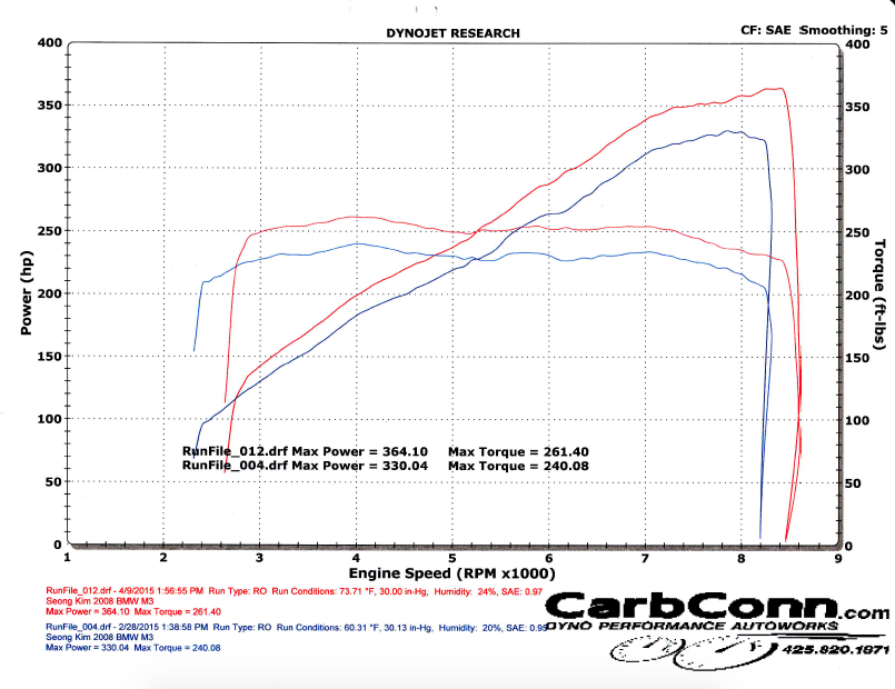

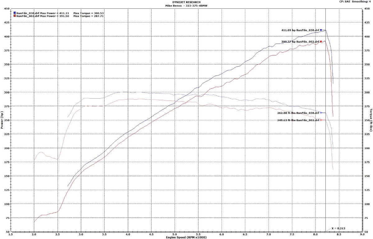

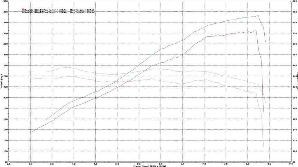

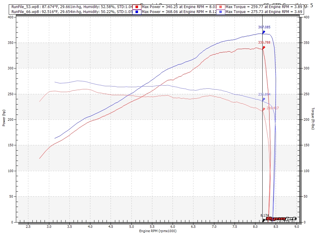

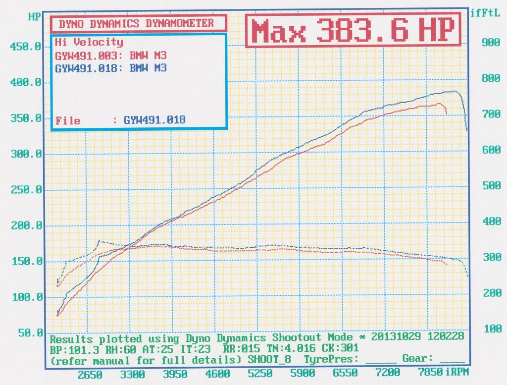

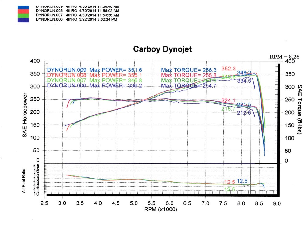

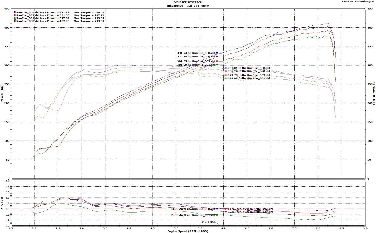

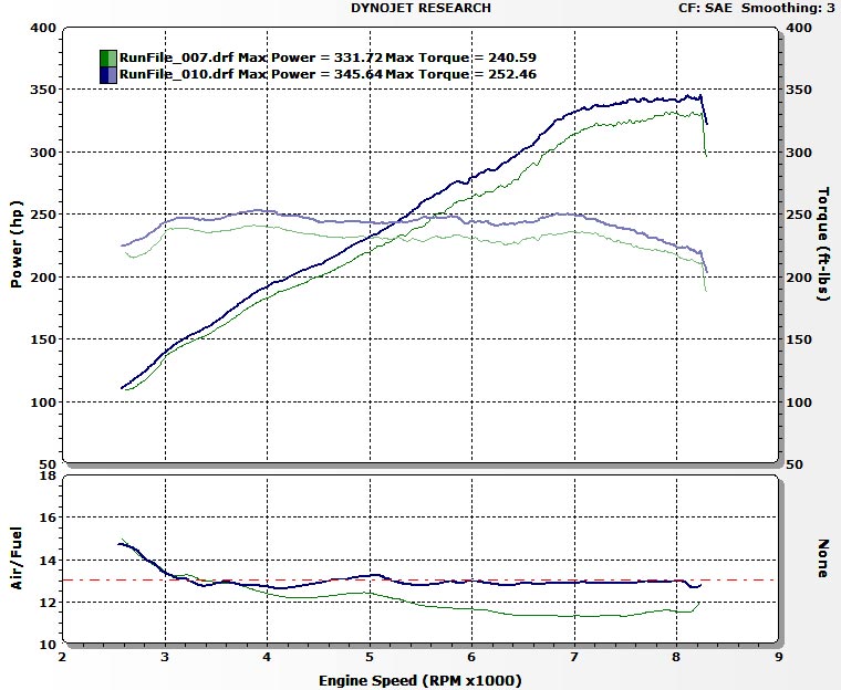

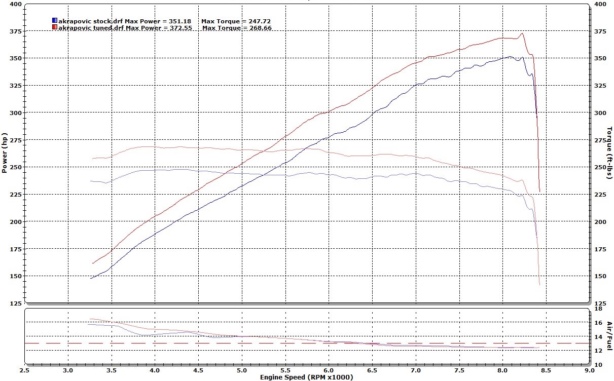

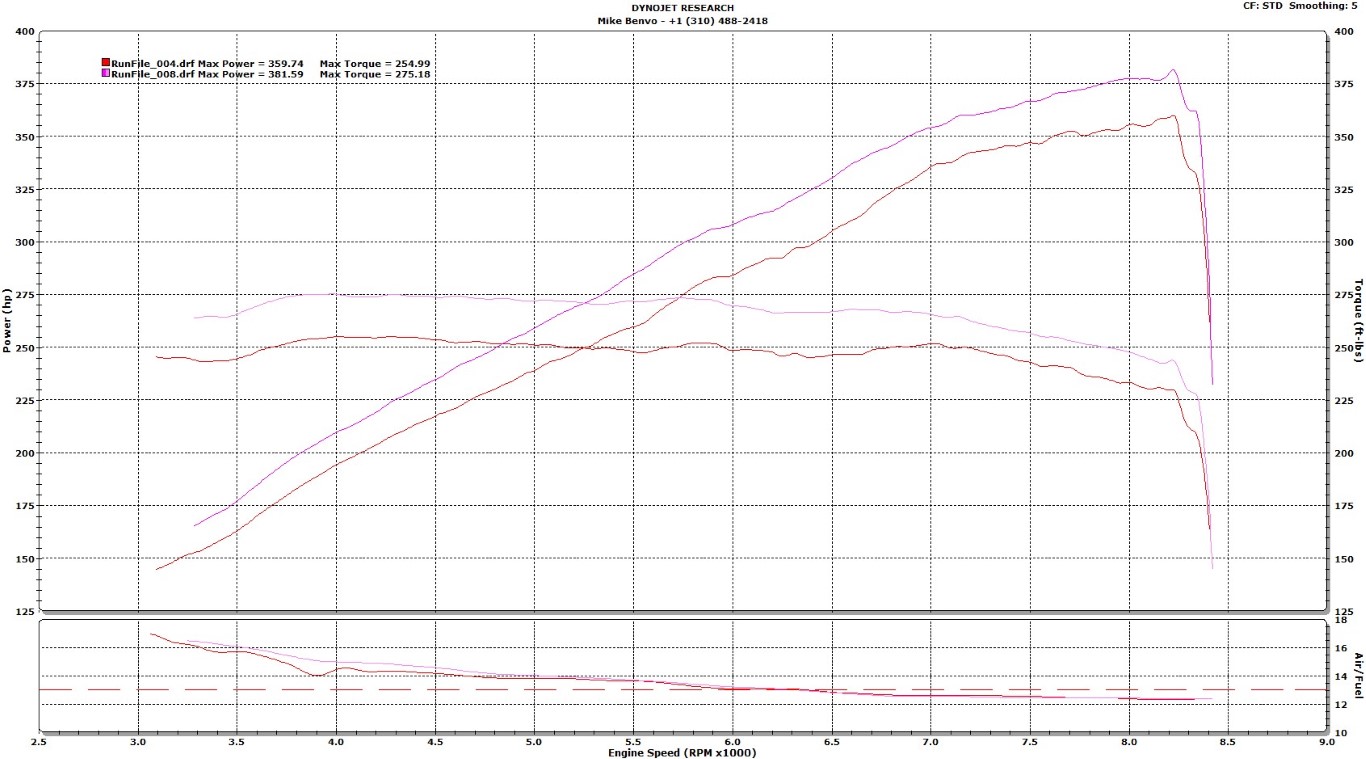

Thought we'd post up a few dynos sitting on our server. Most are stage II before and after tune, and the last two are stage I. Some are FBO before/after. Also note, that the stock baseline used on these graphs is run 2 or above. Using run one as a baseline creates an illusion of an artificial grain that is simply not there. For example, look at the difference between run 1 and 2 on the third graph. That's a 14 horsepower difference from run to run. We keep seeing vendors and members posting graphs of tune "x" showing this type of artificial gain. The majority of people will be fooled by this, but those with experience on this platform know the truth. You must run at least twice to get an accurate baseline!
