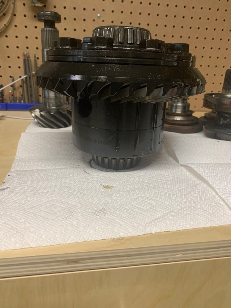

Now I need to figure out what to do with this lump...
Are you attempting to do all yourself?

You need equal length 210mm axle stubs which should come with the E39 M5 diff. You'll need to swap the ring gear.
I believe the M5 diff is a 2 clutch with 45/45 ramps.
I don't think you'll need to machine the ring gear holes to 14mm.
I swapped a diff from an E24 635CSi and went with a 4 clutch conversion. The LSD rebuild part wasn't that hard.
I am in no rush. Need to do a bunch of research and see what I need to do. Will likely get help to make sure I don't F it up.
Also, I would likely want to refresh the diff, see if 30/60 or 45/45 is what I want and get 4.10 gears. It will be a bit of a project.
I just built my 3.73 4 clutch ZF LSD for my E46 M3. It's not as hard as most lead you to believe. A hydraulic press and a big impact makes life a lot easier.
It goes:
With an empty case, install the LSD unit and set preload by adjusting the carrier shims.
Remove, install pinion gear but DO NOT crush the washer or install the input seat. Snug the pinion nut to take out any up/down play in the pinion.
Install LSD. Apply gear marking compound (I used diaper rash cream) to the ring gear, front and back of a couple of gear teeth. Based on the contact pattern, make shin adjustments.
Once gear pattern is good, take a backlash measurement. Should be good.
Remove LSD and clean gear compound off.
Crush sleeve on pinion to set preload. I used an impact with a big holder made from steel bolted to the pinion flange. Hit it with the impact - really short blasts - check preload and repeat.
Doesn't take much once the bearing starts to drag. Go slow. Once at spec, install pinion seal and recheck pinion preload.
Reinstall LSD, check gear pattern and backlash one more time.
If all good...finish assembling and done.
