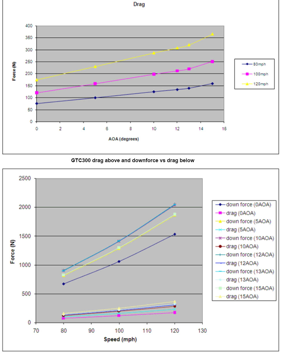

I know this has been discussed but I think there is a lot of mis-information. The common consensus here and at APR is that the GT-250 wing works better on an E92 M3.
The assumption is that we are all okay with a 67" wide wing that sits 18" above the trunk lid such that people bang their head on the edge of the wing if you are parked in a public parking lot and someone walks down the aisle between you and the car parked next to you.
The reality is many of us want a wing that is shorter, 61" or even less, maybe even 48" wide and only 6"-12" off the trunk lid because we street drive the car. 48" is about the width of the trunk.
So the nutshell opinion is that the GTC-300 is more "draggy" and that the E92 doesn't have enough horsepower for a wing that "draggy". But the reality is the GTC is a much more efficient wing when you compare the L/D ratio, that is lift vs drag, and we are really looking at negative lift, an airplane wing upside down.
The GTC-300 is already making 151 lbs of downforce at 0 degree angle at 80 mph, whereas the GT-250 is making a fraction of that, 43.8 lbs of downforce. In fact for the GT-250 to make as much downforce as the GTC-300 makes at 0 degrees, we have to run the GT-250 around 13 degrees interpolating stated downforce at 10 and 16 degrees.
Most have said they run their GT-250 at 0-5 degrees, so the reality is that if we hang a 67" GTC-300 18" in the air we just can't get enough front downforce to balance it out. So why not run a GTC-300 that is only 48" wide?
That statement that the GTC-300 is more "draggy" is incorrect. The numbers for it were stated in Newtons, so I put all the data in excel, converted it to lbs and also calculated L/D ratios on it, as APR publishes the numbers in lbs for the GT-250
So, running the GT-250 at 10 degrees would give a L/D ratio of 7.52 , at 16 degrees a L/D ratio of 5.28. Remember higher is better, we want to make the most downforce with the least amount of drag.
So, then lets look at the data for the GTC-300. At 0 degrees and 80 mph the L/D ratio is 8.83, it is a far more efficient wing than the GT-250.
So that is the race car engineering theory, the GTC-300 may actually be better as a more narrow wing lower mounted than the GT-250 full race wing based on much more efficient L/D ratios.
Have any of you tried a smaller GTC-300 wing mounted closer to the trunk surface?

Yeah we need a wind tunnel and a team of aero engineers. All data published is a wing in a clean airstream. So the question becomes how high off the trunk deck do we have to go to get any airflow at all.
And part of the purpose of 61” or 67” wing is that the sides of the wing will see much more flow than the center.
I’ll bet there are enough of us that want a wing that we could get APR to make us a 48” wing that works. If we did a GTC-200 or GTC-300 and put it the same height as the GTS wing.
Sometimes I do wonder if many of the people buying this stuff have any race car tuning ability. If I put on a wing and it made the car push my response isn’t that the wing is too big but that now I can increase rear spring rate, roll bar stiffness or shock low speed compression to transfer the load to the rear tires.
I did a lot of autocross in my 20’s and to get th car neutral at low speed and autocross is really low speed 25-60 mph, usually meant way too much oversteer at high speed. So to me the wing is a tool so I can set the car up with enough rear roll stiffness to be neutral at low speed then have enough wing so the car is neutral at high speed.
I have bumper canards sitting here didn’t work with my front lip need a new lip then want all three, lip, canards and rear wing.
