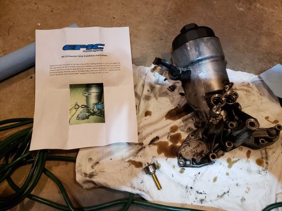

Epic Oil Diverter Valve Success!
I need a beer after this little adventure. A ridiculous number of things needed to be removed and then it took all of 3 minutes to substitute the valve for the thermostat. No idea how guys have made the swap w/o removing the oil filter housing. That spring in no joke! Curious what type of impact this will have on track day temps.

Pretty sure I have this in my e46, never ran without it though so dont know temp difference.

I have one on my S54. Not a good idea for street driving below 50 degrees with 10w-60. The oil will never warm up.
It gives you a couple of minutes more of time below the red. Otherwise it didn't make a significant difference. I think a fresh OEM oil cooler and diverter valve will make a big difference.

1- Takes a lot of time to get to operating temps - minimum 12 mins. I think its safer to install an external thermostat but not sure if that makes sense.
PROS:
1- after a good warm up Highway temps, city, and traffic temps Dropped from ~102C to 98C (215f to 208f)
2- Motorsport events temps: from 125C to ~115Cv (256 to 239f)
however the car actually take less time for oil to cool back down.
We did this on his car as the oil filter housing was leaking. We will monitor this more and report so we can see if we got lucky or everyone have the same outcome.

I put the same valve in my n54 also and it lowered my oil temps around 15 degrees !

The valve is supposed to allow full flow to the cooler. Even when the OE t-stat opens some oil bypasses the cooler.
On my S54, I have the valve and an in-line thermostat. It's an eBay unit which is the same thing that vendors sell except it costs 1/3. Its better than not having a t-stat. There is still flow to the oil cooler when the t-stat is closed. It's a function of keeping some pressure in the loop after the t-stat until it opens. So it still won't warm up as fast as the OE setup but it's better.

I am not sure if the epic oil diverter is the magic solution to reduce the oil temp.
The oil return port is poorly blocked by the compressed spring.
The data posted by dogbone shows that the diverter valve mod is just prolong the heat soak and give us few more laps.
So, for TT runner, it could be good.
But for anyone who typically run the full HPDE 20min session, this is not going to help.
