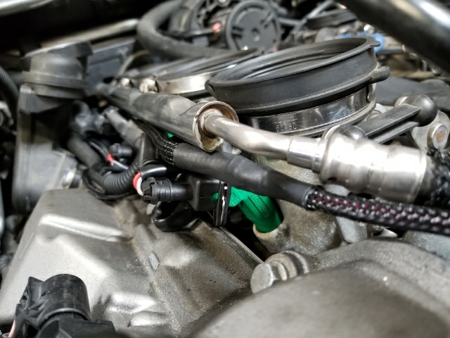

Active Autowerke S/C setup with spacer to move fuel rail up.
R_lara83.00

their you go with ESS you have to use stock runner boots with suck buy the way and active according to this pic you have no clearance issues for tightening.
with ESS manifolds it's to dam close but it did at the with exactly 5mm spacer.

I'm using this setup on my ESS kit. its not really that big of a deal tightening the clamps. I've been running this way for like 4 months. I've had to take the blower off a few times to check or change things.
