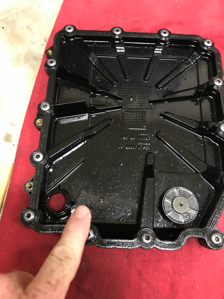

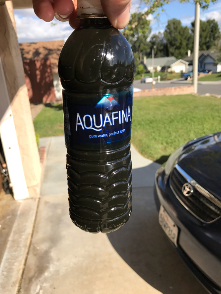

Thought I'd post a few helpful pics.
These are water bottles full of the fluid I collected. Pretty dark after 115,000 miles for a "lifetime fluid".

These two pics are of the overall look of the DCT with the fluid pan off. I found no metal shavings on the magnet inside the old pan and the inside looks good. You can actually see the gears up above if you look carefully. I did not see any signs of wear on any of the gearing that I could see. I had to dodge drips here and there lol.

The pan didn't crack, your transmission threw up. That's some nasty looking fluid!
If you can't get an actual factory number, you can usually get torque values from the size of the bolt. There are a ton of torque charts online for metric hardware. If I was home I'd just pull one out and look at it but alas, I'm in a tiny apartment in the DC area instead.
'19 X3 M40 Carbon Black/Oyster, '21 X7 40i AW/Black, Past BMWs: '18 M550i, '18 330 GT, '16 X5 40e, '11 E90M3, '06 X5 4.4, '03 330i ZHP, '02 M3, '97 Z3 2.8, '95 M3 (2x), '94 530i (manual), '92 525i (manual), '88 M3, '87 325iS
The pan cracked for a fact bud. A trans wouldn't throw fluid.....it would fail. Fluid would only flow out if the gasket wore out or some type of heat generated failure from fluid that would resemble dirty sap. Like I said, I ran over a rock I did not see. Magnet is clean though!

I'm curious what you meant by your fluid looked fine. What color was it? On my spill pan it looked dark brown.....lighter than the oil but brown. In a bottle its black. I haven't seen the new fluid yet. It's still shipping.

It was a medium dark brown and didn't smell burnt.

Your humor detector is broken.
Sorry that your pan got whacked. Reminds me of when a friend hit a cinder block that a truck dumped on the road. Killed his sway bar and oil pan (but not engine!). Brutal when that happens.
Good news is you are DIY-ing it and it should be interesting.

Sorry I didn't get the humor my man, my bad. All done actually. Replaced the following.......
1-Pan
2-(4 1/2) liters of fluid
3-flat filter
4-round filter
5-DCT fluid pump
Torqued pan bolts to 9nm and tightened in the order I found on workshopmanuals.com, which is pretty much opposite and adjacent pattern. Filled fluid until it poured out fill hole. Closed fill hole and started car and ran it at 2,000 RPM for 1 minute. Waited until trans fluid was 40 celsius roughly and added fluid with motor running until it leaked out of fill hole and closed her up. Took the car on a 5 mile run on S2 setting and everything seems fine so far. Tomorrow will be my first real use at work, so we'll see. I think I have a 150 mile round trip tomorrow for work.
