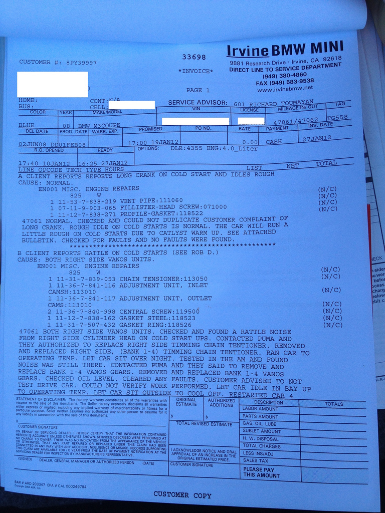

Exactly !
Here everything about the cold start clunk noise => http://www.m3post.com/forums/showthr...ight=LIMITLESS
And the "Puma case" (paper) shows the ultimate fix for it , and "Vanos Gears" are not cheap...
