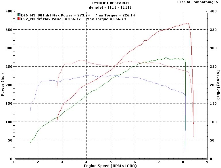

I've dyno'ed my car with M1 0W40, the chart looks like any other chart from Dynojet, the engine makes power all the way to redline, flat torque curve after 2500rpm or so.
My car made 357hp/262ft-lb on a 104F day here in So. Cal.
I keep on telling myself with a tune/test pipe/lower temperature, my car could be pushing 400whp!!

Your dyno flattens out at top

it only appears so because all three lines are so close together.
Here's another one from EAS

Yeah, it does make it difficult to tell. Not sure if its anything at all. I was comparing to this:

well..I guess I have a lifter problem LOL....not switching back to 10W60 though
**all S65s sorta flatten out a bit after 7000RPM**
