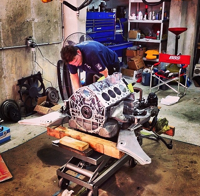

The Engine Builder
We're blessed here with a BMW master tech and brilliant engine builder. Cory Prime of Prime performance is a BMW master tech and brilliant engine builder. His attention to detail is outstanding and the quality of his work is superb. Cory believes like I do that in order to be the best, you have to build the best and use the best parts. That's why he insisted we get all the best parts and send the engine to the best machine shop.
[IMG]http://www.bigdynodatabase.com/DynoG...77-M33VT3.jpeg[/IMG]
Machine Shop and everything else.
To finish the parts, the geek hooked us up with a custom head gasket, and high performance valve springs. We bought the rest of the engine hardware, gaskets, and everything else on our end. Then we built the motor.
We used the best BMW machine shop we knew. We stripped our block and sent it to Dinan in California for boring and honing for the new pistons. Once the pistons arrived, Dinan measured everything and created a custom bore with proper clearance for our supercharged application.

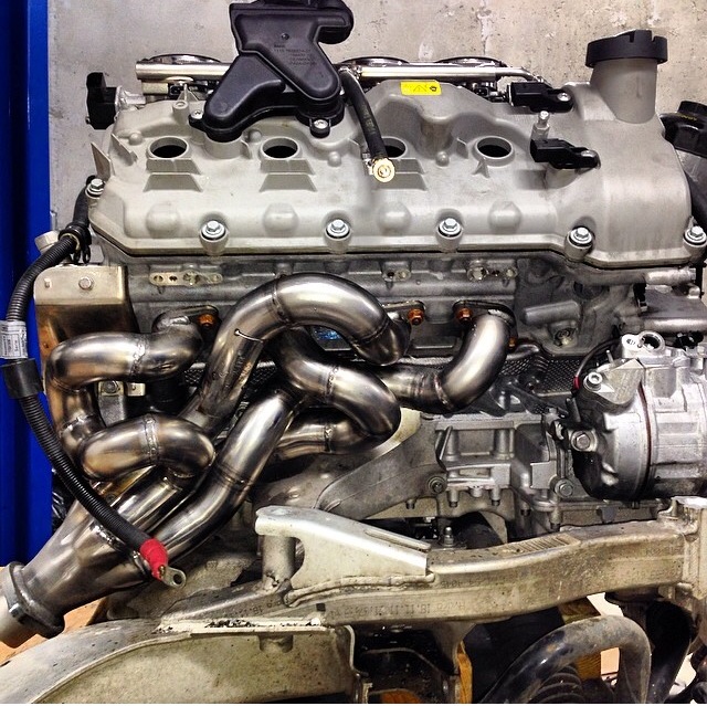

Auto Couture Motoring built a custom set of larger tube headers.

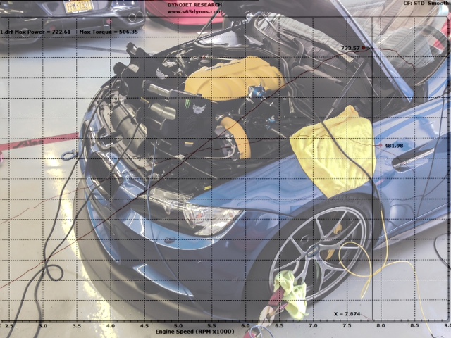

[IMG]http://www.bigdynodatabase.com/DynoG...87-M33VT3.jpeg[/IMG]
Car and Modifications:
  • 2012 BMW E92 M3
  • 4.4 Liter Low Compression Supercharged Stroker
  • ESS VT3 Supercharger hardware
  • ESS Catless XPIPE
  • Both CAT Delete
  • Meistershaft HP Exhaust
  • 97 Octane
  • DCT
Conditions (Dynapack Weather Station):
  • Temperature:: 69.08 degrees F
  • Atmospheric pressure: 29.41 inHg
  • Humidity: 32.00%
  • Density Altitude: 1356 Ft.
  • SAE Correction: 0.993
  • STD Correction: 1.018
  • Uncorrected: 1.000
Results:
  • SAE Corrected: 708 whp @ 7860 RPM, 495 wtq @ 7180 RPM
  • STD Corrected: 725whp, 507wtq
  • Uncorrected: 713whp, 498wtq
Dyno Database:
Graphs:
STD Correction: 725 whp, 507 wtq
[IMG]http://www.bigdynodatabase.com/DynoG...236-M33VT3.jpg[/IMG]
SAE Correction: 708 whp, 495 wtq
[IMG]http://www.bigdynodatabase.com/DynoG...755-M33VT3.jpg[/IMG]
Uncorrected: 713 whp, 498 wtq
[IMG]http://www.bigdynodatabase.com/DynoG...399-M33VT3.jpg[/IMG]

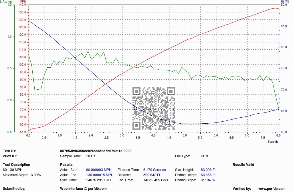

On my first run last night, I tied the world record: 60-130 in 6.179 seconds
[IMG]http://www.perfdb.com/vBoxFiles/ID00...060-130MPH.jpg[/IMG]

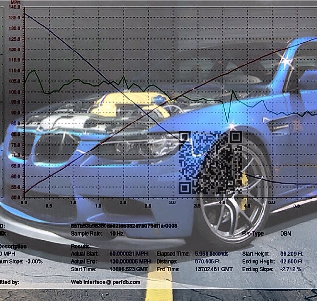

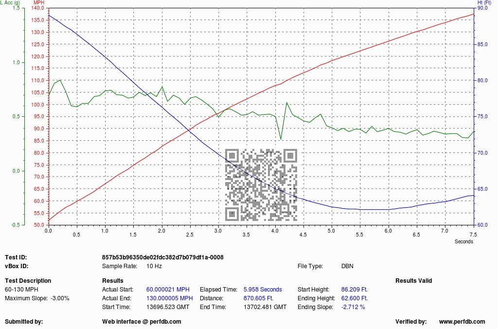

On my third and final run, I became the first and only E9x to break into the 5's for a new world record: 60-130 in 5.958 seconds
