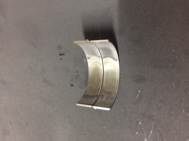

Originally Posted by 08 E92 Jerez Black View Post
Is there anyone working this that is gathering specs from rod bearings pulled out of engines? I have the ones I pulled out of my 08 e92 M3 six speed with 87k Miles, and even though I would want them back (in the event I have problems with the Main bearing in the near future) I would be fine with shipping them to someone that is accepted as an expert that is already gathering the info and that BMW might take seriously. this is a street car that didn't see track time and is pretty much stock (no supercharger) the pic is showing the number one (left) and number 8 (right) upper bearings (piston side) all eight looked the same.
Attachment 1194833
This data has been collected in the Bearing Wiki thread. I used to have people ship me their bearings and I would measure them. But I quite doing that because it became too much of the same old thing and nothing new (no new or interesting measurements) was coming out of it. So feel free to post the pictures in the bearing wiki thread, but I'm no longer having people ship them to me for measurements.
http://www.m3post.com/forums/showthread.php?t=892838
I replaced them with treated bearings and stock rod bolts (not ARP) from Bimmerworld. If I was planning on doing a supercharge I would have pulled to line bore the rods before using ARP since I have always been taught that you have to since ARP grabs so much better it will actually throw rods and mains out of round.
It turns out, the factory rod bolts actually have more clamping force than the ARP-2000 or APR-625 rod bolts. The ARP's are better bolts, but still clamp less than factory. As a result, the ARP's do deform the rod big end bore as you expect, but not because it's too much clamping force, but in this case because it's too little. I will start a new thread soon with all of the measurements and graphs for rod bolts.

maybe I missed it but what about the engines with bearing replaced where the bearings looked horrible? After this whole bearings issue (or not) was brought to light, it seems quite a few people have done the bearing replacement before the engine failed. From some of those pictures, it's pretty safe to assume that some of those engines will most definitely failed if the bearings were not replaced. Are we counting those also? Is the data representative to exclude them or should they be included in the chart as a separate column as well? Thoughts?
Attachment 1194833
Just a question:
You bought the car brand new or used?
If used to say it upfront...you can't asure of any fact regarding driver operation be it supercharging, track beating and general abusing.
With that said...now that you watch and baby the car doesn't automatically mean the people before you did. Just saying, so that noone get's the wrong impression about the S65.

I bought the car used from my best friend, who has an e46 race car that he races at thunder hill in the 25 hours of thunder hill, he drove this car for pleasure, the only change he made to the car was new rims. He knew the owner before that one. So I do know the life of this particular engine. I know it never set foot on a track, was never supercharged. I know the drain pan was immaculate when I pulled it, it had almost no carbon or any other crap in it. In fact I barely had to degrease it and it
Looked new after I was done on the inside. My intent is to try and help others with issues, and in my engine builders opinion these rods should not look like this at 80k.

So what are you implying here, you seam dead-set on the idea that the these Motors could not have a have a potential weak point and that the only way this could happen is that someone beat on the cars? Why then did BMW loosen the clearance on later year motors? Why are there examples all over the blogs of motors with less than 20k miles with
Spun bearings? My intent is to help, I did the
Bearing service myself because after reading for a week that there or more than the expected number of owners with rods sticking out of the sides of blocks, spun bearings and the dreaded "knocking sound" coming from my engine posts that this was a project that
Might not
Be 100 percent necessary but seamed like cheap insurance if they where valid. And sure enough I pulled 8 great examples that
Looks identical to most the pics I saw of the
People that dodged bullets themselves. I don't have the cash laying around to
Build a motor so I'm a happy guy. One other thing, how many other cars do you know of that have multiple companies selling hardened and coated bearings for stock replacement?

This Worldwide problem allready exists from previous ///M5-6 with the 10 cyl. engine , and our S65 is actually the same engine with 2cyl. less !
But with the same problem , and I'm talking from about 15 years ago !
In other words...The S65 bearings are f@cked up by BMW and Worldwide !
I knew this from day 1 , and that's why I'm almost paranoia when I start my car and listen after ticking or rattle noises every single time !
That's why I receive also videos of S65's to listen ...and that for people from all over the world .
Because I just know what could happen at every single moment...and I've learned the last 3 years how our S65 "not" should sound.
I've some numbers (inside ///M numbers ) and I can tell you that they are shocking !
So please don't tell us that nothing is wrong with the bearings of our S65..
