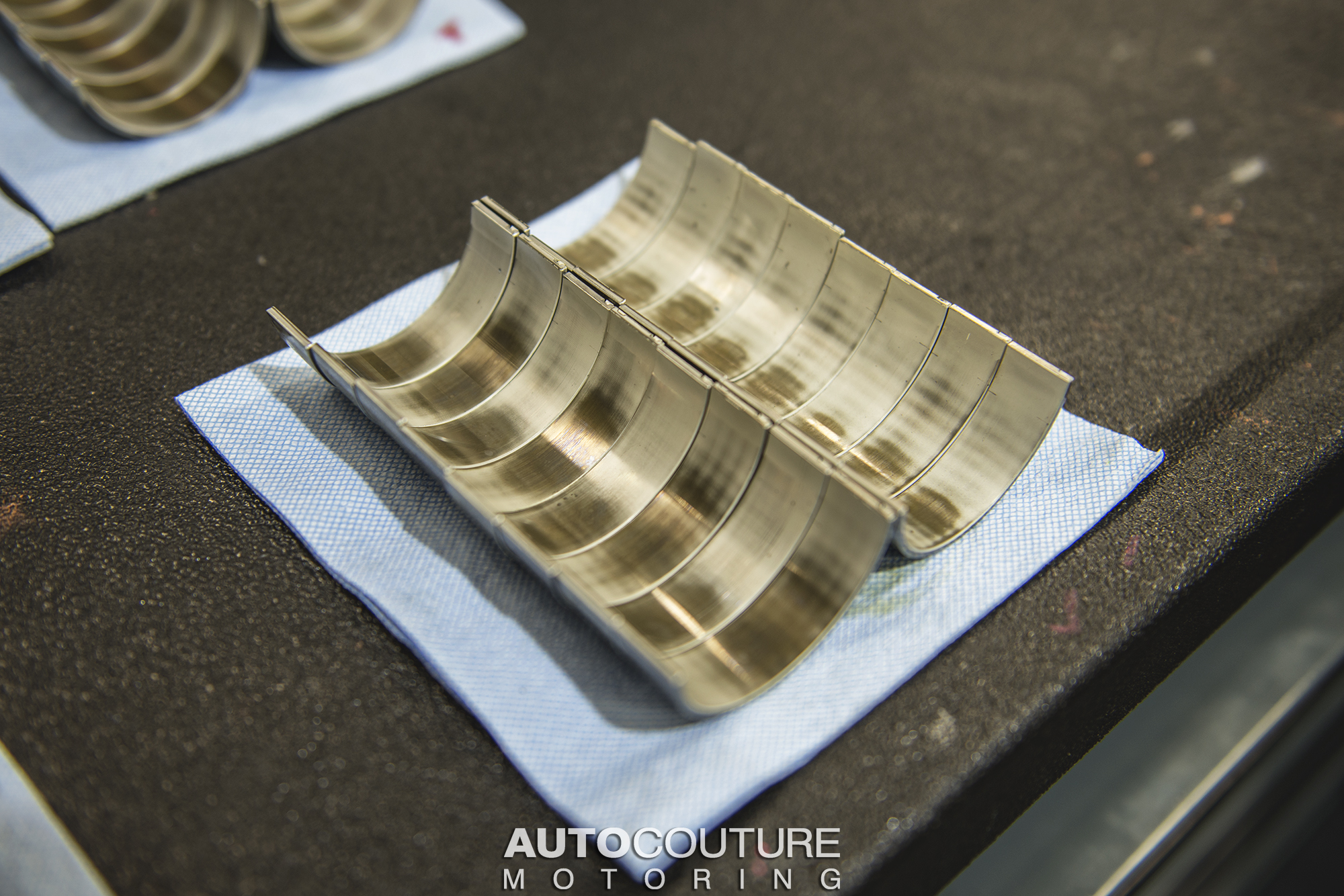

Originally Posted by deansbimmer View Post
A couple from the last week.
The 92k 2011 set had the 088/089 bearings and some wiping evidence towards the rear journals that we don't usually see on the lead bearings which was interesting.
Curious about this car. To my knowledge the (or a) previous owner had a new motor installed due to a prior failure and this one only had 45k-ish miles on it... Interesting to see the wear knowing that about the car.
2013 3rd owner 39,984 got them done today.

Originally Posted by Lito335 View Post
Attachment 2281425
What was the report, looks worn.
Attachment 2281425
Interesting, I recently had rod bearings replaced on a 2011 with 75k miles (5 owners) and they look a lot less worn than that.....goes to show that having low mileage doesn't guarantee that the rod bearings will be in better shape. I'll post pictures soon.

09 M3 DCT @ 93,287mi.

Oh, you hate to see that.
What was the state of the crank on that car given the cyl-6 damage?
There were very light markings on the crank, but surprisingly not as bad as compared to the bearing.

Man!! That was scary!!
Seems like a miracle that nothing bad happened.
Isn't it possible that some particles went to the mains?

This post should have come with a warning! That bearing looks like dog 💩!
The connecting rod bearing is the last pressurized oil contact point before it is slung into the pan, so no! Main rods lead to con rods, not the other way around. Ever get a black stone report over the last two oil changes?
