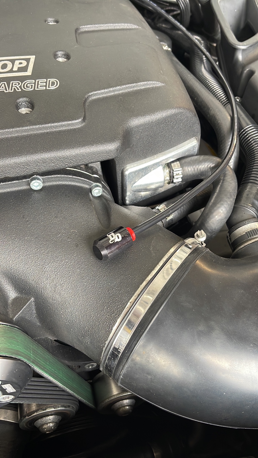

I’ve been running meth/water pre the blower for a little while now. Second pic shows the nozzle. I have a 14 litre tank and pump in the rear seat delete area. The pump turns on at same time as the secondary fuel it pump I run controlled via syvecs.
It seem to keep the temps ait right down as it cools the rotor pack whilst cooling the intake charge. I like to watch my p3 gauge and it really stops the massive heat hike and also brings it back down from a higher temp very quickly after coming off throttle.
Added a pic of me on track recently also..
Done probably 500miles or so, I recently have taken off the intake and checked the coating on the rotors and it’s fine so far. It will eventually remove it but it’s a non issue.
Keeps the temps right down as it cools the rotor pack whilst cooling the intake charge.
AIT is simply not an issue atall on track so far.
Done provebly 500miles or so, I have taken off the intake and checked the coating on the rotors and it’s fine so far. It will eventually remove it but it’s a non issue.
Please share IAT data relative to RPM (assuming you’re spraying volume based on boost), and the general weather for the track conditions.
Max ait temps seen 48c on track. This is flat out driving obviously not spirited road driving
Blue is rpm and white is air charge temp.
I was seeing close to 70c on last trackday without it, no logs though unfortunately, it was a much hotter day tho but it doesn’t make massive difference to overall ait.
The nozzle sprays at 4-5psi boost same as the secondary fuel pump.
Nozzle size is 640cc and is on or off, not progressive like some.
Edit just added another pic, this shows how frequently the water injection is coming on (red areas), road driving the injection doesn’t come on hardly at all of course.
What was the days air temp?

DRLane Low teens centigrade. So around 8-10c less than the previous track day I attended.
I should have done a run without the injection on but just didn’t think to.
It makes a huge difference, it was evident as soon as I start using it on the road let alone the track.
The rotor pack is coolish to the touch after thrashing it.
DrFerry10035.50
Low teens centigrade. So around 8-10c less than the previous day.
Yeah - Maybe it was making a small improvement, but that’s likely compounded by the low teens temps. Try this when it’s > 30° C and I have little faith this does anything.
Is this Syvecs ECU logger software? Looks cool. Did you upgrade the IAT sensor to what Gareth recommended (threaded Weber?)
Thanks for sharing man!
Not sure what the threaded Weber is in all honesty.
The programme is s view, the display programme for the data logging feature of the syvecs.
To reclassify the difference with water on or off is polar opposites.
I will try and do a run with it on and off on same day.
It stops the heat climbing nearly as far and then recovers really fast as you decel
I tried this with varying nozzles, and boost levels and couldn’t get a material impact on track. When it’s < 20°C I generally wasn’t having issues anyway as the cool ambient air was a huge power improvement.
If you’ve found success then that is awesome! I’d be excited to explore it again in the future.
Here in Colorado USA, we’re high altitude and very dry heat. So most cooling efforts and or strategies are put to the test.
Keep us posted as you experiment.
It’s well documented that it works, however you need to have a issue with heat in the first place for it to be able to do anything and take heat out.
What platform were you doing it on? Was it a charger?
Doing it before blower should have a pretty drastic impact as the intake air doesn’t get scorched up to temp from the hot compressor blades, and once the meth is past the screws it aids in cooling the charge coolers then the actual charge itself.
Also worth noting: My charger is spinning faster than oem kit as running the larger main pulley, this in itself will create more heat.
I’m also on a Harrop running 9psi. We spoke offline about the Syvecs a while back when you got their stage 2 tune. My car is fairly built track machine.
You’re over-indexing success in very tame conditions. Again, I do not think this would do anything in hot ambient conditions.
Yeah I remember, so your saying you have experience running the meth through the blower?
Time will tell how effective it is in summer, all I know is it rises a bit but caps the hike in temp unlike without, and as soon as you decel it quenches the heat that’s been added very quickly.
