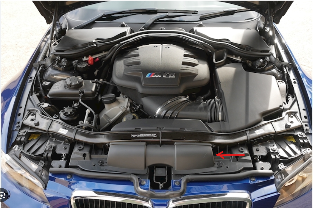

Originally Posted by averagejoe View Post
Nobody else running stock 18" wheels? 245/265 PS4S here. Wheelspin through 3rd but I find that fun when I'm not racing or trying to set a time.
BTW on the intercooler bleeding thing, I know that my shop who installed it knows what they're doing, but I guess I'm wondering whether the gurgling noise I hear when the pump is running with engine off is a sign of a problem or is just what it should sound like?
You should hear fluid flowing; I hear no gurgling on mine. Assuming your reservoir is filled up to the bottom of the inlet lines just below the cap (which could be the other source of noise), sounds like you have air in the system somewhere that needs to be burped. I seem to recall going through a couple cycles making sure the intercooler was free from air on my install but for the most part the installation doesn’t allow for much air trapping. But there’s a possibility your shop ran a line in a manner that created a P-trap so to speak where air could collect. Also check all your hose clamp fittings, the ones that come with the kit can vibrate free if installed incorrectly.
Thanks! I'll investigate those points and try to identify exactly where the noise originates. I downloaded the install manual and found the bleeding instructions, looks straightforward.
I found that you had perfect access to the air bleeder if you removed the duct in the picture. Two torx screws and two clips and its off. Gives enough room to get a 10mm box end wrench around the bleeder and acceptable room to turn the wrench. Not bad at all really.
That was very helpful, thanks!
I tried to bleed the system but it didn't appear to have any air in it. So I started up the pump cold, and I could hear what sounded like air moving through the system, seemingly somewhere down around the pump. I then drove the car far enough that it had ample time to fully warm up - including some high-rev shenanigans - and when I arrived at my destination, I popped the hood and ran the pump hot. To my surprise, the sound of air in the system was completely gone, making me think the air may just collect when the intercooler circuit cools to ambient, and then works itself out as it warms up. In any case, I can't detect anything negative in performance of the car.

I should probably clarify I don't think air is "collecting" in the system but rather moving around. As in maybe it rises to the top (reservoir) when it comes up to temp. I dunno, best hypothesis I have.
