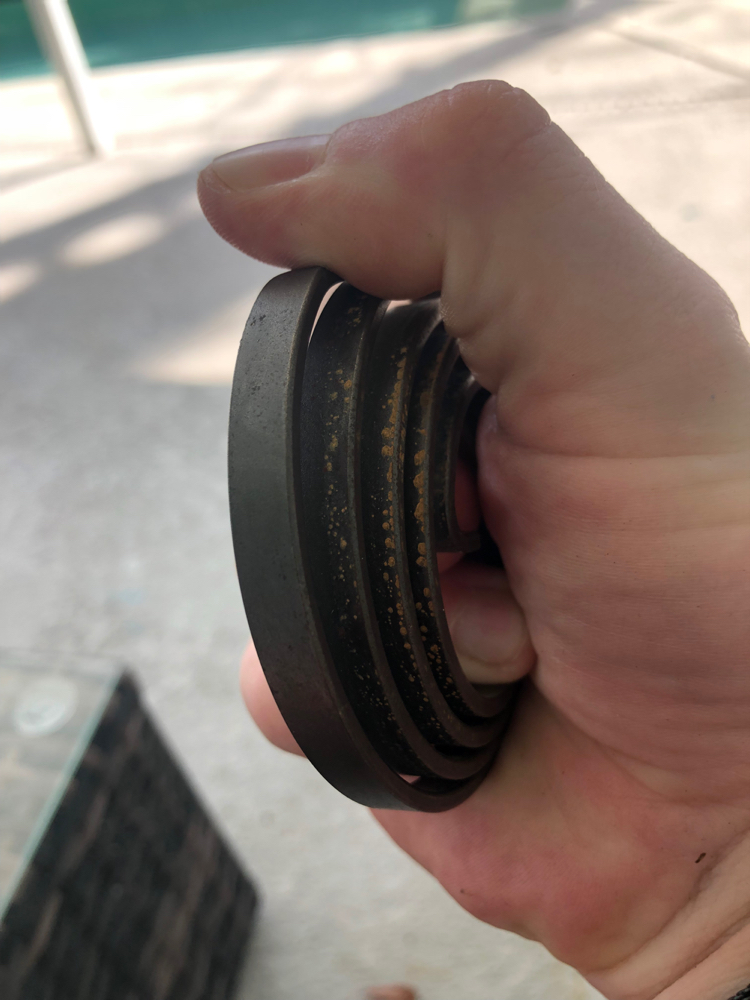

You're welcome, my pleasure really!! There wasn't much public info on this so I (and Ethan too) feel like trailblazing this for the community, learn as we go kind of thing. I got the used (disassembled) unit off eBay for a just a couple hundred and at the time I was down a cover (thanks for nothing FedEx) and through it was necessary at the time.
An aftermarket solution still may be viable, I really don't know. Im just assuming flimsiness and looser fitment is not as ideal. They could go the mileage, just not sure at this point.
Yeah there's a tab on the cover that goes perpendicular to the other tabs that I believe aligns it to the gear; proper orientation. Looks like yours has spun and is protruding out. I would make sure the other sides are engaged. Purely speculation, but I think 4 out of 6 tabs engaged is still pretty safe all else equal.
And the CarBahn is only for peace of mind; same with RBs.

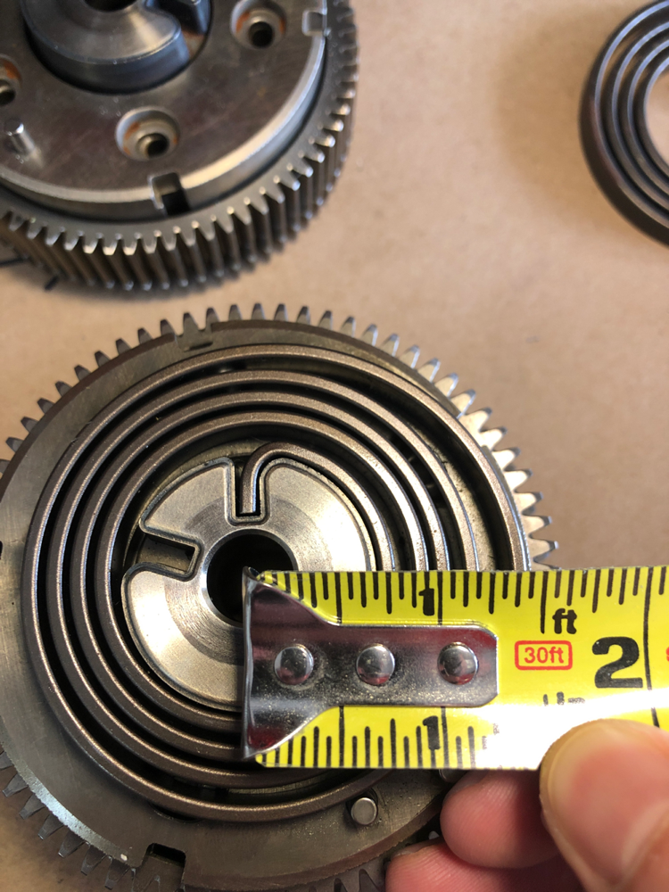

Ajolives Since you have the gear, would you mind taking some measurement? How much of the spring would a washer with OD 58mm cover? Wonder if these would work. < $5 a pop compare to $40?

Sure, 58mm is roughly 2 1/4 inches, so radius of roughly 1 1/8 inch puts you right about there.

Yeah the 58mm looks sufficient. If you retain the center and 2-3 revolutions of the spring, I highly doubt the outer edge will walk off the gear. Remember its held on by spring tension and a clipped on plastic cover.
As for thickness I'm thinking 2mm will be sufficient also.

Ajolives Thanks for the measurement. I think the 58mm should work also given the spring is radially wounded so that last strip shouldn't be able to get onto the other edge of the washer when the rest of the spring is covered. What do you think given you have the actual gear and spring to make the evaluation?
I couldn't find anything thinner than this one at 6mm unless maybe go custom. I found a titanium one that's 20mm thick actually, haha. Maybe other member that has connection with a machine shop can work or look for some solution?
Were we able to confirm that the bolt does or doesn't have a washer attached already? If it doesn't, then maybe the 6mm thickness doesn't matter?

No problem! The spring itself isn't very strong laterally, I can manipulate it with my hand in the awkward picture below. If flimsy plastic can (arguably) keep it in place for 10s of thousands of miles any thickness washer would probably have no issues keeping it in place as such.
My only concern would be warping or breaking caused by heat, so I'm personally not sure how well an of-the-shelf washer would do in those conditions. Could become brittle after continuous exposure to operating temps. Not sure if there's any experienced engine builders who could chime in on that. A bit out of my circle of competence…..
Edit: and yeah I have a bolt with no washer attached in the pics I took yesterday. I have the part number right next to it. I believe I got them from ECS or turner, couldn't remember which.

Originally Posted by Pedalkick View Post
Been following along with the washer solution and wonder about the balance/weight and securing to the camshaft. The cams can spin up past 4K rpm and the washers are heavier than the plastic caps. Potential vibration due to imbalance of metal washers might be a concern. Also using the gear mounting bolt to secure the washer to the gear could be an issue. The only thing preventing a washer from spinning wrt the gear is the clamping force of the bolt. I would imagine the cams experience some accel and deccel loads that could potentially let the washer spin or even loosen the bolt. Not saying there is a problem as Dinan and others have been using them OK I guess.
Yeah those were my original concerns with the steel plates. Also making sure they're centered on the bolt too so it's not lopsided. The center bolt torque is no joke, I'll ask around if a modified torque value was used for the Carbahn plates. I would imagine it's the same but like you said it's more mass being kept in place.

I actually have a few other questions and concern as well. As others have mentioned, being able to center the washer is key given that it's heavier. 4k rpm is pretty high too. With more mass, if there is any imbalance on the washer, would it cause more wear on the cam teeth, or the first camshaft cap area long term? Do we know if the Carbahn plates are balanced?
The other question is for Ajolives actually. Is there any room left for the spring to move if this big washer is put on there or it will squeeze the spring a bit? I can't tell from the pic if the platform for the washer/bolt extends further out than the width of the spring. Thanks again for helping answering these questions.
Was just gonna ask this same question - will a flat steel washer press down on the spring when installed, preventing the spring from doing its springy stuff?

I'm also trying to source for 60mm x M12 x 2mm washers made in Ti Gr2. They would need to be custom made. Will update if I find a supplier.
However, Ti Gr2 is lighter but not as strong as stainless steel. It's a common material used for washers tho.
@Redd lighter would be better if we have concerns about balance? If it's custom, how much extra it would be to have a little lip on the inside to ensure it is centered on the platform (for a lack of better term)? The concern I have with titanium is, from experience, all the titanium bolts that I use on my bike, they require retightening after initial use to retain their torque setting. Gr 2 is softer than Gr 5. Would that be a concern here? Although that bolt torque is pretty high at 80 Nm with 270 degree (2x).
1. 60mm won't cover the whole spring, so it would need to be flat. Also, to add the lip would be a significant cost increase cos material would need to be machined out from a block of Ti, vs a round flat washer which can be cut out of a flat Ti plate. Anyway I haven't managed to find a supplier yet...
2. Good points on bolt torque and hardness. I'm by no means an expert on materials so will defer to those who know more. But Gr2 is a more common material for washers. Gr5 is available as plate, but it will all depend on the supplier/machine shop how they intend to make it.
If that were an issue, then it would be an issue for the VANOS too. The VANOS is not splined and is only held in place by the pressure of that bolt. There's some good reasons for that.
