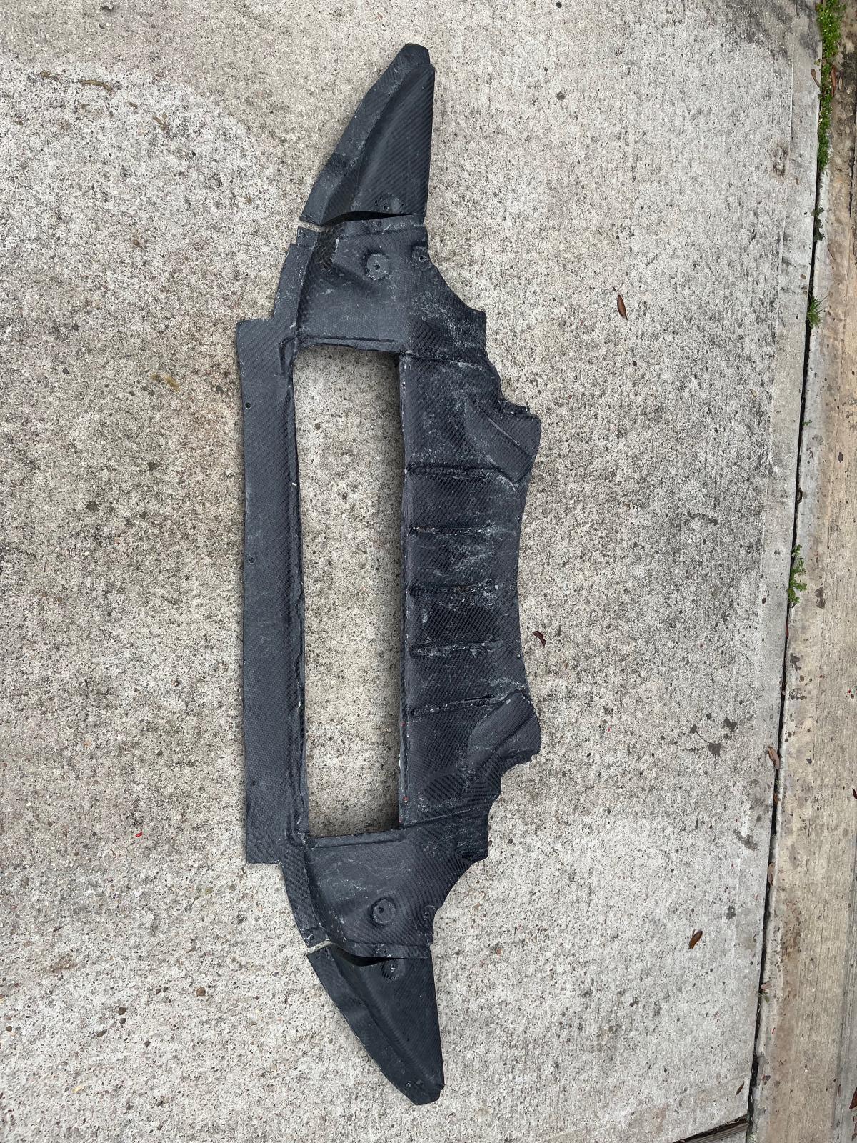

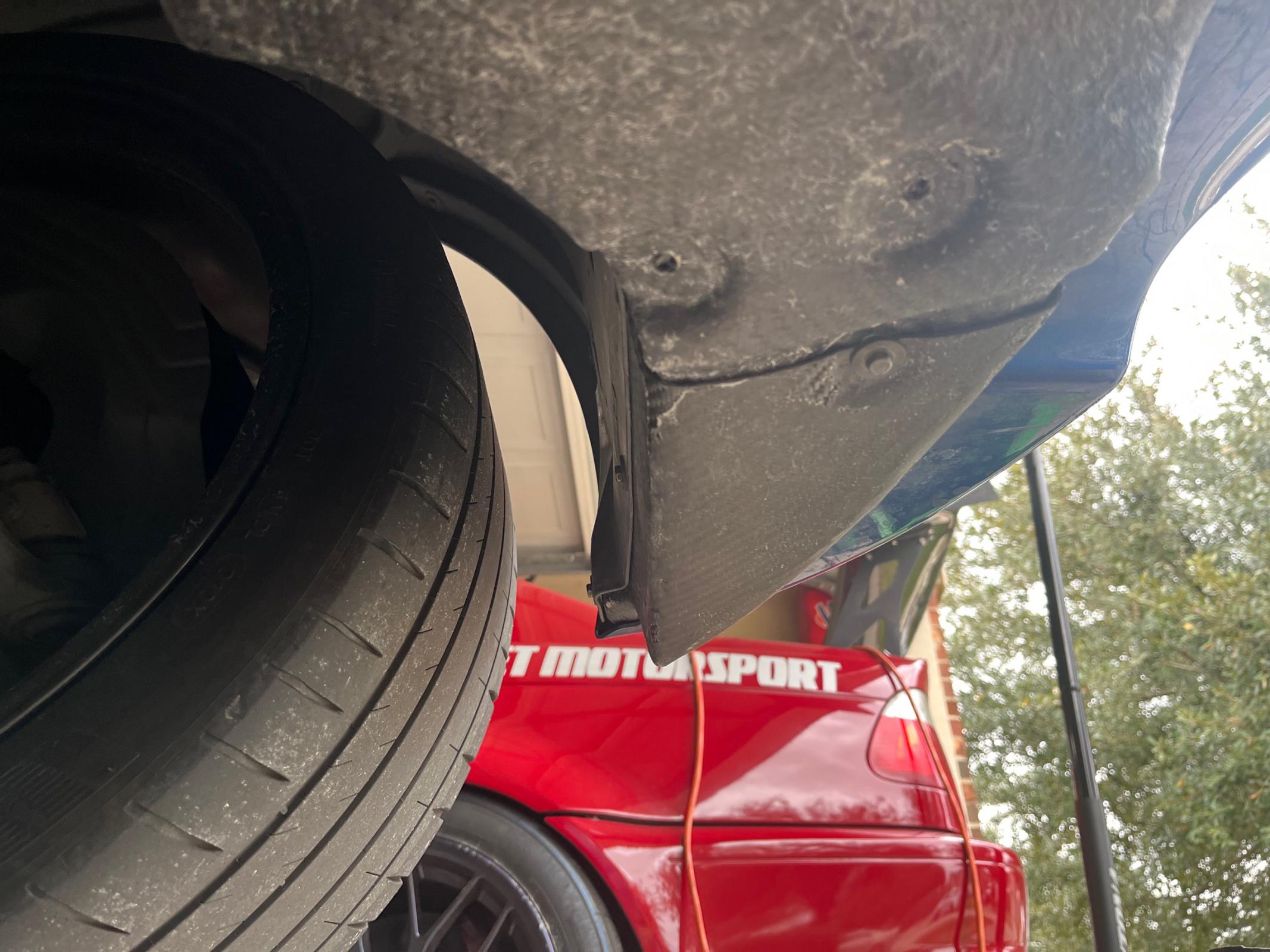

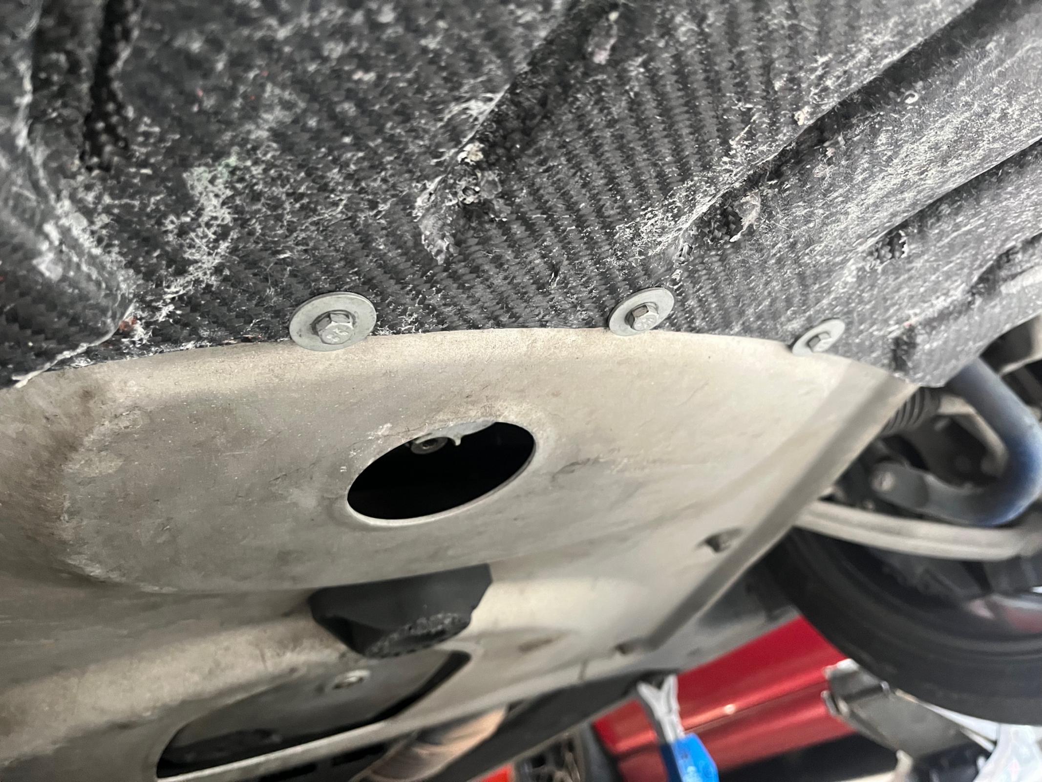

Crappy engine covers V1 test fit. It fits!
Still need to do the vent. Had a minor mold issue so I’m waiting for more gel coat.
It’s more difficult to install because it’s stiffer. Had to wrestle with the wheel well liners a bit. And no bowden cables!
And the white reside is mold wax.
