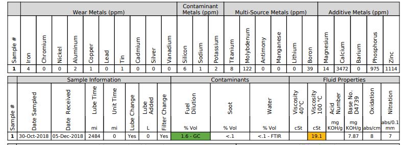

E90 M3 Post MRF RB Svc-Castrol Supercar 10w60-2,500 Miles
My apology for the delay in posting this one, got busy and forgot. Sample was taken 10/30/18 just under 2.5K miles after MRF (Malek's the man!) did my rod bearings when the car had just under 40K miles. Nothing much to see. Car was driven back from MRF in SoCal then used for commuting and one track day. I have switched labs to get an actual fuel dilution test versus statistical assumption as well as Oxidization and Nitration. Note the decline in Titanium versus prior Castrol revisions. This may just be washout from the prior oil, which was Castrol Edge Pro and Supercar is no longer using it as part of the adpack. Also, I could be wrong but I think Calcium, Zinc, and Phosphorus are up going back to more old school like LM. Final thoughts on Castrol are that my VANOS noise is more prominent versus BMW branded Shell, it runs cooler on the track and street, and consumes much less oil.
