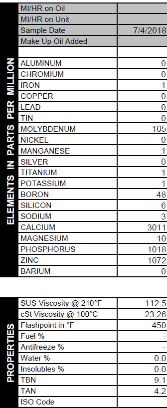

I was curious about the final viscosity of this oil versus the others given the too thick discussions.
      07-16-2018, 07:48 PM   #949
dparm
Stop the hate, get a V8
dparm's Avatar
3928
8,631
Join Date: Jun 2013
Location: Frisco, TX
Looks to be right in the middle for a 10w60 -- most are 23-25 cSt. TWS is 22.7 and the BMW (Shell) stuff is 23.2, for example. Starting TBN looks typical too.
I'm sure it will be fine.

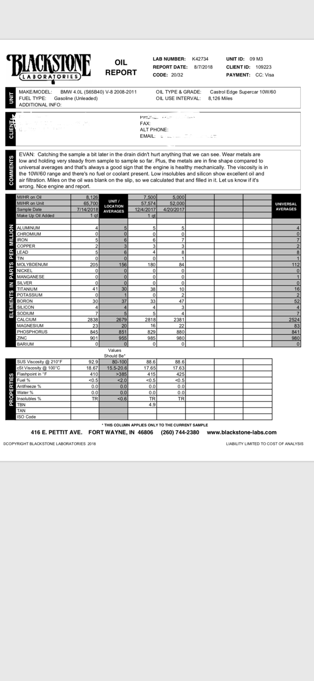

New report.

Originally Posted by tigermack View Post
New report.
Aluminum up slightly, iron about the same, copper unchanged, lead down slightly = not too bad overall. Consistency is what we want, like Blackstone said. Viscosity still in grade, flashpoint okay, and no contaminants.
The TBN and TAN are equal which isn't really ideal, but I agree you should try a slightly longer interval and see if that causes TAN > TBN. Do you do a lot of short trips? What's your driving style?
I would consider this a good report and the start of a reassuring trend. The next report should be very telling.
Not that many short trips, minimum 10-15 mins when I drive. I sometimes go to store to store after that, does that matter? Most of my driving is on the weekend, I would take it to above 6-7k RPM occasionally like on freeway merges. I do autocross events as well, maybe once a month to two months in this car. I do plan to do the RB's at the next change, or should I try pushing it a little longer?

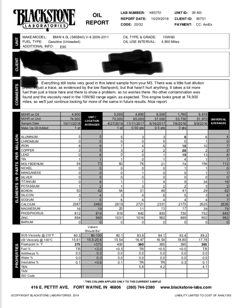

My report...been trending since I picked up the car.
Looks pretty good -- no major deviations from your previous reports.

Si - 2
Mo - 45
Ni - 1
K - 1
Additives:
Mg - 726
Zn - 1056
Ca - 1216
P - 847
Cheers guys.
