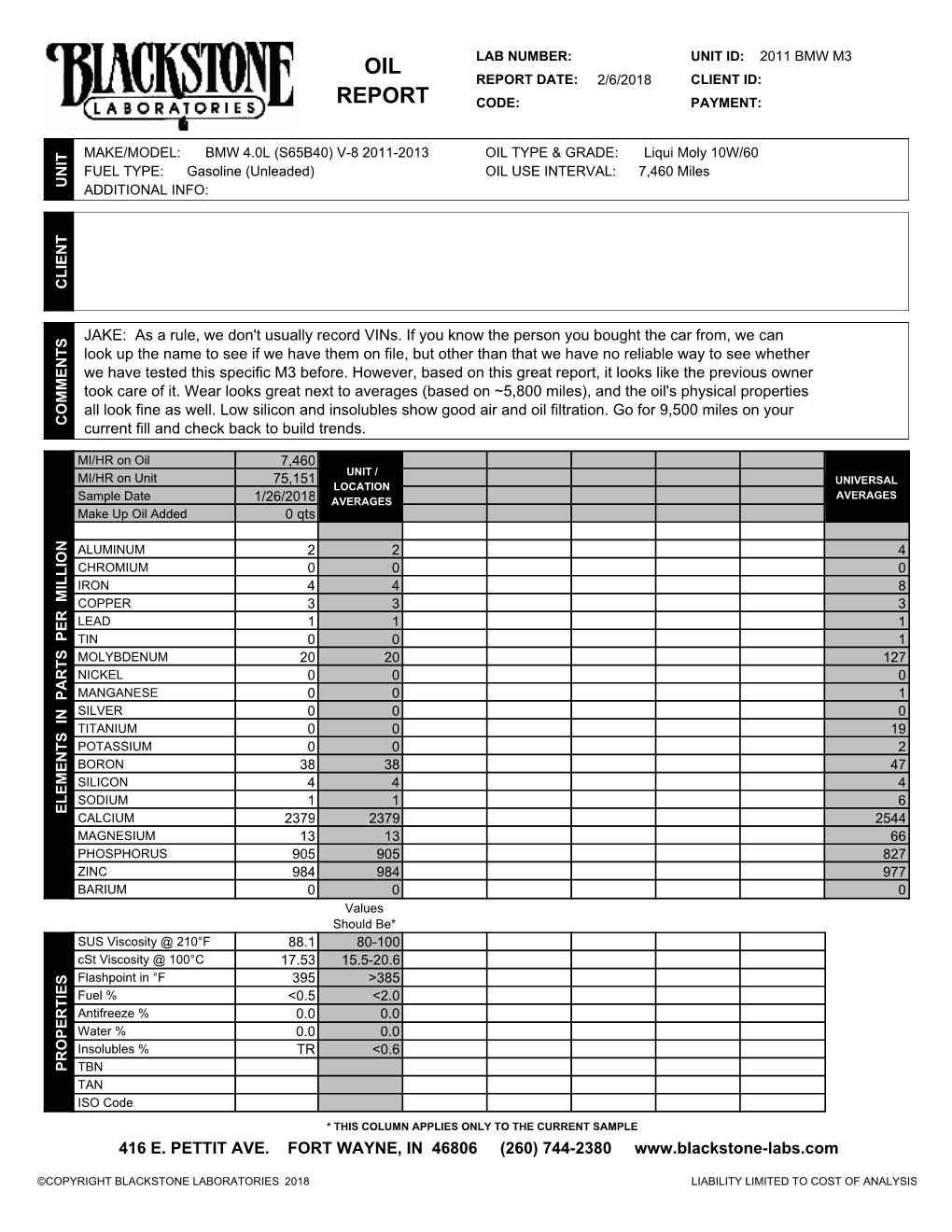

Bought my 2010 M3 used with an extended warranty which is about to expire. So wasn't too worried about Rod Bearings until now. Just had first oil test done which doesn't look good. I do track the car regularly.
What do you guys think? Try and extend the warranty? Replace the rod bearings? Trade-it in for something else? Or just roll the dice and keep driving :-)
      01-26-2018, 02:36 PM   #882
pbonsalb
7679
13,758
Join Date: Feb 2011
Location: New England
Do something and do it sooner rather than later. I’d just replace the rod bearings but if you want a different car, sell the car and put the proceeds plus the rod bearing cost towards the new car.
Extending the warranty would also work but if your motor blows up you could be without the car for months while it gets inspected and the company haggles with you and eventually the repair or used engine gets done.
      01-29-2018, 01:39 PM   #883
byroncheung
192
593
Drives: e90 m3, 997.2 c2s, x166 GL450
Join Date: Nov 2014
Location: Westchester, NY
if it is my car i'd just replace the RB... but then you'd still have to decide what replacement to use... which is not a easy decision to make...

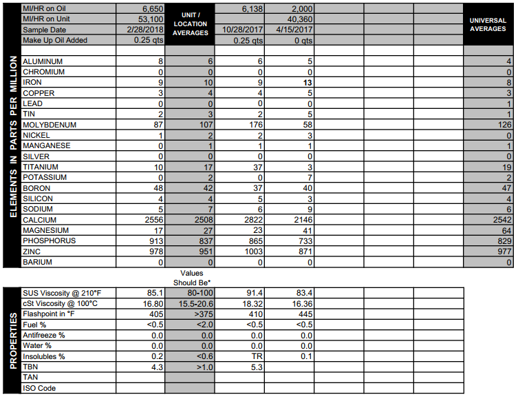

Good report this time around...and I like the 7-8K mile interval...as is recommended anyways.
The engine runs as smoothly and strong (if not better) since purchase.

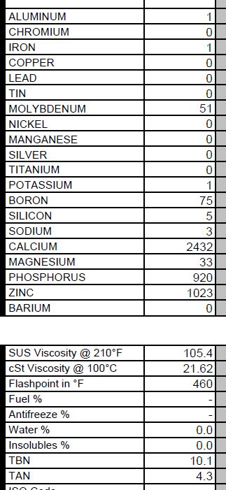

BlackStone Oil Report - Need some advise
I need your guys opinion on these reading..
      03-16-2018, 11:43 PM   #890
N52 Moistenor
N52 Moistenor's Avatar
20
59
Drives: 2011 528i RWD
Join Date: Mar 2018
Location: Toronto
what oil and weight are you using?

Need another analysis to develop a trend and more data especially if you don't know previous owner's maintenance standards

Iron is definitely high. The highest I've ever registered was 7ppm on 7,000 miles of Castrol Edge 10w-60.
The bigger surprise to me is the 0 for lead (rod bearings). That's pretty much unheard-of, and spectacular news.
For reference, my most recent report, which just happens to be my best to date:
My Molybdenum is super high as a result of running Cera Tec, which I started using ~25,000 miles ago.

The iron is abnormally high, yes. I would suggest pulling a sample after a few thousand miles and sending it in for analysis -- could be something like particle streaking which causes false positives.
As others have said, it's one report in isolation and is of limited use.

      03-17-2018, 05:02 PM   #897
Droptope93
35
22
Drives: 2013 E93 M3
Join Date: Oct 2017
Location: NY, NY
Like you said I think I'm just going to ride it out for the next 4-5000 miles and see what readings come up. Thanks

      03-17-2018, 05:56 PM   #899
roastbeef
roastbeef's Avatar
11865
12,880
Location: Orange County, CA
2011+ cars have tin/aluminum bearings, so no lead.
Instagram; @roastbeefmike
kawstik828.50
Huh. The more you know.
