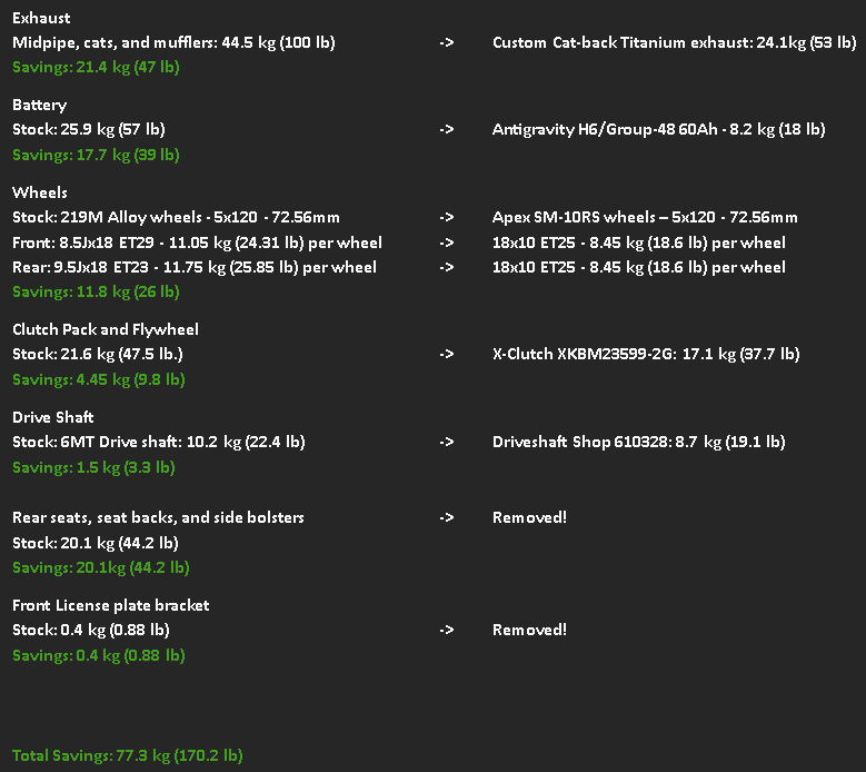

This is how much weight we've removed from the vehicle so far:
Name:  M3 Weight.png
I don't yet have data on the weight of some of the parts we replaced such as the Ohlins or the Eventuri intake but they should be a bit lighter than OEM.
Fusion is currently making a titanium rear strut tower brace inside the boot. The extra rigidity should make the handling even better.
Did I mention we got a short shift linkage for the transmission? Can't wait to try it.

exceptional build man.
I think all I have left to do is Carbon plenum, body panels and maybe a lightweight CF shaft and flywheel. I'm at the same place you are haha!

The exhaust is a piece of art and it sounds great. I appreciate your approach, which is to keep it from breaking windows on the street and in the car.
