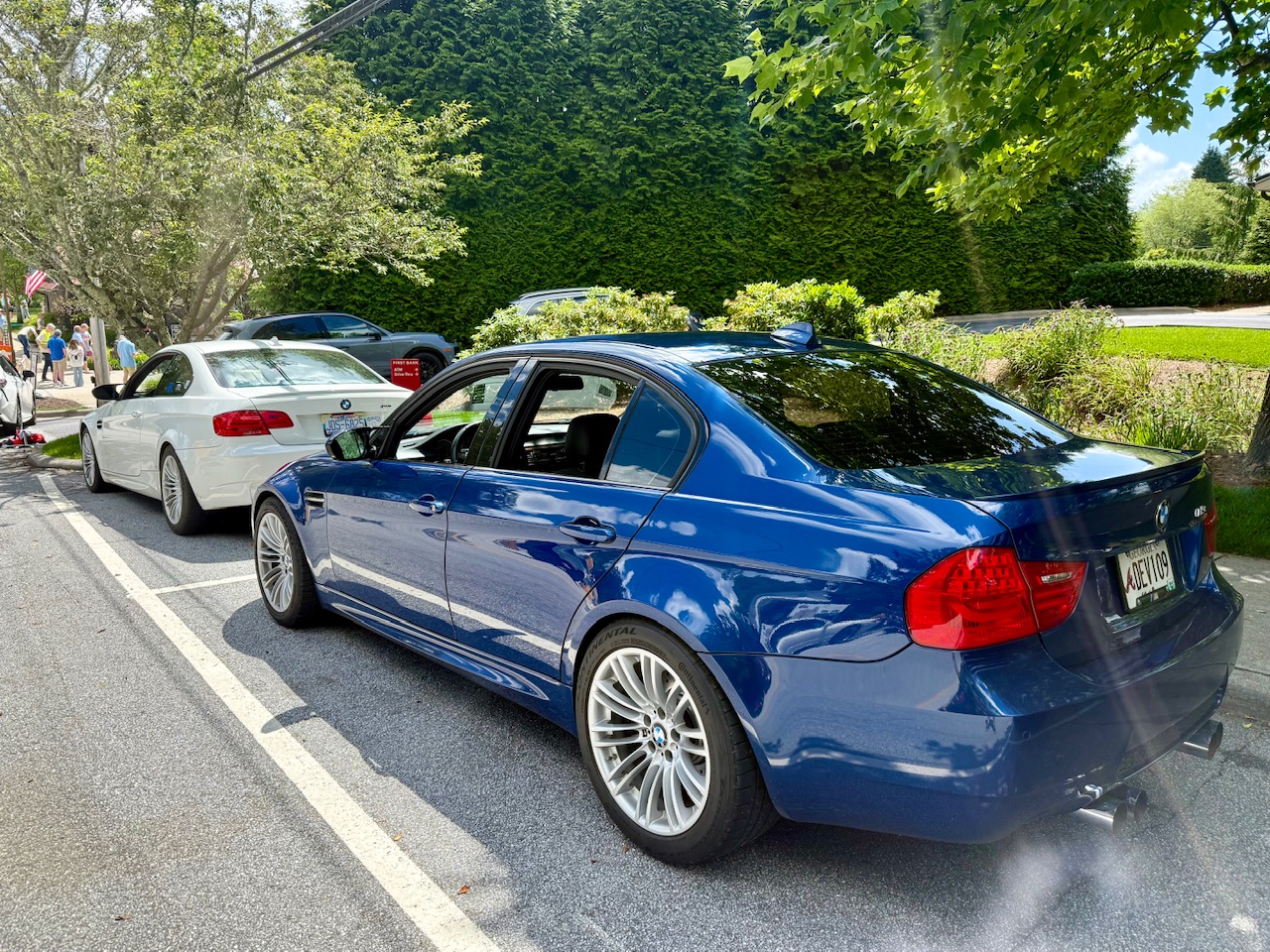

I ended up going with exactly as I had listed. May be the Continentals I chose, but they do rub slightly when turning up front on the liner. Maybe Michelins wouldn’t? BUT they only seem to do it after they’ve had some heat in them. Right out of the garage, no issue.
Attachment 3775342
Your car looks amazing, I'm sold!!
Thanks a lot, I'll pick up a 10mm spacer while I am at it then, since my 12/15 wont work.
Thanks! Perhaps 10mm front instead of 12mm would result in no rub? Right now I am 12 front/10 rear.
If you want to see a few more pictures, post #15 and onward in the link below show the car as it sits with 12/10. It's right at flush. I'm bad at updating the thread, but it shows the car sans current exhaust I believe.
