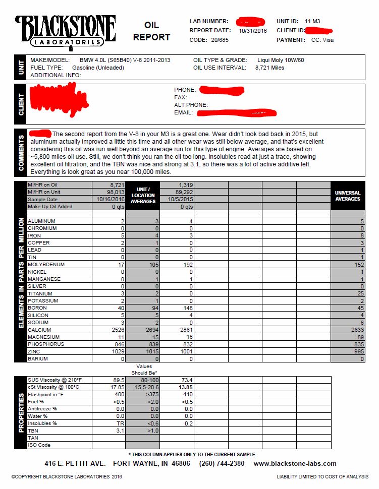

Just did my oil change a few weeks ago and got the report in today.
This is my first "real" analysis. The reason I say real is because the last oil change only had 1,319 miles on it. I did an oil change and did a rod bearing replacement shortly thereafter so I wouldn't read into the previous oil report.
I did rod bearings at 89,292miles. I switched to VAC/Calico rod bearings and ARP2000 bolts. Also switched to Liqui-Moly 10W-60 at the bearing change. The last year I've been commuting a short distance of 3miles each way so for the most part, the engine doesn't get to optimal temperature by the time I get to work/home. Oil sample also has 3 autocross events (12 laps per event).
Here is my bearing post: http://www.m3post.com/forums/showpos...&postcount=173
Does the TBN mean I can use this oil a little longer? I don't really plan on it as switching every 7.5k miles isn't too bad.

Nice report!
3.1 TBN means few thousand miles left in the oil, I'd go 10,000mi-12,000mi or change once a year, whichever comes first...
I'm jealous about you guys getting lower than average aluminum count. Mine are above average for 2 consecutive runs... Although looks like not high enough to call for action though... Will probably continue to wait and see...
My aluminum number right before my bearing change was 7ppm and my bearings looked like shiite considering 35k miles of use... iron was also 7ppm.
NFW I'd go 8k miles next oil change if I were you.
