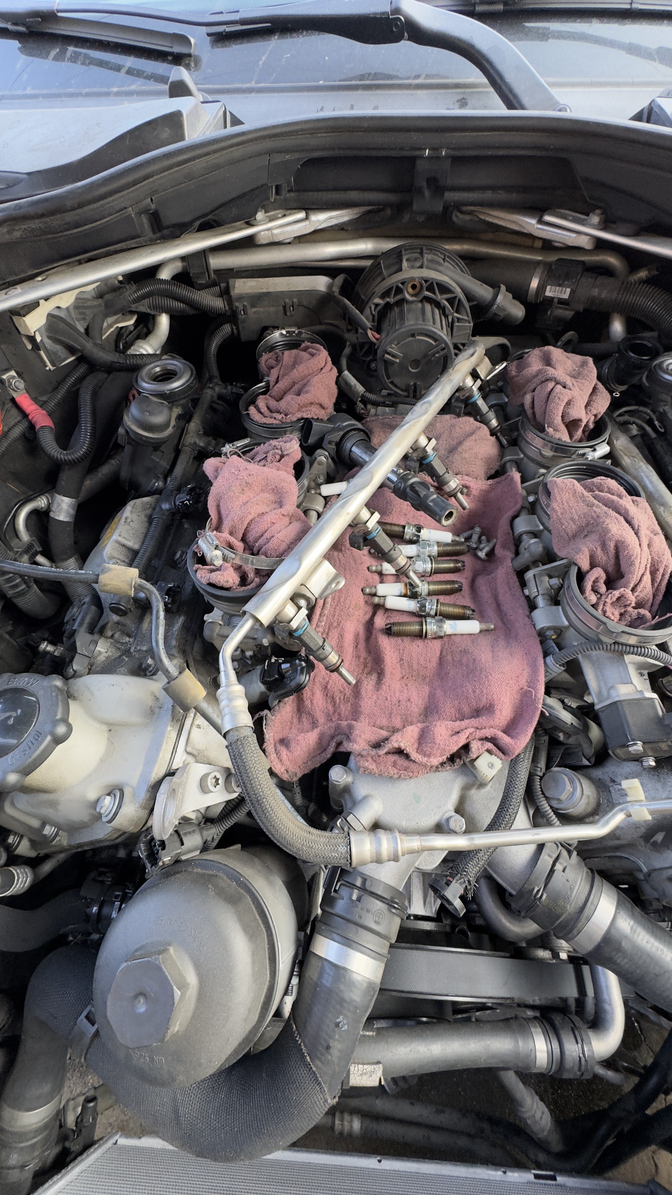

OMG just found this thread, never knew injectors was a problem. Should I be worried. 2011 with 130k, just bought it 6 months ago, been taking care of mintenance slowly, today I replaced my bed sending unit and now the car won’t start, it cranked but won’t start. But I kept clearing the random misfiring codes and kept trying to start it. The few times it ran, it ran rough, smelled and smoked. I think I pretty much damaged my engine, trying to start it 😭. I will check the cylinders tomorrow.

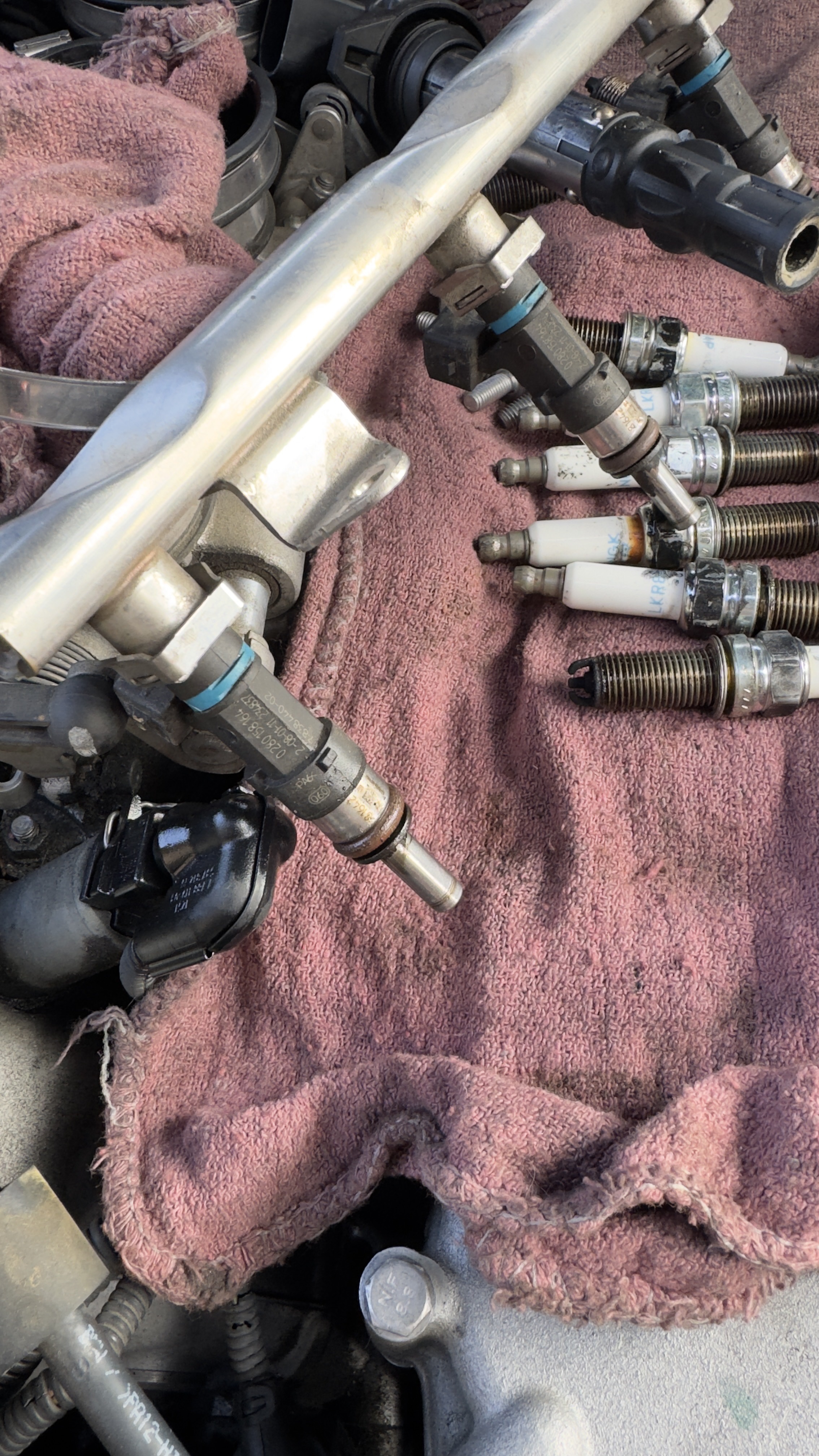

Pull the Injectors and #1 was leaking, hopefully the engine is still good.

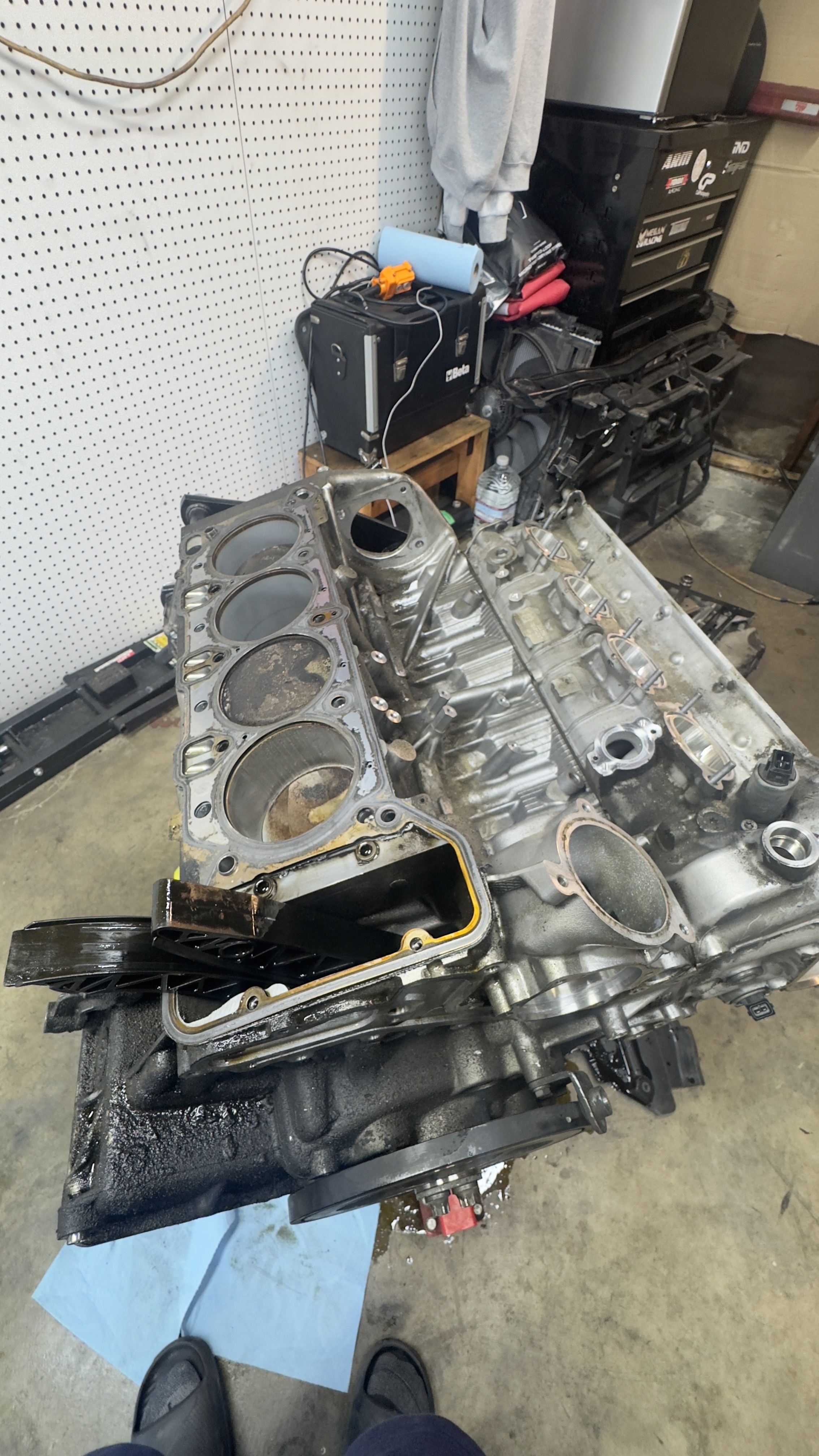

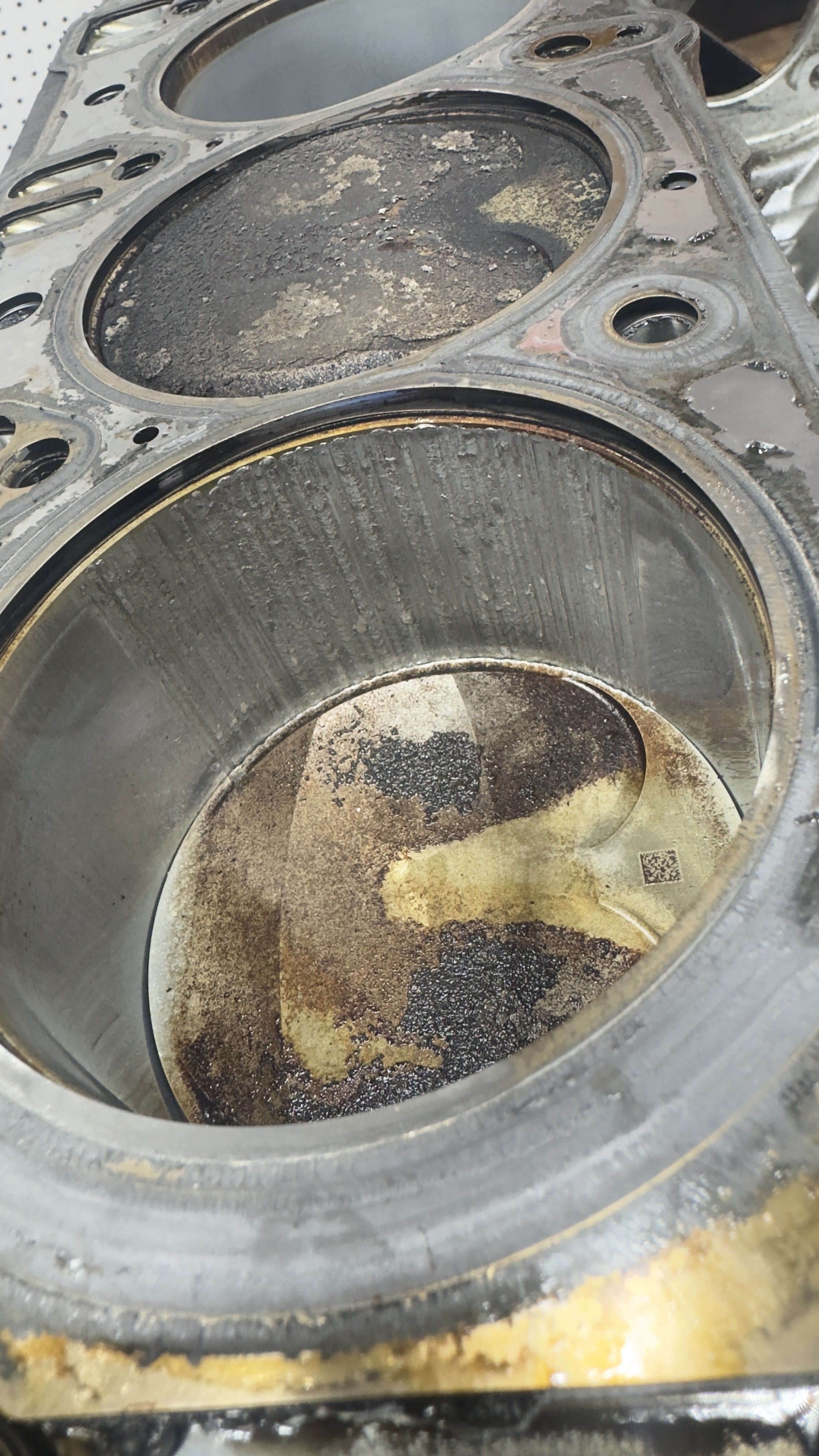

My engine is done, me trying to restart it killed it. What are my options for the block? Thanks in advance.
I'm sorry mate. Made that mistake too. You'll turn around.
Maybe you can re-hone it if the scores are fine enough, but the cost of disassemble is high. If you can find a used engine (check cylinder walls and crank rod journals), I think it will be financially wiser.

Took my engine apart and this is the damage.
