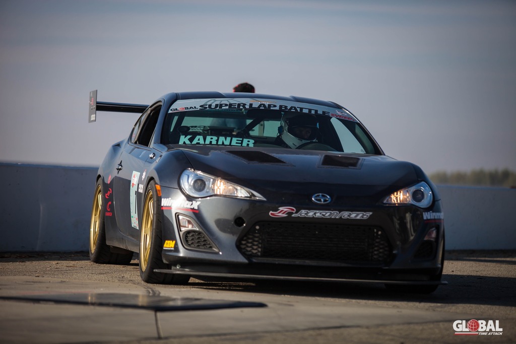

Believe it or not, I am actually here because my search led me here, not because Im trying to build a BMW.
Im not married to the brand in any way.
I am looking at any and all possibilities to:
A) find a light weight platform
B) make a decent amount of power
C) fit a 11-12” tire/wheel
Ideally, the power would come from the same brand as the chassis, but thats not absolutely required.
Ideally that chassis would have a decent amount of aftermarket support and be easy to acquire.
Thee engine should be able to make somewhere between 550-700 hp and do it with relative ease.
Those are my goals and it is very possible that I will not reach that, but I would like to try.
If it doesnt happen, or will only happen with huge reluctance and headaches, I will ditch the idea entirely.
I would like to be somewhere near 2:10 at COTA on slicks and 2:15ish on R comps....
If it doesnt work out, then I will buy a used radical and do some development work on that chassis (which I have some ideas for).
This was my last time attack car:

What is your weight goal exactly again? I still think a 135, with an N54 and a widebody kit can tick most of your goals - except maybe the weight goal, depending what it is.
Otherwise I think an E36 with an LS, 2JZ, built-turbo M50/52 maybe or newer BMW engine (S55, S63) might work well. The same can be put into an E46 and be light, but not quite as light as an E36. The E36/46 can get you down to the weight goal you have and the power goal. To fit the wide wheel/tire setup you'd need a widebody on both.

Like the 86 platform. I think it’s a fantastic car for new folks to learn on. Enough power to teach momentum without super severe consequences if you biff.
I imagine yours had a turbo or three and was fast AF.

The 86 is also plagued with a huge design flaw...
The back of the engine is 10” forward of the firewall!
Why??
Seriously, whoever dipshit thought that was a good idea should be shot!
My car was pretty quick, but not as quick as it ‘should’ have been.
I did all the development work for Jackson Racing and we used a Rotrex supercharger for that project.
I used an exhaust wastgate on the intake piping and used the cruise control to select between maps.
It had a 9psi setting and a 13.5psi setting for use with Ethanol.
The headwork was so good that it took only 13.5 psi to make that power.
I am not 100% sure, but I believe it was the highest powered supercharged 86 in the world..
Im still not a fan of that engine and would only consider re doing that platform if I could do an engine swap and had some money thrown at the problem (by someone else).
Similar weight as the 46 and I believe the 46 is a better chassis.
