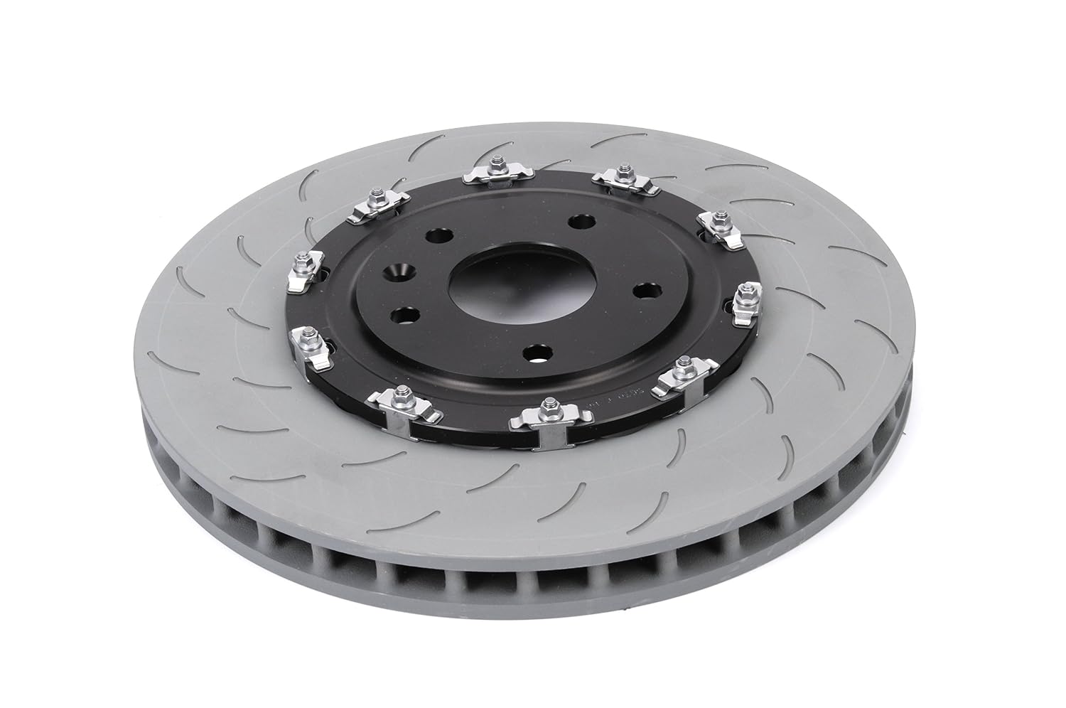

Does anyone have experience with replacing the rotor rings on floating/two-piece brakes? Specifically, sourcing the hardware?
My Corvette has these from the factory but oddly GM does not sell just the rotor ring -- you have to buy the whole assembly. I was able to buy the DBA 5000-series rings dirt-cheap during their spring cleaning sale but suddenly it looks like there is no way to replace the hardware short of dropping $100/wheel on Racing Brake's hardware:
https://www.racingbrake.com/McLaren-...re-p/ml1-e.htm
I am seeing a lot of conflicting info about reusing the hardware. DBA says you can, some aftermarket BBK companies say you should always replace, and GM doesn't even have any guidance since they don't sell it separately. Even on the Corvette and Camaro forums there is disagreement. I can't tell if these are torque-to-yield bolts. My fear is getting it to the shop, having them disassemble everything, and saying "oh do you have replacement hardware? these bolts are all stretched/we broke some." Part of me thinks I should just dig into the McMaster-Carr catalog and find the equivalent item rather than paying some absurd 500% mark-up on RB's bolts.
Here's what one Camaro SS 1LE guy did (same brakes as me):
https://www.camaro6.com/forums/showthread.php?t=492428
Any ideas here?

I buy replacement rings from https://www.zeckhausen.com.
The rings usually come with the fastening hardware.

Yes, I buy all my stuff from Dave. I couldn't pass up buying the rings directly from DBA because they were basically half-price. Oddly, there was no hardware in any of the boxes. I will need to call DBA on Monday and ask them to send it out.

here is my take on hardware, but these words also come with this disclaimer- i'm not an expert and this is my theory.
after swapping my front rotors, once, i found that the bobbins and the springs clips weren't in bad shape. the bolts and nuts weren't in bad shape, either, but they get embedded with brake dust while being exposed to very high heat... they sort of develop a film on them- almost like when you don't wash your car for a long time and it now needs to be clayed. the bolt and nut surfaces develop a roughness.
since they require a specific torque spec, if you were to re-use them, they may now have different torque tolerances. you wouldn't want one bolt to be significantly tighter than the other and have the ring not expand correctly as it heats up.
so after doing it once, i had my "ah hah!" moment; the nuts and bolts get crusty after a little while.
i suppose you've seen the thread on the guy using a racing brake setup and getting all kinds of jacked up hardware issues and a failure?

Appreciate the info. The bolts should be relatively easy to find.
Thanks for sharing that thread, pretty friggin crazy! RB did reply on their site that he basically did not have the correct part for his application:
http://forums.racingbrake.com/showthread.php?t=1482

another thought on your hardware.... you can probably re-use those bobbins. if you're able to check the thread and length of your bolts, you might be able to get away with the essex hardware kit. might be a stretch...
https://www.essexparts.com/10bolt-disc-hardware-kit
