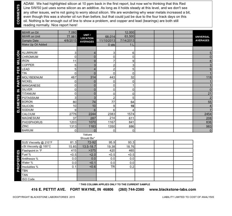

Oils used are (most recent first) Redline 5w50, redline 10w60, tws
My recent analysis results. This oil had 4 hard track days (7-8 hours on track total), summer, and winter driving. In addition, a stay at the body shop in the middle of winter where they probably cold started the car multiple times to move it around. Ran m1 0w40 for winter prior to swapping to 5w50, I'm guessing this is partially the source of the increased iron as well as the viscosity drop. This report definitely shows that this motor is being tracked, but otherwise, I'm not too concerned.
The increase in copper is a bit strange - from all of the reports I've looked at, it doesn't seem to increase proportionally with lead. Being only 2 ppm higher than before, it could be from any number of sources, including contamination of the sample.

Originally Posted by apecush
Attachment 1209721
What was your reasoning for putting in RL 5w-50?
Just curious.
I happen to be a believer in RL products
Just curious.
Due to my climate, I wanted something that was a bit thinner at startup, yet could still handle track abuse. Redline's combination of elevated zddp, decent hths viscosity, and ester base are why I use it.
Do you use Redline 5W50 all year round? I know this sounds stupid, but any noticable difference compared to TWS or M1 or whichever other oil you've used? Just want to know more because it seems like a very good alternative oil i can use during the summer months!
I never knew there was a 5W50 available for Redline (not a redline user at all, but have never heard anything bad at all either about the brand and quality), seems like a very good choice for those who can't decide whether or not to go with TWS 10W60 or M1 0W40.
I use it year round, though I really only drive it once a week in winter and rarely ever when temperatures drop below -20C. The car seems to start easier at low temperatures compared to tws, but harder than m1 0w40 (ran it once in the winter only and not at the track) At the track, I did not notice a difference between redline and tws.
