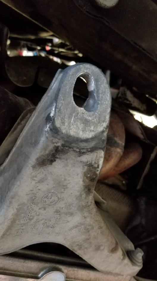

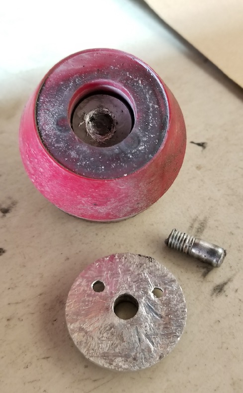

Let's file this one under: "Note To Self: Check Engine Mounts Frequently"
I forgot to mention another tech issue that was discovered when I had my rod bearings done. In June of 2015, when the cage was installed in the car, I had Vorshlag engine mounts installed. During the rod bearing job, EAS reported back that both engine mounts were broken. Both bolts had snapped. And I guess it had been like that long enough that one of the engine mount brackets was in bad shape. Aren't these pictures lovely? Blah.....
I contacted Vorshlag. They were helpful. They quickly shipped out two new bolts. But EAS said there was going to be a fair amount of labor involved in getting the old broken bolts out of the engine mounts.
I chatted with Steve at EAS about what we should do. The engine mount bracket simply had to be replaced. It was messed up. They were able to change that out pretty quickly. Great. One problem done.
Next question: what do we do about the engine mounts? Do we fix the Vorshlags and stick them back in? Or do something else? The main thing to consider here is that the supercharged engine puts out a lot of power. Would the Vorshlags simply snap again? It's hard to do anything to prevent the bolt snapping. And it looks like they had been snapped for quite awhile. I remember that when the Vorshlags were installed in 2015, they were replacing OEM mounts that were torn. But at least the bolts didn't snap. We debated about what to do---go back to OEM mounts since they are more flexible and will probably hold on or stick with the Vorshlags. I wasn't concerned that the OEM piece wasn't a "performance" part; I just wanted to put something in that would hold.
I decided to go back to OEM mounts. I figured they had survived longer than the Vorshlags. And when they failed, the rubber was tearing but they were still somewhat intact. At least the bolts were able to still hold things together. When both Vorshlag bolts snapped, what the hell was holding the system together? Magic fairy dust? Steve said he was surprised the car had been running as well as it was......And don't forget, I was just out at Auto Club Speedway on June 3 and 11, right before the rod bearing job. The Oval at ACS is the fastest section of track pavement you can find in California. I know of no other track in CA that achieves higher speeds than on that Oval.......yay.
So, I have OEM engine mounts back in for now. And I guess the lesson here is that we need to keep a MUCH closer eye on them from now on. And of course, I would suggest that anyone tracking their M3 should also keep an eye on the engine mounts, regardless of how much power the engine has.

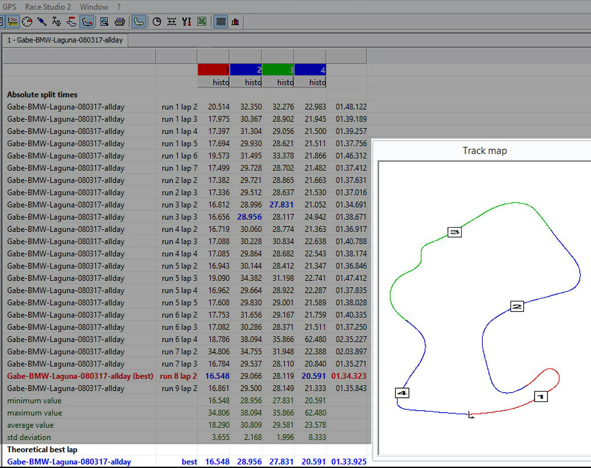

My recent day at Laguna Seca was a nice day. I have a few minor things to share.
-I always scour through the AIM data after a track day looking for interesting tidbits. One of them was that for the first time, the AIM showed my car pulling over 2G's in a turn. The AIM reported 2.11 G's in Turn 9. There were several other laps near 2G in the same spot (ie. 1.97), but this was definitely a first for me anywhere from what I can tell. I looked back through my track days at other tracks where I set personal bests. I couldn't find any other instance of 2G's. And interestingly, it happened right at the end of the day. I was getting more comfortable and pushing harder. Anyway, I think 2G's in this car at this weight is pretty cool.

- I was going through my 4 Laguna Seca sectors in the AIM software, and it turns out, my virtual best was a 1:33.92. Dang, I've driven the pieces of a 1:33! Gee....I only need to wait another year before I go back!
I tried to carefully make the sectors at this track and I think they work pretty well. All the sector changes occur on straights. (I put the Map on the pic so you can see where the sectors are.)
