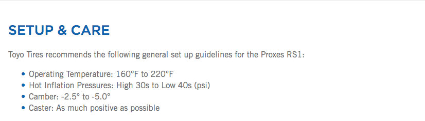

Anyone know much about the Proxes RS1 slick? It looks like a potential Hoosier R7 competitor. I found only 1 review, but I also found the specs interesting because of the rayon carcass choice (better thermal stability under load) and the steel reinforced sidewall architecture (better lateral stability, yaw damping and steering response).
https://www.toyotires.com/product/proxes-rs1/.
https://trackdaytire.com/product/toyo-proxes-rs1/
https://www.lsxmag.com/news/upping-g...e-tire-lineup/
I hadn't seen those Toyo slicks.... too bad they don't come in more sizes. Has anyone tried these?
