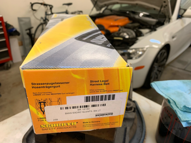

Like this kit?
I bought this before my first track day, but then was talked out of using it (because no roll bar), so I haven't tried it yet.
It wasn't really a giant negative on the first day, but by my third track day, keeping myself secure in the seat started to become a thing.
And on the less than perfect roads around Lake Berryessa, moving around in the seat is REALLY an issue.

Yes, this is the right kit.
Please ignore whatever dumbasses tell you not to use it. Refer them to what I posted earlier from Schroth.
A long time ago when I was a student I had an instructor get out of my car yelling about not wanting to use four points on the OEM seats. I calmly went with this crazy person to the chief instructor and tech chair and the matter was cleared up quickly.
The world is full of preconceived notions which are incorrect. In many aspects of our lives we have to make do with other morons because it isn't black or white, but in some cases there is clear technical guidance of which option is better like in this one.
Davisca4552241.50

High Plains Raceway:
4 point harnesses will not be allowed. If an aftermarket harness is installed there must be a minimum of 5 points including an anti-submarine belt. Schroth 4 point belts will not be allowed.
That's a good tip!
Thunderhill is the closest track for me, and it looks like the HPDE groups that I've used are ok with the Schroth 4 points as long as they are the ASM version.
So I went ahead and installed it this afternoon.
It's pretty easy to remove if/when the rules ever change.
