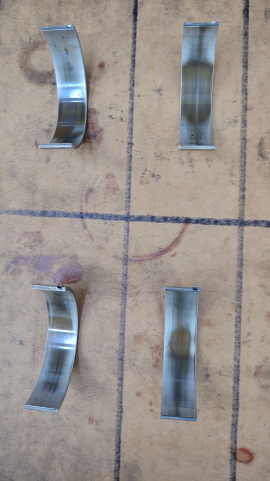

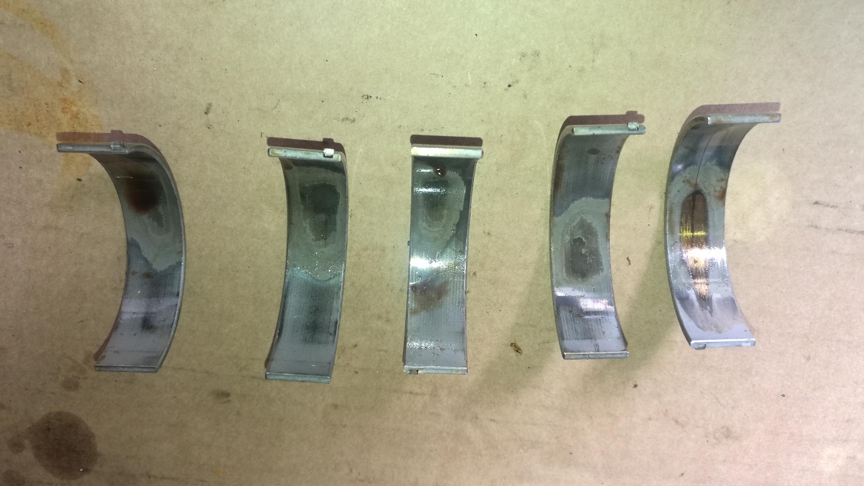

So I purchased my 2010 E92 M3 DCT Dakar Edition in 2015. It was 5 years old and had 70k kms (43k miles).
In Oct 2016 @ 90k kms (56k miles) I did the first round of rod bearing replacement. The copper RBs that come out were pretty worn, and I was expecting this cos I knew the owner didn't really take care of the car.
This was what the RBs looked like at 90k kms, copper showing on 3 bearings (I didn't manage to get pics of all the bearings). I replaced them with original BMW rod bearings and bolts.

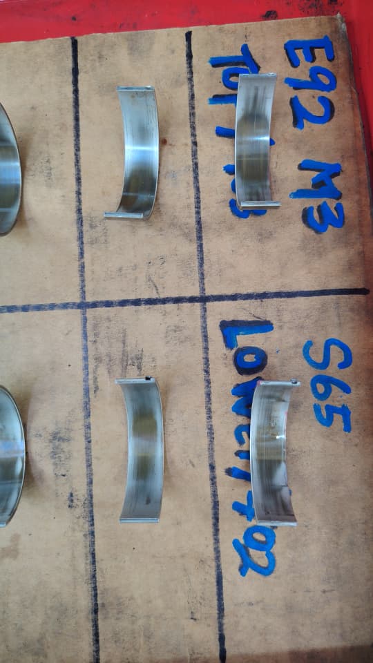

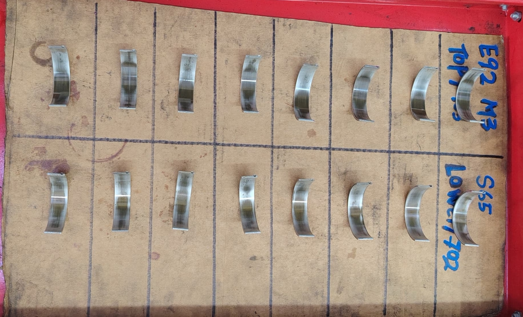

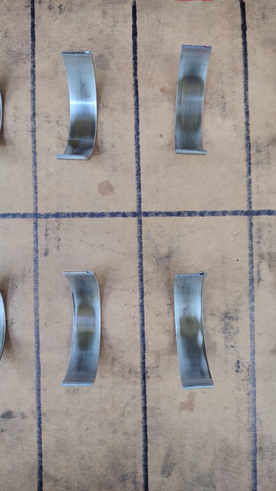

Now fast forward to April 2026, I decided to change the rod bearings again at 170k kms (105k miles).
These past 10 years I have followed a strict routine:
- Oil changes every 10k kms (6k miles) or 1-year whichever came first
- Using only 10W-60, mainly Castrol Edge for the first 8 years and Ravenol for the last 2 years.
- Warm up 1 minute from cold start, or 15-20 seconds if warm start.
- Maintain below 3k rpms until 85C (185F) oil temps.
Now 10 years and 80km kms later, this is what the rod bearings look like:
Size:  49.8 KBName:  Closeup_2.jpeg
Size:  48.8 KBName:  Closeup_4.jpeg
The mech said they look good, could have lasted a while more.
I think it's safe to say that warming up the engine properly and letting the oil warm up before giving it high rpm goes a long way to protecting the rod bearings.
This round I will be installing ACL HX bearings with ARP2000 rod bolts. Will check back in after another 80k kms to see how the bearings hold up. Tho at the rate that I'm driving these days (about 2-3k kms per year) it might take another 40 years for this experiment to conclude. Lol.
Appreciate 9

Cheers Eric. And the 2nd round looks like LCI 702/703 shells, no?
Curious, what did you/your mech base the decision for ACL HX on? (I run them since 2018/45k km, but plan to go down on clearance maybe Mahle next time).
Thanks
