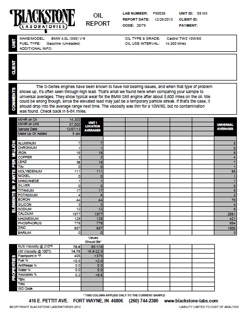

I would suggest that you read the whole thread and do a search. This topic has been discussed to no end!
GroundPilot,
This is a problem.
http://www.m3post.com/forums/attachm...1&d=1388098064
