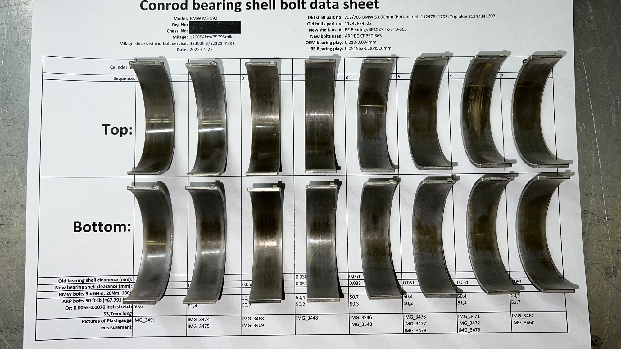

M3 E92 LCI with production date May 2010. 120854 km/75095 miles. The RB’s were replaced five years ago at 88471 km/54973 miles with 702/703 bearings and BMW bolts. I am now replacing them with BE and BE-ARP bolts. Old RB’s has only got 32383 km/20121 miles on them.
Nice post Nicke! Yeah looks to be some wear even after 3.2kkm only, maybe sign that crank/shells was on the tight end. Anyways great with new ones in place!

You mean 32k kms
Btw where do you see no5 clearance figures? They're obscured to me on that pic....
(No8's figures seem weird to me, been reversed??).
Attachment 2794876
Thanks for the good pics
And possibly the 1st photos of LCI bearings that have worn through to the copper that I've seen?? (no4 top).
I don't suppose you want to perform a simple little experiment on that shell? (and ideally 1 of the other top bearings).

Thanks Helmsman. Sorry for the bad pic. Here is a better one. The top shell for cylinder #7 is pretty worn down. Thankfully no scoring marks on the crank - it is silky smooth.
Also interesting with your plasti checking vs old shells, tad weird on cyl 5 but probably not more exact than so.

You mean 32k kms
And possibly the 1st photos of LCI bearings that have worn through to the copper?? (no4 top).
I guess that you mean cyl #7, top bearing (once again, sorry for the bad picture, a new one has been uploaded - see my previous post). Measured the play for the old bearings for cyl # 4 and 5. For cyl #5 I got 0,051mm for the old bearing and 0,038mm for the new BE Bearing... Wired. I'm going to remove it tonight and do a new measurement. Good thing that I choose reusable ARP-bolts...
