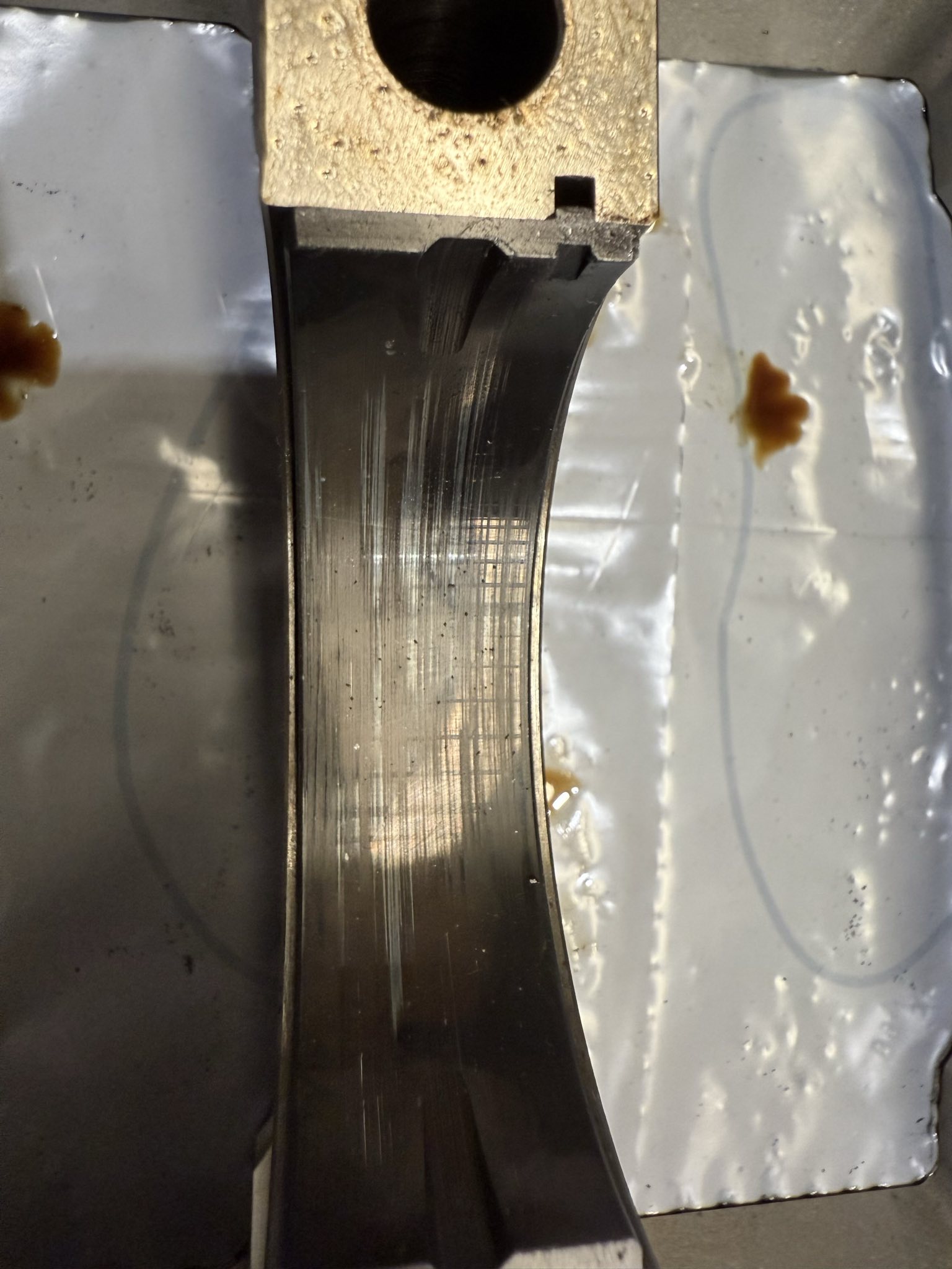

Attached are the pictures of the main bearings that have come out of the engine. They are purported to have travelled approximately 25,000 kms (15,000 miles)
Seems like a lot of scraping to my untrained eye. I post these to get the groups expert opinion.
Also they are Kings pMAX std bearings. It was suggested to purchase STDX replacements, so I have done this and that is what will (with current/present logic) be the ones going back in. With standard/stock internals, is this something that is common?
FWIW the oil being used will be Liqui Moli Racetek 10w60 w/Ceratec.
I would love some observations/suggestions/thoughts if possible please?

Can you post the upper bearings? More specifically the upper main #1?

I don't see any indication of failure, but have some thoughts.
-The brown/amber color of used engine oil will cause any metal content in the oil to appear as copper. If you were able to separate and rinse the metal debris in, say, a paper coffee filter, you'll probably find they're actually silver. If you do this and they are indeed bronze or copper then you might have a problem.
-There appears to be an excessive amount of debris embedment in the bearings and evidence that a lot of material went through those bearings causing light scoring. This is common for a lot of bearing replacements that were not done in a super-clean environment. It's why we state that mains must be done as a complete teardown in a clean environment. Otherwise there's just too much carbon, dirt, etc to manage, and it'll end up circulating through the engine and result in that kind of wear.
-Always replace the oil cooler after any kind of bearing failure or suspicion of such. You will never, ever, be able to remove all of the debris from a cooler. You just can't- no matter how much flushing you do. It sucks but you just gotta do it if you want a proper long term outcome. You can flush the hoses- those are ok to reuse.

Those mains actually don't look too bad at all.
