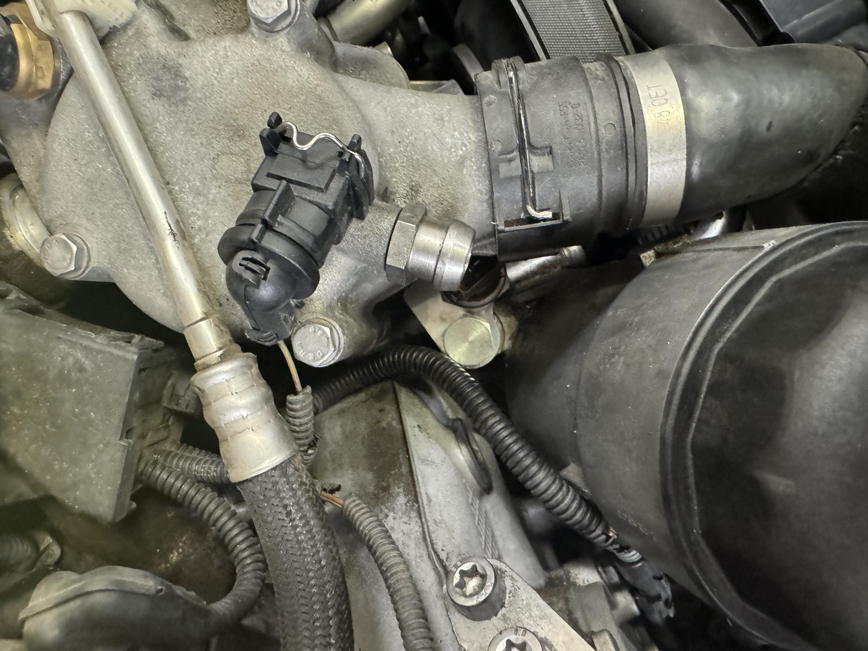

Oil pressure/temp sender oil distribution block for s65
I have an e92 m3 built as a competition time trial car and in progress of building another e92 m3 w2w car. I'm adding a combination oil pressure/temp sensor and would prefer to retain the dummy stock oil pressure switch. I'm struggling to find an oil distribution block that will fit the s65. Bimmerworld claims theirs will fit an s65 but I cannot figure out any way to install that block with room to connect the stock wiring hardness to the dummy switch without the water pump housing getting in the way. Reaching out to BW, they do not have direct experience installing it on an s65. Has anyone been able to fit the BW oil distribution switch successfully on an s65 while maintaining the dummy switch? Or has anyone found a different oil distribution block that will work? I also tried the rally road compact distribution block, but it is actually bigger than the BW one. The aktive autowerke one looks like it would certainly work but its sold out and excessively expensive. Also curious where folks decided to remote mount the sensor on an e90/e92?

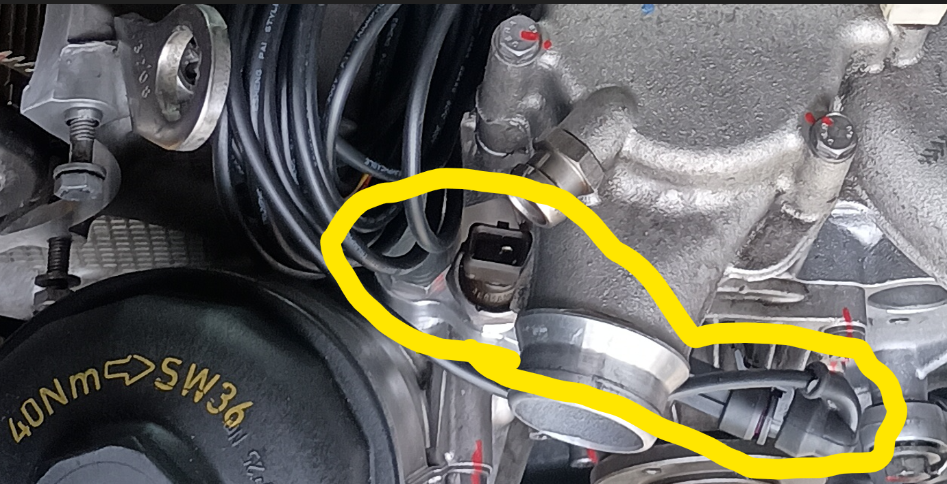

I have both the dummy switch and block on mine. You need to shave the harness plug down for the dummy switch to make it work.

former 240 s14 Is that the BW distribution block? hard to tell from the photos. and do you have any photos of how you shaved the connector? One of the issues I ran into is literally the angle of the dummy switch connector based on where it tightens and the direction the connector faces. for instance it looks like your connector ended up perpendicular to the water pump housing whereas mine ends up parallel to it, making the connector fit even tighter.
I just tried this adapter from rally road, which solves the dummy switch fitment easily, but creates the same angle problem for the 1/8npt port. without a banjo bolt, you are at the mercy of where the adapter block tightens for the angle of the 1/8npt port and for me it keeps lining up right against the OFH so no room to connect the remote line. https://rallyroad.net/products/oilfe...1b19d973&_ss=r
My thought is to try to find thicker crush washers to try and get the angle of the 1/8npt port to land where I can connect the hose.

Originally Posted by calicoupe View Post
former 240 s14 Is that the BW distribution block? hard to tell from the photos. and do you have any photos of how you shaved the connector? One of the issues I ran into is literally the angle of the dummy switch connector based on where it tightens and the direction the connector faces. for instance it looks like your connector ended up perpendicular to the water pump housing whereas mine ends up parallel to it, making the connector fit even tighter.https://rallyroad.net/products/oilfe...1b19d973&_ss=r
Hello.
1. I can confirm my piece is the BW unit.
2. I do not have any more pics zoomed in for you
3. The OEM dummy switch goes vertical on the block, the aftermarket pressure sensor should go horizontal.
4. The shaving of the sensor was on one of the shorter sides removing it. The plug still has enough to clip in.
Hope this helps!
Rubin
