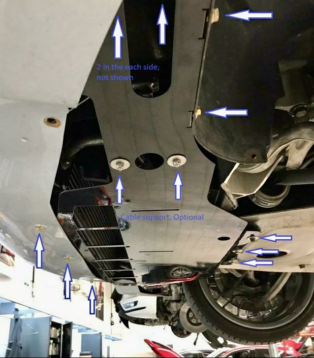

      07-27-2026, 12:12 PM   #7
BadgerPride
140
116
Drives: E92 328i; E39 540i; E92 M3
Join Date: Mar 2017
Location: CA
Just installed DO88 radiator and oil cooler 2 weeks ago. I must say I was VERY impressed by the fitment. I had Dremel ready to go but other than taking out a tab for the radiator support (per DO88 instruction) it went in .... uneventfully.
No leaks, welds look good (enough). No leaks. Also I am not a huge fan of the no drain plug design but oh well...
The only issue is since the DO88 oil cooler is a bit larger it interfered with my aluminum under-tray. Have to bend it a bit.
I am very happy with the upgrade... all because of a small inconvenient leak in one of my radiator hoses.

      07-27-2026, 11:58 PM   #9
BadgerPride
140
116
Join Date: Mar 2017
Location: CA
Originally Posted by BimmerRob08 View Post
What aluminum tray do you have that interfere with the oil cooler? I’m about to install the Turner Motorsport aluminum radiator tray assembly when I do this job and scrap the OEM crap tray that is all chewed up. What exactly interfered and how did you make adjustments?
I have MLT aluminum tray. So on those trays there is a row that extend upward about 1/2" in order to seal the OEM oil coolers to ensure proper airflow. Since the DO88 oil cooler is much larger it pushes everything downward more. That typically shouldn't be an issue since the front attachment point is the front bumper and plastic can flex. The issue I run into is since I have a CF front lip (a very shitty, poorly fitted one) it prevents bumper to flex. I had to bend the tray a bit to make it fit properly. Minor inconvenience.
For the turner tray since it is much thicker metal, I am not sure how much flex you can get. Hope that helps.

      07-29-2026, 11:41 AM   #13
Probably like 1/2" at max (maybe even less). It wasn't really off but since my bumper is fixed in position by the CF front lip which also probably flexed it upward a bit it was a bit hard for me to fit it in initially. But I think regardless it could work just need time to mess around with it.
MLT tray here too, 'early adapter' version [circa 2020].
Fortunately, no interference, workaround or trim was necessary even with two different CF lip types over time. Still fits well after multiple removals/reinstalls.
Perhaps MLT modified dim specs
ADD - intended to share MLT pic earlier
