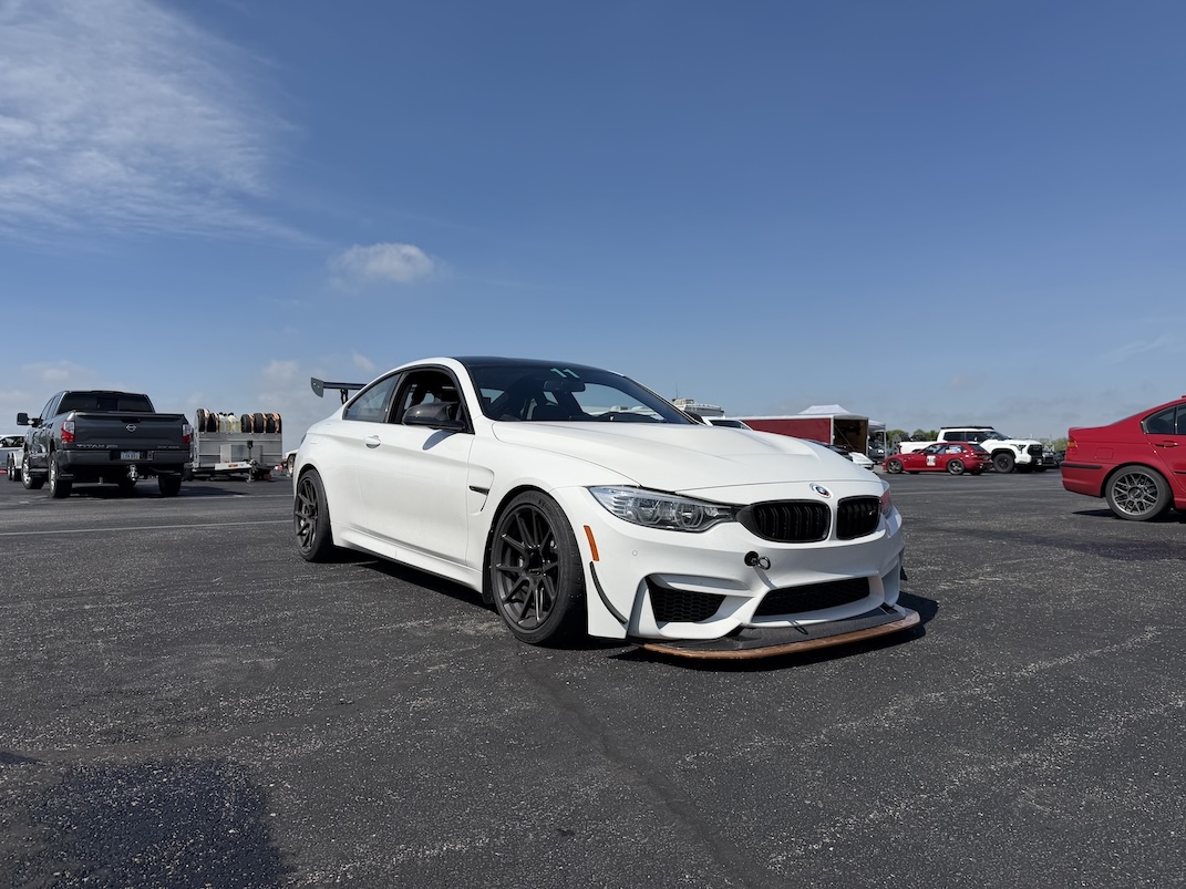

Snuck out in between the weather craziness in the Midwest to check out the new suspension setup. Oh my. Car felt good before but now the steering just feels telepathic. Car is a lot more neutral, turn in is instant, and having run the ista bleed procedure just before going I think I improved my brake life too (not panic bracking because of spongy petal == more intentional threshold braking and earlier release == less braking overall)
Only problem is I’m rubbing the tires. It’s one part fender (though that seems minor) and one part arch liner. Gotta decide if I should give up on the 18x11s and drop back down to 10.5 with a 275 tire.

offset are just bad on those 18x11 up front, just run a 8mm spacer instead of 15mm.
rear can be left alone but a 3mm or 5mm would be nice. assuming its 18x11 ET30 sq.
the 15 in the front is the minimum to clear the strut and spring perch. and that's with a 5" spring :/
and yeah, 18x11et30 square. i have 5mm spacers, was meaning to throw them on and never got around to it.
hm weird lol.
18x11 et44 with 25mm spacer clears fine.. not sure how you're bottled neck there.

hm weird lol.
That’s basically the same as et30 w 15mm spacer, isn’t it? That clears. Et30 w 8mm spacer is another 7mm inboard.
I suggest removing the inner fender liner and add maybe a smidge more negative camber, then reset the toe. Since you have coil overs there's also a ride height adjustment possibility.
I might shave that bit down to start. Don’t love the idea of it being completely gone.
The fender liner edge is poking to far forward. It should be tucked behind the fender lip. Remove the inner fender liner retaining nuts / screws and reset. See image.
Yeah I saw that. Just need to open it all up this weekend and see what’s going on.

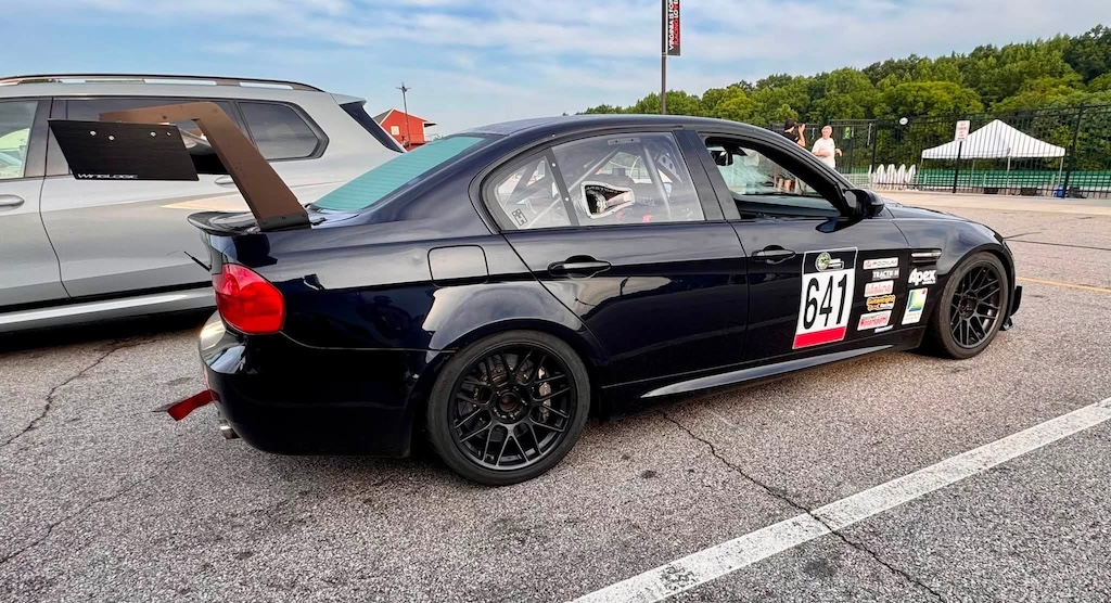

Attachment 3984427
aaaand that's all she wrote folks. after investing another ~10k in new suspension bits and getting to drive it on track once, i got an offer on it that made sense and decided to jump on it. the structural reason i wanted to sell it in the first place never went away -- I live in the middle of Chicago, and have no place for a trailer. The absolute best setup I could land on was storing the trailer ~15 minutes away, which still meant that after a full day at the track, i'd have to come home, unload the car right away, drive 15 minutes to drop off the trailer, then drive another 15 minutes back which all told added an hour at the end of the day.
so it's a little bittersweet, but the car went to a good home and it's awesome to see it actually raced (and know that I built a real mfing racecar!):
https://www.facebook.com/share/1CxNr...ibextid=wwXIfr
https://www.youtube.com/live/gSnY1BZLjvY
I haven't been to VIR so don't know what's good over there, but new owner said they ran a 2:08 on RS4s which seems fast based on our collection on the site.
I don't know that I'll stay away for long though, I still love the platform. In the meantime, I'm burning cash with a drive-to-the-track setup in my GTS so I'll see y'all out there!
Attachment 3984426
you can totally just take my car for 20k and have a arrive and drive set up
bitter sweet, but if it makes sense it makes sense. no arguing with wasting an hour to unload a car from me either. def a pain point.
