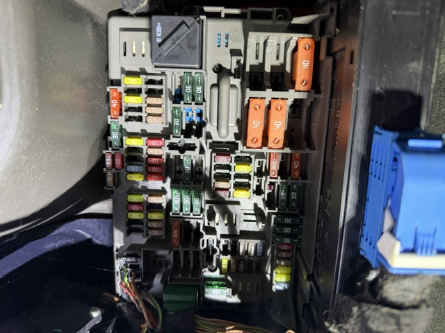

Hey everyone, Still in the process of trying to save this e90 I picked up on the cheap.. I will say this car is substantially more challenging than my e46. Still fighting some codes I think I will have to go under the valve covers for (strange vanos max position code) Which according to ISTA the last step to fix that code if camshafts are timed correctly is replace DME. Which honestly has me wondering if all my fault issues are electronic.
I am finding out that I bought myself someone elses electrical nightmare. I thought it was just an old battery not holing charge at first, but that was not the case at all. Now in doing some more digging I have found MULTIPLE fuses missing, and what looks like someone cut off, then but connected on a new connector for the blower motor. I attached some pics..
Right now I am at .98amp draw (using ANCOR amp clamp). I have tested alternator diode already, and in the process of workign my way through the fuse box one at a time (also restoring it to have all of the fuses it should have from factory)
I did notice a drop down to .46 when I removed the large square black relay on the right side of the fuse box (it was also pretty damn warm). So I plugged that relay back in, then amp draw jumped up to 6 or so (same as when opening the door) and it settled back to .98 (in that general area). So I then unplugged the group of wires in the top left.. Same exact drop as when I removed the relay.. Continue on- fuse 36 causes exact same drop, and then jump and re settle to .98. I tried removing all of those at the same time- nothing different, still at .46..

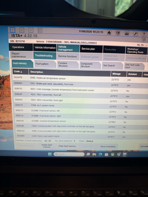

This ISTA screen shot is after clearing codes to get rid of the engine codes (theres also a weird throttle actuator line code- not the normal actuator codes). I did not start the car after clearing and before taking this read out. This shot is before restoring the fuse box to factory according to the card in the glovebox. There is a code in here for drivers seat no communication but that is solely because i had taken that fuse out and put it back into the pass side not knowing. Let me know your thoughts..

There is also this read out from before I cleared it, most of that is just from stuff being unplugged. But I wanted to post this anyways as well

Okay, my buddy does marine electronics so honestly he might have access to a flir camera. But the large black relay on the right side of the fuse panel was noticeably warm to the touch the other day when I was investigating, the draw also dropped almost in half when removing this. I have been letting the car settle after opening or closing a door.
Right now I am going to put the whole fuse box back together the way the factory intended.. Hopefully to get some what of a better base line. I might even go take the car for a test drive just for the hell of it to see how it acts..

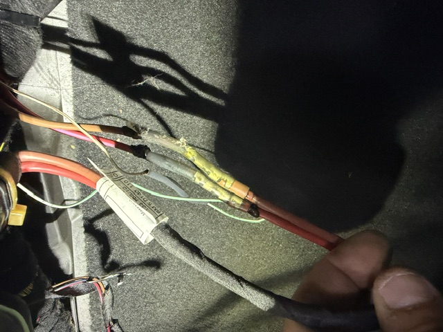

I don't have much input on all the other things, but there is a recall on these cars to get the blower motor wiring replaced. This may be a factory recall being completed.
Great point. I question if that was the correct way to do it. Maybe it is--it just looks janky which I think the OP is/was concerned with.
This does make me feel a little better.. It does look a little sketchy but is properly done and sealed very well. So that would make sense.
Now here is the interesting part that doesnt make total sense- but kind of does. The fuse box and pulling them one at a time was starting to piss me off to be honest. And once I realized half the fuses in there were the wrong amperages, I just decided to gut the entire JBE of every fuse and relay. I then went directly off the card in the glovebox (thankfully it was there still) and reinstalled them (probably should have changed them all for new in retrospect) but filled in with new ones, all in the correct amps.
I now have 0.0-0.1 draw.. Will this last? Beats me but I am going to button up the underside and take this thing for its first test drive since I bought it in the beginning of May for $15k. Did the clutch, flywheel, driveshaft, guibo, needed a new rear end as well.. So wish me luck..

im pretty sure its its the andream. that photo you took of the red wires that have been tampered with is if I'm not mistaken the blower wire/motor recall.
