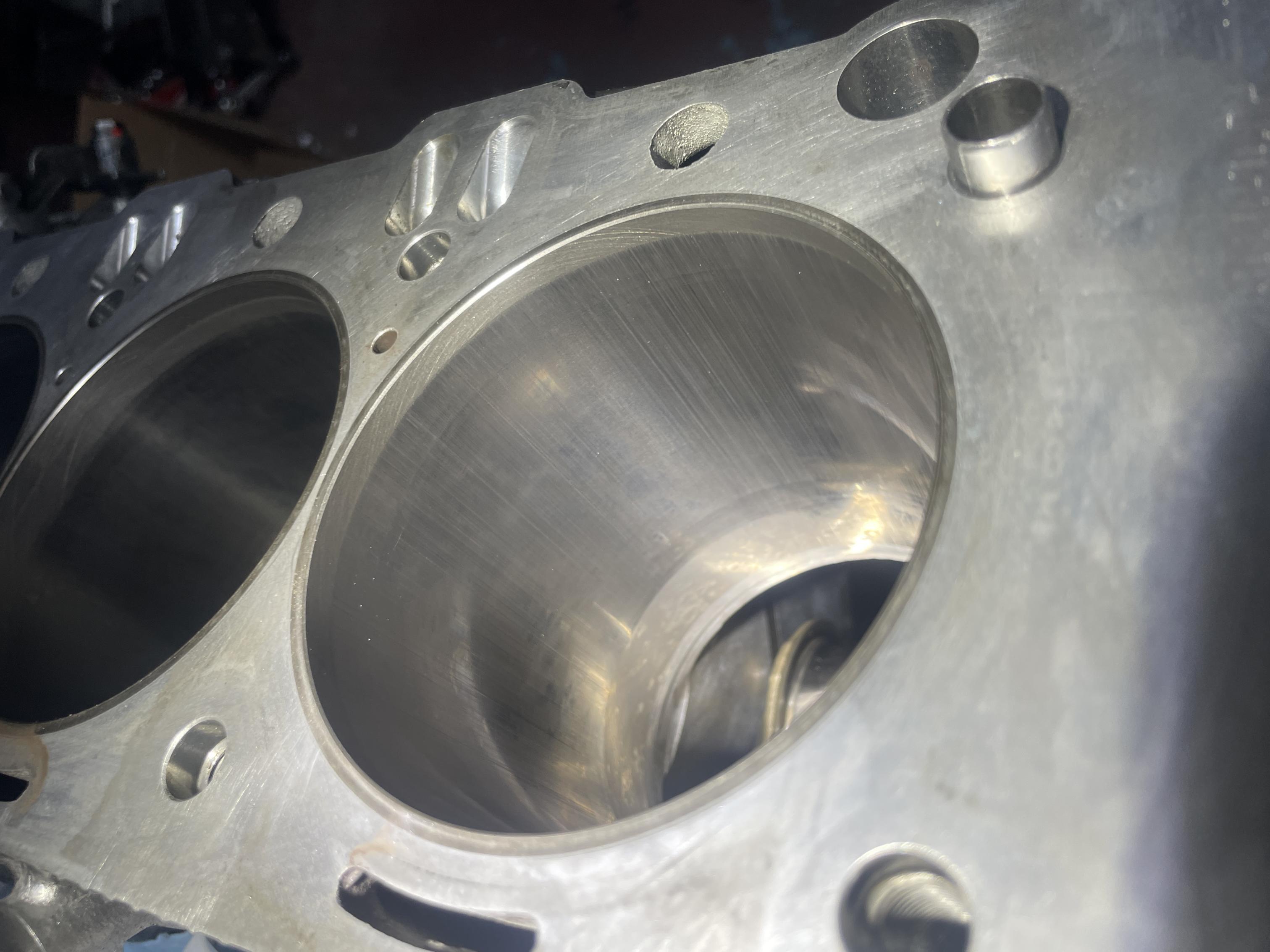

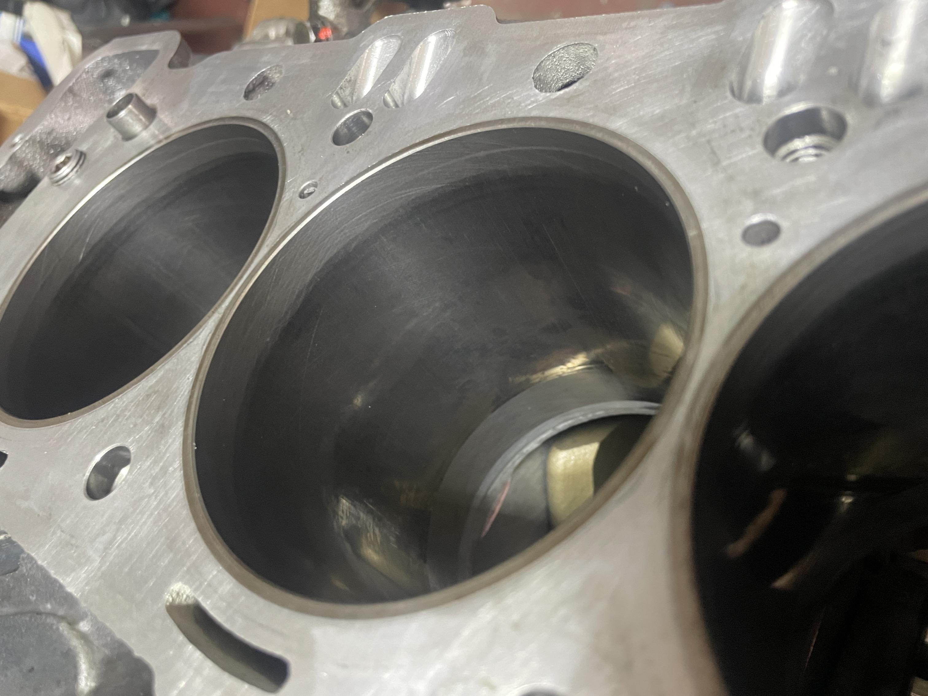

Hey all,
I am looking for some second opinions on the condition of these cylinder bores, if it looks good for pistons to go back in, and if not options for fixing it (sleeves? Machine shop?).
Car is a 2009 e92 M3 DCT with a ESS supercharger.
Some context below:
Photos are after an AN-30 and felt tip "hone".
Engine has been previously built before (CP pistons, arrow rods), but had a horrible oil burning problem through ring blow-by. Looking at the cross hatch at the top and bottom of the bores I suspect that whoever built the engine previously honed them incorrectly. I do not know how many miles are on the rebuild, car was purchased (for a deal) in this condition.
Bores are straight and measure 92mm within +/- 0.02mm measured via dial indicator bore gauge.
None of the visible lines catch my fingernail or can be felt otherwise.
The CP pistons also measured 91.89mm in diameter as opposed to oem 91.99. The Mahle replacements I have are 91.97mm, but they are the less ductile aluminum compared to the CP.
This is my first post on this forum so I appreciate any help and feel free to ask me any questions, thanks!

Check the #1 crank main journal as well as the bores. More than a few of us have found cracks there leading all the way up to the oil gallery on used “good” blocks.
There should be NO crosshatch in the bores of these engines. None.

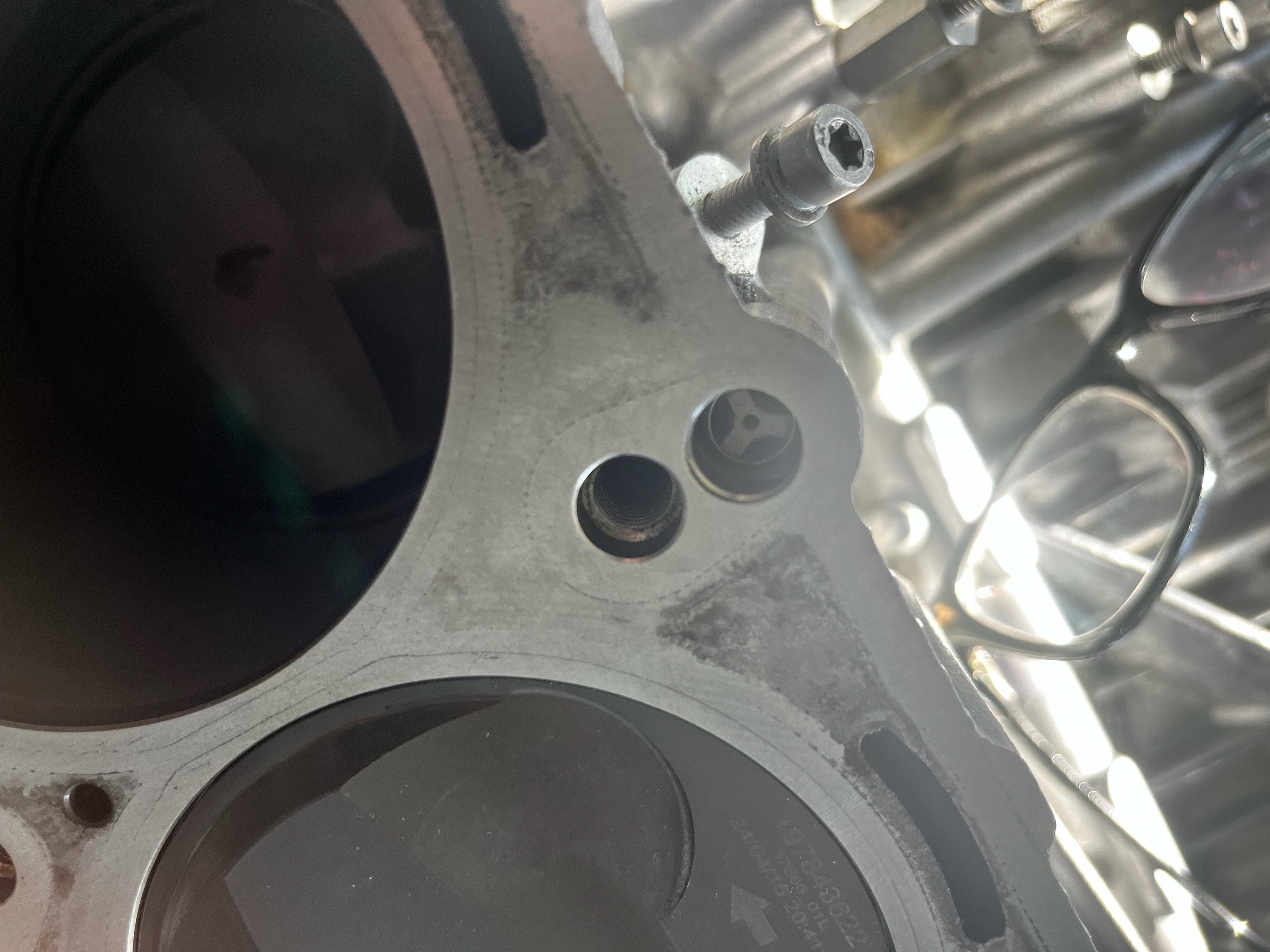

Originally Posted by Chrisyphus View Post
Is this block not sleeved?
From what I can tell it isn't. Photo attached of what sleeves on an S65 typically look like. Unless some generic sleeves were installed or something. The build sheet I received from the original engine build showed alusil coated pistons were speced. My guess is that the machine shop that refreshed the block knew nothing about alusil and honed the bores incorrectly (hence the cross hatch patterns being visible) and that's what led to the oil burning. I have ordered a good used block and will build off of that since it was cheaper than getting this one sleeved.

The CP piston diameter makes sense when you account for thermal expansion.
Did you measure the piston exactly as CP specifies, which is 0.500" up from the bottom of the skirt and 90° to the wrist pin? That's the measurement point used to determine piston-to-wall clearance.
Based on the wear pattern and condition of the bores, you'll likely want to have the cylinders properly honed to expose fresh silicon in the Alusil surface. If the bores are out of specification or cleanup requires additional material removal, you may end up needing to machine the block to 93.00 mm and move to an oversized piston set.
To address your photos, from what I've learned over the years through my own build and from knowledgeable people who specialize in these engines, a properly prepared Alusil bore should not resemble a freshly honed cylinder.
After the silicon exposure process, the bore typically has a semi-matte or satin appearance rather than a sharp, highly visible crosshatch. The critical factors are proper silicon exposure and surface preparation, which are best verified through profilometer readings rather than visual inspection alone.
personally in my opinion... I would just sleeve the block if you plan on keeping the supercharger.

That block looks 100% sleeved. You can see the metal difference at top and bottom of bore. Also, that top looks way too clean indicating the top of the block was decked.
Who ever did the sleeving doesn't look like the VAC motorsport sleeves--which are flanged sleeves. These pictures show different. This block looks similar to say something like a GM LS aluminum block and the stock sleeving. Look here:
As for the condition of your bores, those bores look like the piston scuffed. Maybe the stock pistons were used. And this makes sense as clearances are different between the aluminum bore vs steel-sleeved. Stock pistons are 91.99mm nominal. You need more piston to wall clearance if using sleeved as the difference in bore of aluminum vs steeved. That's why on the VAC website they have you specify the pistons to be used by stock aluminum bore vs sleeved.

OP. I guess I'm confused. What pistons did you use in this block? The CP pistons or the Mahle replacements?
Hey Rocketyman, the original engine that I disassembled was already built by the previous owner using CP pistons. on the receipt he had it showed 92mm bore and alusil specified. I agree it kind of looks sleeved, it may also be discoloration from where the compression rings of the head gasket were sitting. I just find it odd that all the s65 sleeved engines I've seen run flanged sleeves, due to how close the bores are to each other that this one wouldn't run that. Unless there's some other design I am not aware of.
If it is sleeved, and he was running alusil pistons, that would also explain why the rings never properly set. I also agree with the piston to wall clearance not being the issue after seeing that the material the CP pistons are made out of is the more ductile aluminum that expands more.
Thanks for the input, after what people are saying and what I have seen, I agree that in order to fix this block sleeving or boring it out would be required.

Toss a magnet in that thing and let’s put the theory crafting to rest lol.
You don’t necessarily need a flanged sleeve, and an flangeless sleeve is going to be cheaper. It’s just going to have worse thermal expansion characteristics.
The difference in color is VERY out of character for any S65 I’ve ever seen.
If that’s the case, as mentioned above, and a ring set designed for alusil was used, there’s your failure mode. Good to know.
Re:sleeved vs. reconditioned- hard disagree that sleeving is the only option. We have multiple 700whp+ supercharged S62s running without sleeves, and they’ve all lived long happy lives. They have the same bore spacing as the S65 and they’re 94mm cylinders BEFORE we bore and recondition them (.008” IIRC). It’s a non-issue unless you’re trying to get into horsepower numbers far above the average SC S65.
It is, however, the only safe option if you choose to work with a shop that doesn’t specialize in AluSil reconditioning.
Now, having covered all of that, if you want an economical solution to getting this car back on the road that takes all of the guesswork out of the equation, we offer a short block package for $10,000. It’s a fully forged rotating assembly including our custom manufactured forged and fully machined rods, MAHLE power pack pistons in either 12.3:1 or 10.2:1 compression ratio. Fully machined, blueprinted, and built in-house by us. This short block, properly maintained (good oil change interval and standard warm-up considerations), should outlive your original motor. MAHLE’s 4032 pistons are as long lived as the OEM pistons, and with our improved bearing clearances all around, the full packages is better than OE, not just in performance, but also in reliability.
We’re also working with MAHLE to have them produce custom pistons for us in the same alloy that the S58’s OEM pistons are made from. Not an inexpensive endeavor, but worthwhile as M142 offers nearly the same strength as 2618, while having a CTE more similar to a cast piston than even 4032. But that’s going to take some time to come to fruition.
My final point…. Brother you’re in Raleigh. When I first started working at Partee Racing, I moved to Chapel Hill and commuted up to Danville every day.. drop by and check us out some time if you’re at all interested. We are open to the public and have dozens of people come by every month who will almost certainly never be customers, but we still show them around all the same, because that’s not the point.. hanging out with other enthusiasts is.

Your block definitely looks sleeved! Notice the difference of the 2 metals on yours vs original.

Your block definitely looks sleeved! Notice the difference of the 2 metals.
I agree after looking at it more. Just very odd they installed generic sleeves (unless there's a brand im unaware of that looks like that) and then ran the wrong pistons with it. But then again it was burning about 4 quarts of oil every 50-100 miles so clearly they did something wrong lol
